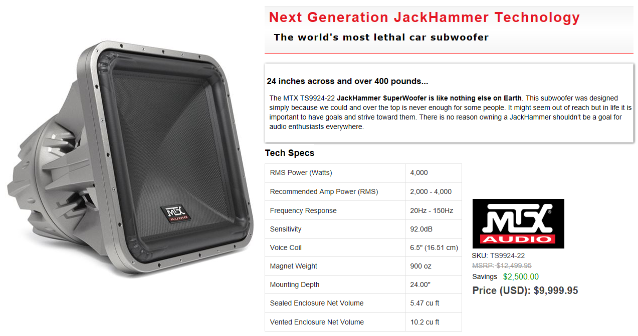

Here is a large sub-woofer for a car. It is so heavy that it takes a few guys to carry it. It is rated for 4000W and can break all the car's windows and the driver's hearing.
