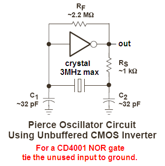

how can I make a real oscillator?
how can I bias the two amps correctly?
I really appreciate your help
Look at Cmos Crystal Oscillator in Google. There are thousands of circuits. The designer of the circuit found by your teacher doesn't know anything about electronics. Maybe your teacher doesn't know anything about electronics.
Your NXP/Philips document does not show its crystal oscillator circuit.
