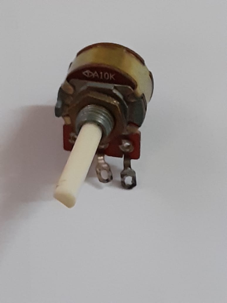

I had formerly asked for help with an fm radio receiver schematic and though I asked real dumb questions, no one scolded me for that so I am back with another couple of questions. First is, I have got a volume control pot with five pins and I don't know how to wire it up. (Okay I don't even know how to wire up a 3 pin volume pot). Could someone kindly help me with that please? I am still pottering about with the old fm radio receiver circuit as before, I'll post the schematic so you can have a look at it. I would be so grateful if someone could tell me how I could wire the 5 pin pot to the schematic.

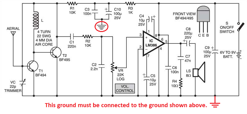

I am going to try and attach pics of the schematic and the 5 pin pot in the hope that someone will kindly help me. Please be gentle. I am an old fart trying to learn hehe. Also, if you could explain stuff in simple terms and examples, I would be so grateful.

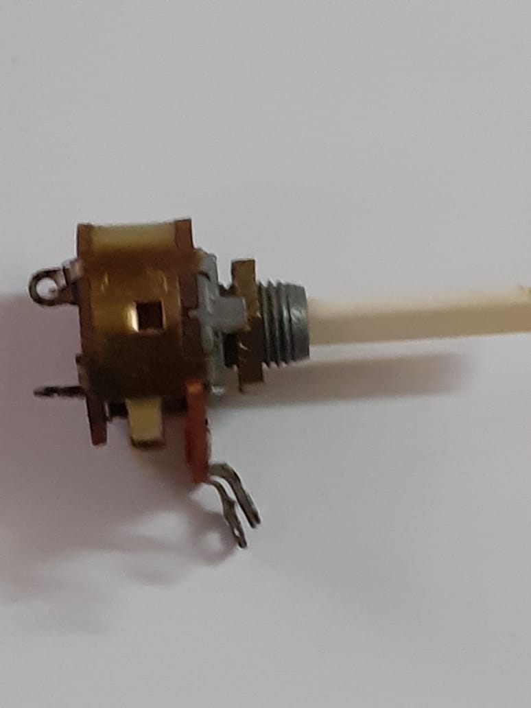

The pins 4 and 5 are at the bottom of the pot. And there are 3 pins on the top part,not 2, sorry for the terrible photos.
It will most likely have an on/off switch included - does it click if you turn it all the way anticlockwise?
Either than or extra taps or a wiping switch for a "loudness" control.
Either way, ignore the rear connections and use the three at the side.
Looking at it along the spindle and with the connections at the bottom:
Left would be common or 0V, right would be signal input (the "top end" of the pot resistor in the schematic) and the centre is the output, the "wiper" contact.
rjenkinsgb, sir, yes it does click if turned all the way anticlockwise sir. Thank you for pointing out which pins are which sir.
Nigel Goodwin, thank you for replying sir, I'll try to connect it with just the three in line pins as rjenkinsgb directed and see how it goes.

The 2 transistors "FM radio" will have VERY poor performance.
The amplifier output power will be only 0.45W when the 9V battery is new and will be only 0.2W when the voltage has dropped to 6V.

audioguru, sir, um um, perhaps you might have a better schematic that I can try please?
An oscilloscope is used to see the waveform of one steady frequency, not the thousands of audio frequencies at the same time from a radio.
If you build an oscillator that has one steady frequency, then an oscilloscope can be used to see its waveform or the waveform of an amplifier fed from the oscillator.
A half-decent FM radio has at least 5 transistors and 5 tuned LC circuits plus an audio amplifier. It is called a super-heterodyne FM radio circuit and can be seen in Google.

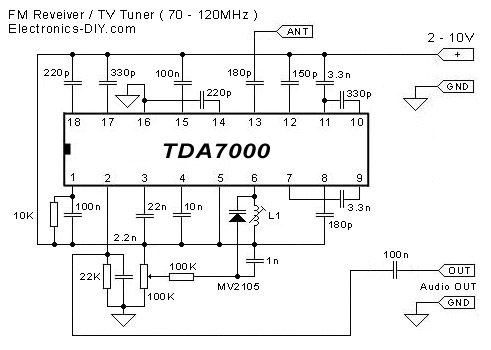

Does the above schematic look better than the first schematic I posted, everyone? anyone? Or is it incomplete or bad? Please do express your opinions.
Edit: TDA7000 is a chip I can buy online in one of our online stores.
The TDA7000 IC is very old and is obsolete. It is garbage. Philips invented it but made better replacements later.
The TDA7088 is one of the replacements but it is also obsolete and not made in The West anymore. There are cheap Chinese copies available online but they might be fakes.

audioguru: Yikes sir, sorry, I will keep trying to find a better schematic then. I had seen a TDA7088 one but that chip is not available in my shops.
Sadly, the circuits I find have IC's that are not available to me probably because they are very old models. The TDA7000 IC, is available and I actually bought two, but audioguru warned me against trying to use one of those, so presently, I am thinking of buying a DIY fm radio kit from Amazon. Thank you everyone for the replies, I am so grateful to all of you.
