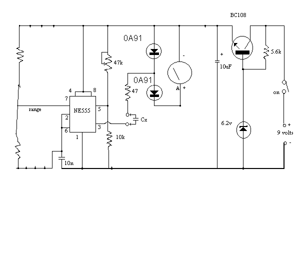

Ok Chaps, thanks for all your help so far, but i have to admit that my knowledge and understanding in this area is very limited and i am trying to do something a bit above my level, none the less, i still want to give it a go.
I have attached my circuit (i think) for measuring the capacitance, where cx is the unknown capacitor that is being created in the oil. Sorry about the missing values (and even the ones that are there might be a bit wrong, i'm afraid i have left my diagram somewhere.)
I am prob expecting this to be much simpler than it is, but what i was hoping for was some sort of addition to my circuit that would allow me to basically plug my circuit into my computer and i would be able to see (and manipulate) data.

Ah, so is this 'Dual channel 12bit A/D convertor type MCP3202' like a component that i can add on to my circuit? If it is, that sounds good. If not, how do i use it?
RS232 is a standard for voltages when sending serial data between systems.
You could use the MCP3202, but since most of the microprocessors include ADCs, it's probably not necessary to have a separate one. A separate one would be needed if you actually want up to 12-bit accuracy.
Look at the smaller PICs and AVRs with ADC and serial ports.
