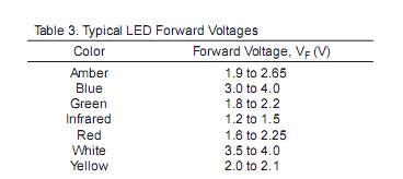

I would expect about +3.5V at the LS123 output when its high.
Are you sure that it is a 1k resistor in series with the LED.?
Whats the colour of the LED.? look at this image.

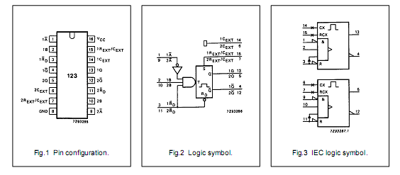

hi pierre,
I have just made your circuit on a breadboard and it works OK, approx +4.5V
Looking at the way you have drawn the diagram are you sure that you have the correct pin layout for the LS123.????
The image shows the TOP view.
Good morning :)
I did remove the 1k resistor and to my big surprise the voltage did not change much...:confused:
The LED is red.
and the output voltage is definitively not 3.5v...:confused:
Best,
pierre
As far as Cext/Rext for the control of the width the pin mapping seems to be correct (since I can manipulate it).
I was wondering about the diodes part.. could that potentially affect it?
pierre
pierre
