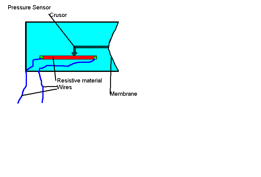

i build some sort of pressure sensor wich can be adapted...i hope so...
i used an old tv potenriometer(from a WB tv) and connected a spring on it, but it wasnt accurate....

meybe yo can trey something like this?
Thanks - not convnices
Thanks guys but still doesnt feel right. There is goingto be one of these on each finger and on the heel of the hand it has to be quite small, an air bladder is an interestin idea but will be too big..these things need to be the size of microswitches - doesnt have to be sensitive just has to be able to have 1-3 possible readings, as opposed to a microswitch that will have only one - any ideas ? sorry to wrack your brains...
