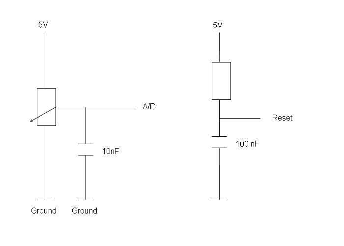

Hello Boncuk
And thank you for the prompt reply.
Now I have a few questions:
I saw your wiring (can you believe I am intimidated by even that...!) and after analyzing it I got that it is equivalent to the one I am attaching here. am I correct??circuit1.JPG
does this means than I will need a capacitor of 10nanoFaradays before connecting to the A/D? (no additional resistors??)
and my second question, in the circuit it is indicated that the wiper is number 3 and the 5v goes to number 2. I thought 2 is the wiper or does that varies with the potentiometer I got?? (ALPS RDC506)
Thanks always for the help
Also I didnt get so much about the last part. I am planning to use a PIC 18F2550 mic for this. Any comment about that will be appreciated as well.

Don't be bothered by number 2 or 3.
Sometimes you use A B C, as B being the wiper. (Alphabetical order)
Sometimes you use A C B, as C being the wiper. The reason for this is that the non-wiping terminals are connected internally through a carbon film (or resistive wire) and the Wiper terminal slides on this film. As A is adjacent to B, some think it is more convenient to let C be the wiping terminal.
The same thing happens when you name your terminals with numbers 123 or 132. They are the same.
The external terminals are connected through the resistive element.
Seeing the RDC506 datasheet (PDF pg. 3), proofs that it doesn't stay out of the rule. The middle terminal is the wiper terminal. https://www.alps.se/products/WebObjects/catalog.woa/E/PDF/Sensor/Position/RDC40/RDC40.PDF
Yes you just need the 10nF capacitor, to filter some transients. The ADC input is high impedance so you don't need any additional resistors.

Hi Kansai,
numbering pins/pads of a pot desn't make any difference in how it should be connected to act as a pot and in the desired direction.
I prefer to number the entire resistor pins1 and 2 and the wiper pin3. The logical device (package) must be numbered the same way to make connections in a schematic free of error regarding increase or decrease of the value at the wiper.
Having pin1 connected to ground and pin2 connected to a positive voltage source the voltage at the wiper (pin3) will increase by turning the pot clockwise (like used for volume control on the stereo).
This will become clear looking at the package drawing of the pot. Pin1 connected to ground will allow no positive voltage at pin3 (wiper) if the knob is turned fully left. (meaning pin3 (wiper) is shorted to ground. Turning the knob clockwise in the direction of pin2 (connected to VCC) the wiper voltage increases.
The two samples you posted are completely different. The left hand partial circuit shows an analog input with a pot and the right one shows the \RESET circuit. For normal operation of both ATMEL and MICROCHIP MCUs the \RESET must be high, while for in-system-programming (AVR-ISP for ATMEL and ICSP for MICROCHIP) the \RESET pin must be pulled low.
For a full span (0 to 5V) A/D conversion no further resistor is necessary. The value of the cap depends on the MCU clock frequency and the desired refresh rate of the A/D channel, but 10 to 100nF should suffice in any case, using 100nF for slow clocking.
The cap at the \RESET pin is not a MUST, but recommendable to avoid unintended resets of the MCU due to stray signals.
One thing applies to both - PCs and MCUs: Garbage in --> Garbage out (Why produce garbage when designing the circuit?)
