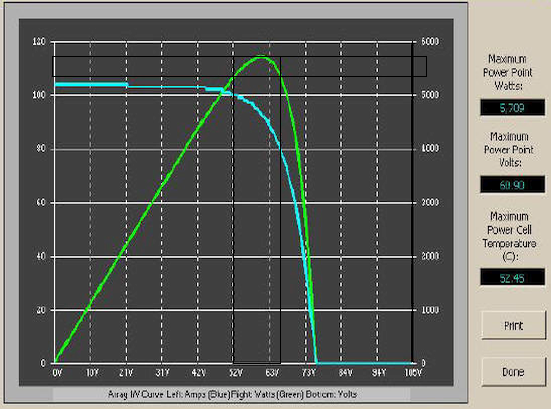

More? Actually, MPPT is normally 80% of 67 Voc = 54V not 60V.or 90%.
So it is well matched as is with just a PWM buck reg..
54V is not enough. It is some drop in the controller, so your 54V becomes 53V. If you only have 53V, you cannot properly charge the battery.
60V would be slightly better, but still not enough because the conditions are not always perfect, and Vmp goes down substantially when the panels get hot (as they normally do).
Batteries need to be equalized from time to time, and this requires 62V or more. Add to this controller drop and temperature drop and you get a number around 75V.
OP has an MPPT controller, so higher voltage is not a problem. Getting 3 panels in serieas (rated Vmp around 90), or 4 (rated Vmp around 120) ensures that the controller can always produce enough voltage for charging.

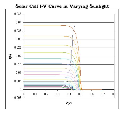

MMPT is closer actually to 78% of Voc +/-5% which is fairly flat and the loss of 1V or 2% of power in NorthGuy's arbitrary regulator is significant.
I would challenge anyone to prove you can get better efficiency than direct charge from Array to battery with no drop and only OCP and OVP with Voc =1.25* V(100%SOC).
I think the advantage of MPPT is that when you oversize the PV to the system, you can fully charge in less time in case of low time duration for full sun.
All you need an extra 5% Voc for PV panel or Vmpp to increase charge current with a discharged battery. There is no need to choose a MOSFET with more than ~50~100mV drop for OVP at worst case current.

MPPT: you get Vmp*Imp*Efficiency (97% or so)
No controller: if (Vmp > Vbatt) you get roughly Vbatt*Imp, very little otherwise.
Assuming you keep Vmp > Vbatt without controller, the difference is:
Vmp*Imp*Efficiency - Vbatt*Imp = Imp*(Vmp - Vbatt) - Vmp*Imp*(1-Efficiency)
To make it even, you must make these terms equal, or Efficiency = (Vmp-Vbatt)/Vmp. To beat 97% efficiency, you must have your Vbatt just 3% below Vmp. With both Vbatt and Vmp having considerable variation and such a small difference between them, it is impossible to avoid (Vmp < Vbatt) situations, in which case you lose most of the production. Typically, people with PWM (no MPPT) controllers, use 18V (Vmp) panels to charge 12V (nominal) batteries to avoid the (Vmp < Vbatt) situation.

Hysteresis is when the peak power moves depending on if you sweep with voltage rising or falling. If current rises with voltage and falls exactly the same, it is predictable and stable. If current rises when voltage is reduced ( by an equal amount i.e. constant P) and then rises when voltage is increased ( i.e. rising power) at the same operating point, then you have hysteresis. So time response and non-linearity of system, memory effects etc, all contribute to hysteresis and potential hunting. the "gain" of the system also changes the stability margin of the system for different loads and PV % power available as the MPPT point shifts downward with P as much as 25% but still follows closely to around 78%+/-5 of Voc.
Not saying an optimal algorithm cannot be achieved, but saying there are plenty of opportunities for failure and testing for operating point stability and regulator losses must be considered in any overall system.
Commercial MPPTs are pretty good, even with partial shade and such.
The response time is quite fast and hysteresis is almost non existent. Your turn FET off - panel voltage starts increasing in less than 1us. You turn FET on - panel voltage starts decreasing equally as fast. If your input capacitor is not too big, you can get the full I-V curve in a matter of milliseconds. Lighting conditions don't change nearly as fast.
