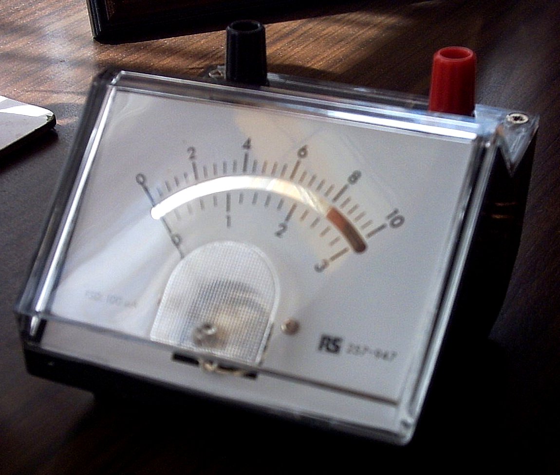

hi Al,
Just checked my stock I have a brand new 100uA FSD analog meter, scaled 0 to 3 and 0 to 10.
Its a freestanding meter in its own case.
You have my email, send me your address if you want it, its yours free gratis.
Excuse the poor image, I had all my decent camera kit stolen in Jo'burg 5 years ago, replaced it with a el-cheapo.

hi Al,
That would be great Eric, I will email you the details and will gladly reimburse you any costs, if you have a PayPal account it I can send it immediately.
Anyway I am going to email you with my details now.
Thanks again Eric....................Al :)

Did you steal it from school Eric? :p
Nice meter, from RS Components, which of course they weren't called when you (or me) were at school.
I have had that meter IIRC, since about 1970, never used it, still in its original box.!
Sadly a long time after my school days which ended in 1946.....
