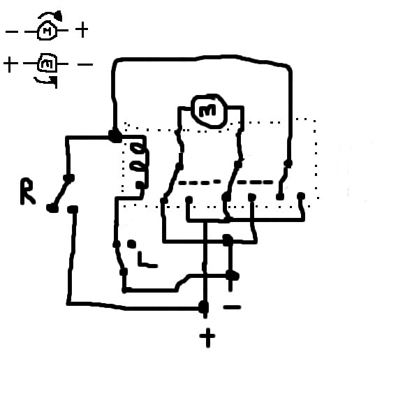

Hi
I was thinking about this, and i recon that you could build this using just a single relay and 2 switches.
please excuse the really crap drawing, but i cant find any of the symbols in my cad library.
The relay would need to be a 3 pole changeover, possibly https://uk.farnell.com/jsp/Electric...6283-9012-0000/displayProduct.jsp?sku=1169285
and 2 switches, 1 switch needs to be n/o and the other n/c, or you could just use 2 changeover switches, and wire them accordingly.
i choose a faston style relay, because i think the circuit could be hardwired to the relay, therefore no pcb, or anything else required, just some wire and a few faston terminals.
The switch on the RIGHT(R) hand side is N/O, and the LEFT(L) side is normally close.
Circuit operation,
when powered up, the motor will turn to the right, when it hits the RIGHT limit switch, the relay coil will energise, and latch (via the 3rd pole).
When the relay energises, it will reverse the currnet to the motor, causing it to run anti-clockwise.
When the LEFT limit switch is reached, it will break the power to the coil, causing the circuit to reset, and start heading clockwise again.
(please note, this is off the top of my head so please double check my logic before ordering parts if you use this circuit)
If needed i can draw a diagram complete with pin numbers for the relay to make wiring easy.
Hope this helps
Graham

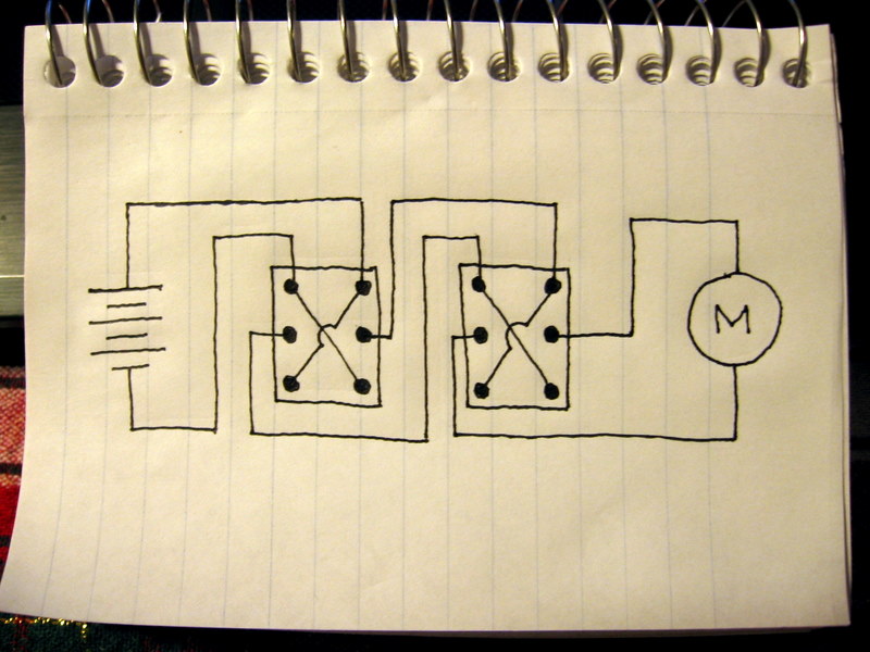

drovers said:
Hi Mike! Welcome to the board!
I think you were very close to the answer. Near as I can figure you can do this with just two DPDT switches (such as guitar stomp-box switches) wired in polarity-reverse. The motor will always reverse direction when one of the switches is flipped. It doesn't matter what orientation either switch is in to start with; as soon as the target hits one of the switches and flips it, the polarity to the motor will reverse and the target will go the other way until it hits the other switch. . .etc.
Hope this helps!
Torben

thats nice neat and simple, kinda like the wiring for stair lights, dont matter which one you press.
EDIT: just had a quick thing about this, the difference between the two circuits would be the pressure required on the switches, on Torben's design the swiches would need to be bigger to handle the current for the motor (which would be no problem in the specified scenario). I think my circuit might be useful to people looking for a circuit for making a model train (electric) traverse back and forth along a track as you can use very light duty switches, like mikro switches or quite possibly reed switches, so there is no physical contact with the body being moved.
Wow!
Really big thanks to you Guys, Wmmullaney, Weegee and Torben. I'd really played with this and everything I came up with was just getting bigger and bigger and just too complicated!
I'm going to try Torbens first, as you say nice neat and simple,
Many many thanks

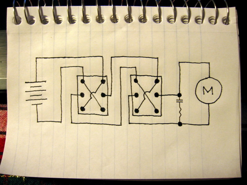

Hey Mike,
I'm looking forward to hearing how it works out. One thing that occurred to me: in order to extend the life of your switches, you might want to include something called an "RC snubber" across the motor. This is just one resistor and one capacitor in series from one motor terminal to the other, and helps to keep the motor's back EMF spikes from causing the switch contacts to arc. See the amended attachment.
I'd try maybe a 0.1uF cap and 100hm: 0.5 Watt resistor to start with.
Torben
[Edit: Make sure you use a non-polarized cap!]

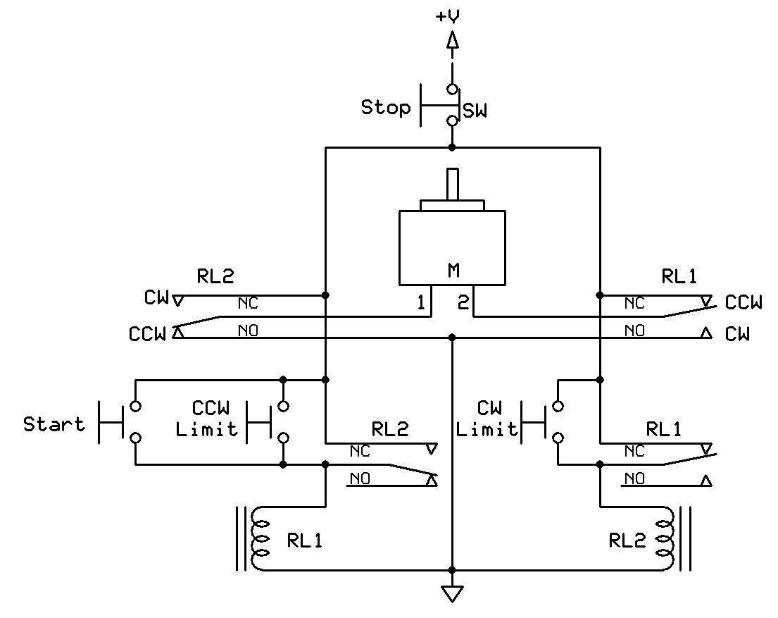

dovers,
This should work for you . Start, CW Limit, and CCW Limit are all momentary NO switches. Stop is a momentary NC switch.
Ken

dovers,
Ken
Mia Colpa! My motor reverser circuit (above) Does Not WorK!
Thanks, saturn1bguy, for catching that. No more mental circuits. I was trying several things at once and sort of got lost in it.
Ken
