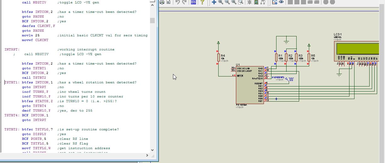

Took the original file and ran it though mplab as a 16F84A chip modifying the tasm as needed.
As you found it does not display, but the simulation I ran shows that its not recognizing the interrupt signal on RB0, just running around that bit of code.
As John admits himself its a complex routine so might take a lot of time and trouble to debug fully.
Even then to modify his code to add in different things will probably be even more complex.
Perhaps with all his general methods shown in the pdfs it might be quicker for you to write your own from scratch; at least you will have 100% knowledge of whats happening.
Would also suggest you move onto the 16F88 ; many folk seem to have weird problems with the 628 chip as this forum shows.
