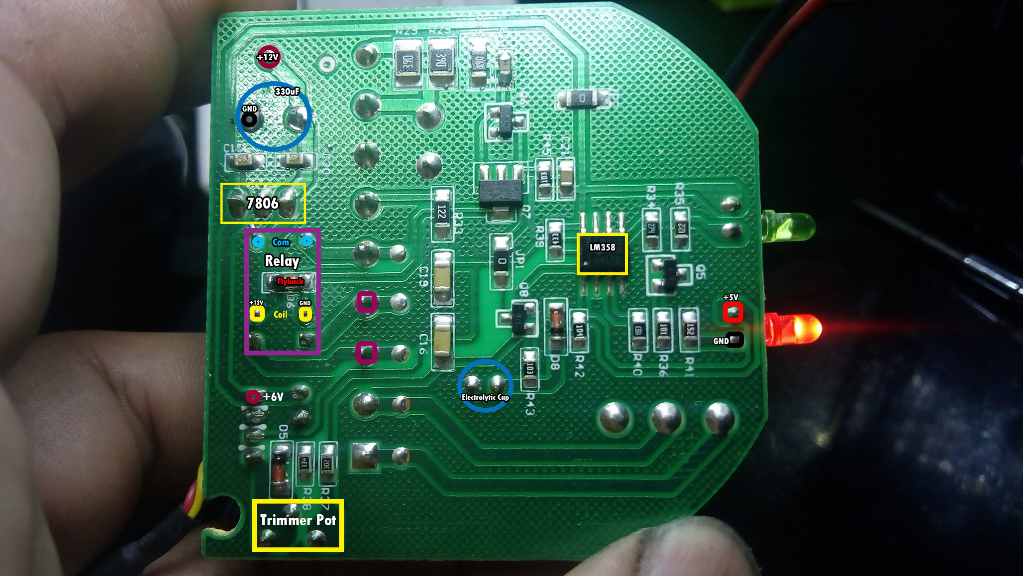

Can someone help me remove the delay on the circuit above? It is a infrared beam cut detector, much like a burglar alarm. It works fine except for one thing, delay on the relay.
I'm trying to use this on a race beam-cut system and delay is causing problems. The Red LED reacts in realtime with the beam cut but the relay doesn't. I've tried removing caps but still the problem persist.

Where to the coils on the relay go to? They dissapear onto the other side of the board.
It probably runs to the one of the Q components which would be a transistor that is being controlled. The stuff connected to the gate pin of that component is what you're interested in.
Pine 2 on the LM358 seems unconnected. Does it go through a via or somethign to the other side of the board?
Thank you for replying dknguyen, the board is not double sided and Pin 2 is the trace that runs below Q8 going to C16. I suspect that it is thru the Qs and they are not labeled.
About the relay coils, 1 pin goes to +12V source, the Ground trace goes to Q7 passing thru the Flyback diode.
Do you think If I try removing every capacitor in the circuit one by one I would be able to find it?
If you have an analog meter, try measuring the voltage on the electrolytic while interrupting the beam, if the voltage goes up & down when the relay clicks then you know its involved in that part of the circuit.
Do a connectivity test. Find the cap connected to the pin of the Q component that the relay coil goes to.
I just did what you said and I got it. The smaller electrolytic cap discharges as the relay clicks. I removed it and delay was gone. Thanks.
