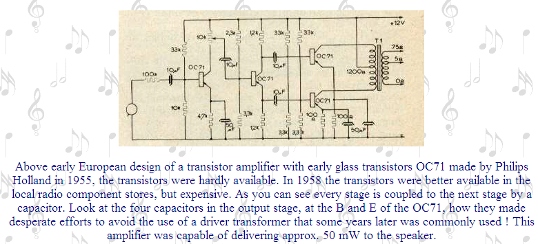

I remember reading about circuits using CK722s in magazines.
Look what I found. If you look closely you will see that the supply voltage is the wrong polarity!
