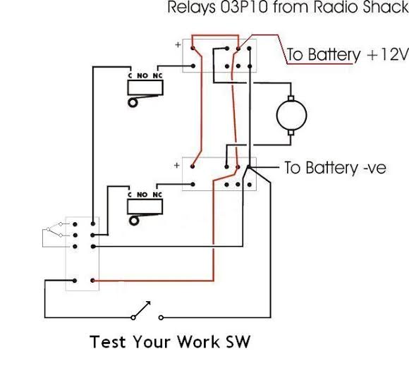

Hopefully someone would be able to help me out with a quick circuit diagram as sadly it seems I’ve reached a point where I’m completely stumped as how to do something that seems like it should be a fairly an easy thing to do... I’ve spent countless hours searching, reading and learning yet still unable to get exactly what I’m after. I have managed to put together something that does what I’m after by using what I’d learned and found online but let’s just call that attempt ‘optimised for improvement’ at best!
So here’s a basic description of what I’m essentially trying to achieve:
A switch that when turned on will turn a light on as well as turn a dc motor one way until it reaches a limit switch, at which point the light remains on but the motor stops.
Then when the switch is turned off the light goes off and the dc motor goes in reverse until it hits a second limit switch.
I guess the simplest thing I can think of that is somewhat similar would be pop up head lights on a car.
My attempt used a couple of dpdt relays and micro switches but the relays became incredibly hot when the motor was at rest, leading me to believe I’m doing something wrong..
Any help would be greatly appreciated

Thank you so much for the reply.. I never would have thought of looking up chicken coop doors, but i just had a quick look now and I think you may have just solved my problem!
I’ve found this one diagram that I think may be right?? (hopefully the attach works off my phone) I assume that I just run the light straight to the switch?
Everything is 12v including the led light, and there’s no need for an indicator..
I really do appreciate the help and pointing me in the right direction..
Thanks again

If i could though just ask one more question quickly in relation to the diagram i posted earlier. On the relay located at the bottom left of the picture(the one where the two limits both connect to) there's a little bit drawn in a thinner line essentially joining the three poles together.. I'm assuming that that's basically the on/off switch yes? if not then what is it? and if so then is the switch at the very bottom then necessary or just a safety precaution?
sorry if I'm being a pest, I'm still relatively new to this particular aspect of electronics.. I'm learning it as I go so i really do appreciate the help =)
In the diagram with the three separate relays, the bit in grey is just to identify the internal contact arrangement of the particular relays the author used.
Some types have the middle pin of the group of three as the common, that one has the pin nearest the coil as common (and next one up normally closed, then last is normally open).
The switch at the very bottom of the diagram is the operating switch, it controls the coil of the lower relay and sets which way the motor will run.
In the simpler one I posted, the contacts on just one relay would replace the "reversing switch" part of the diagram. then operating the relay runs the motor one way or the other.
I didn;t check the design, but the arrangement is probably.
Coil NC NO C for the rows of contacts.
The way some relays are designed, you have an arm and then two contacts, so the contacts are either the two left ot two rightmost ones. You know which one is the coil.
