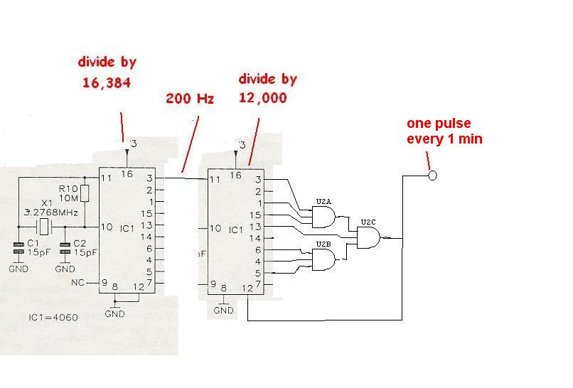

find the attched circuits, as i said the 1st attachement is a time base to get 1min pulses.
you have to add reset if you need accuracy over 60sec.

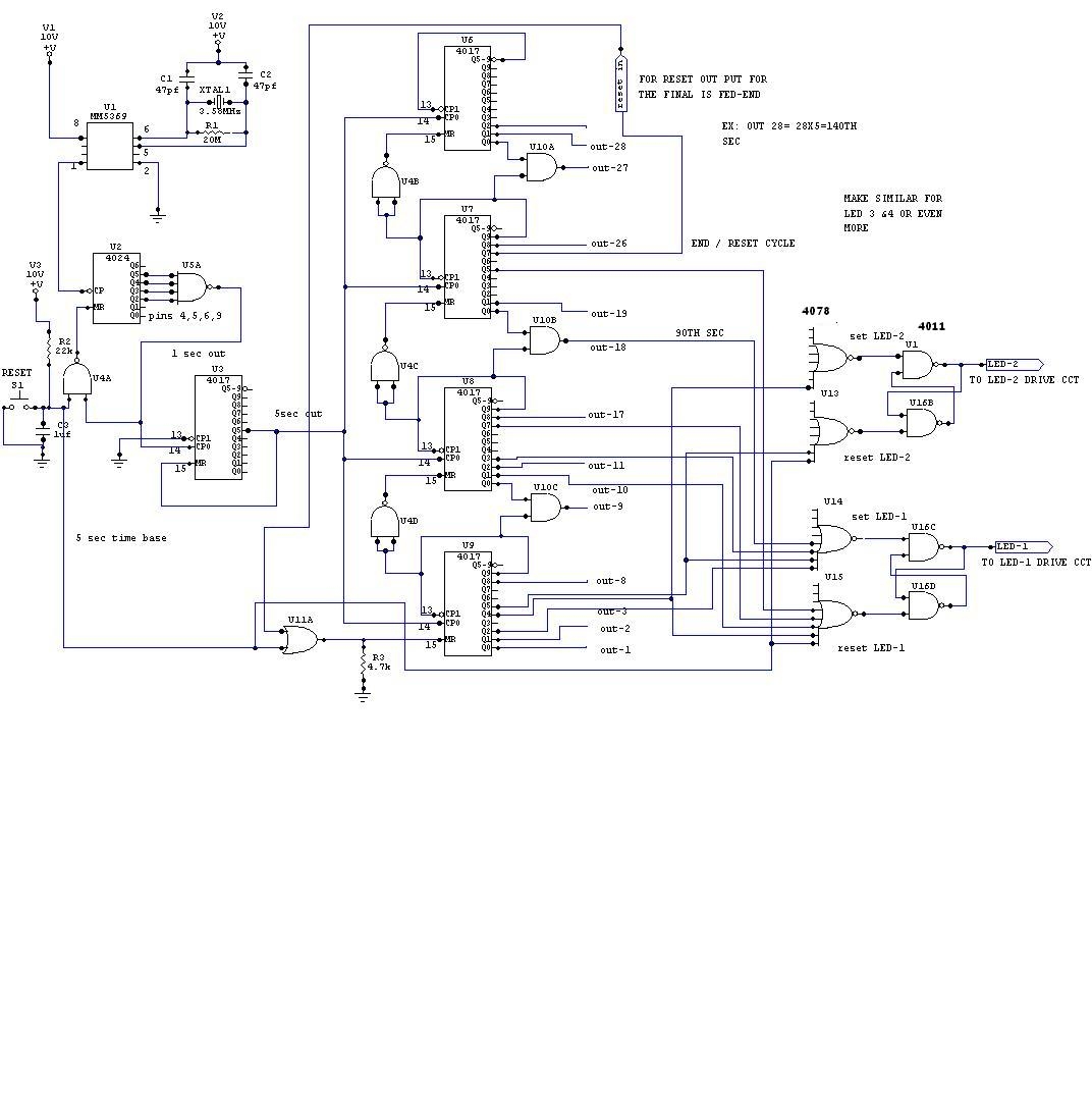

the 2nd is to show you how to connect 4017 counters in series. its an example from another post of mine. you need to connect 7 no of 4017 in series so that to get 60 states out puts, then the 60th out put has to be connected to the reset.

1) the time base exactly as in the 1st attchement.

Edit: another way you can use a 10x6 matrix to get 60 states. use single 4017 and reset it at every 10th clock, its reset will drive other 4017 that will count upto 6. so total 60 states. this matrix out can be combined using 6 transistors so that to display particular LED.

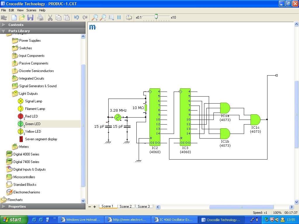

I tried this circuit in Crocodile technology, here is the picture 1mintimebase.JPG
i am wondering if i did it right? the pins are correct, because in croc tech they are labeled as outputs and inputs, not as pins, they are all linked at the correct pins. Have you used crocodile technology before?
it doesnt work, no voltage is carried through the chip, what voltage does the signal generator need to carry? and what do you mean by dividing the chips by 16,384 and 12,000?
i have no idea how the software you have works. it may not reflect the exact model. basically the oscillator is an internal built in oscillator for the particular IC, what you need is to connect the required crystal externally. when you connect 3.28 MHz, then the out put #14 will give you a frequency of 200Hz ( ie the original frequency is devided by 16,384 time)
what you need is a pulse every 1min, so need to further devide the frequency by 200x60 = 12,000. its done by 2nd IC. now you wil get accurate 1min pulses.
the idea to go for high frequency then divide it is to gain good accuracy. than trying on software go for practical soldering, it must work without any problem.
if you still want to simulate it, try the signal source 3.28MHz directly between ground and input, no further components required.i dont understand the connection on the botton of the IC (like 0100 ), no pin number nor explanation
