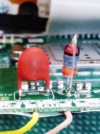

R RodneyB Member Mar 13, 2013 #1 Please can someone help me identify the components in the below picture. They are across the incomming line of a Panasonic KX-TG6561BX

V vtech Active Member May 18, 2013 #3 Panasonic used various devices for means of phone line protection. Orange device is a Movistor and the "glass diode" looking device is a spark gap protector https://www.ttnet.net/ttnet/gotoprd/ET325/050/0/94841303236323338353.htm https://smart-ele.en.ec21.com/Telecommuication_Surge_Absorber_TSA--378472_7337311.html

Mr RB Well-Known Member May 19, 2013 #4 I'm not sure it is actually a spark gap device, more likely to be a semiconductor bidirectional-breakdown device. Similar operation, ie high resistance but will break down and conduct in either direction when voltage exceeds a certain limit.

R RodneyB Member May 19, 2013 #5 If I was to take these component out and put bridges in and make a separate surge protection externally will this work?

BeerBelly Member May 19, 2013 #6 RodneyB said: If I was to take these component out and put bridges in and make a separate surge protection externally will this work? Click to expand... Are these components shorted? What are trying to do?

R RodneyB Member May 19, 2013 #7 I am trying to repair the fax phone and the incoming line is not working
BeerBelly Member May 19, 2013 #10 Pull them out and test them for a short. Most of those use an opto-isolator too which may be bad.
