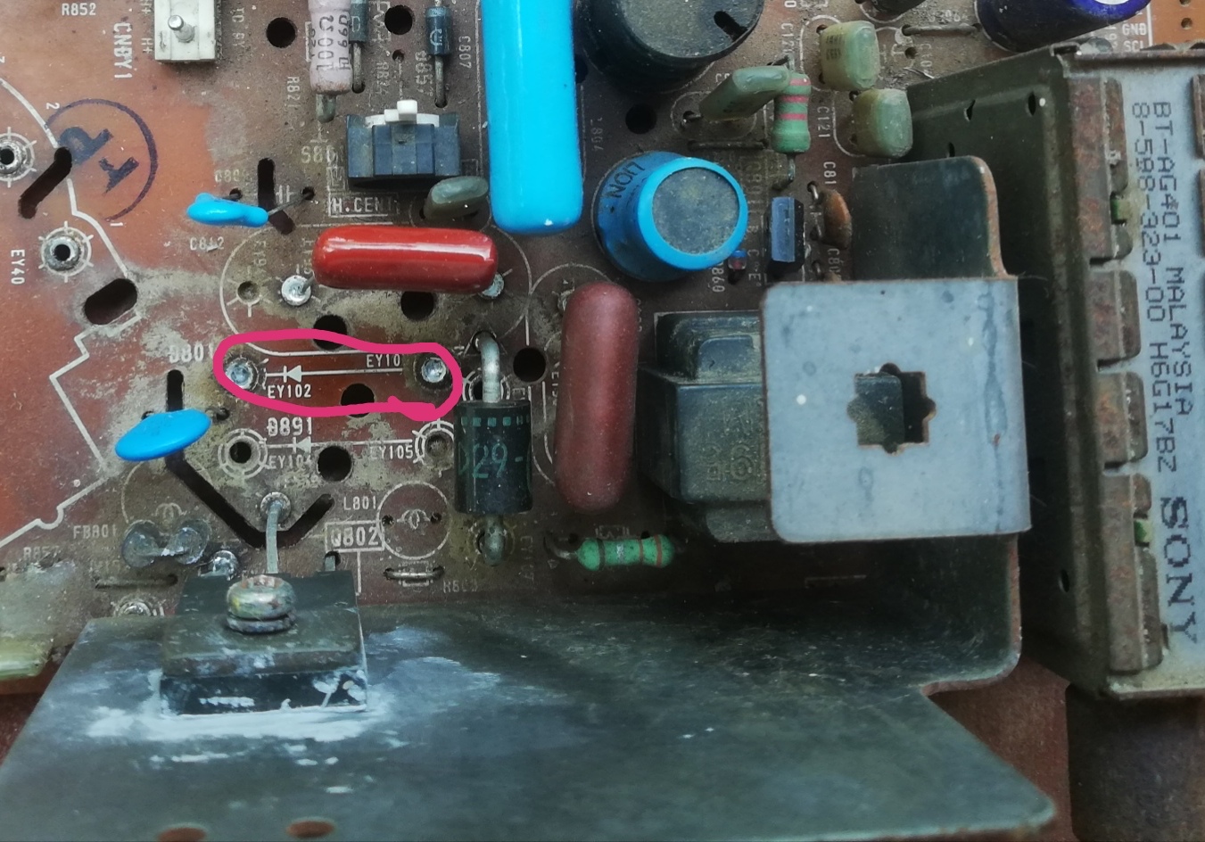

Hello all ☺️..,
I got an Sony Crt Tv (model number - KV-G21B1) and i found its damper diode is short. Then, I replaced it with a new diode (with same number as the old one) and after trying to turn on the Tv, the indicator led turns On and Off continuously with all the voltages of the board turning On and Off repeatedly. Then I found that the new damper diode I replaced was also short. I tried with few diodes but all of them became defective. I couldn't find the reason behind damaging the damper diode repeatedly and the following are the things I did with the TV board.
  • Resoldered all the dry joints including the Neck Card.
  • I found the 33v zenar diode is short at tuner and replaced it.
  • All the suspicious mylar capacitors are replaced around the H-OUT section.
  • Replaced the flyback transformer but nothing changed.
  • I checked the HOUT and VOUT transistors and they are fine.
Outputs of the chopper transformer are 115V and 15V. The flyback gets 115V properly.
Please support me to solve this problem and I am clueless in this case to repair this Tv.
Thank You very much for your time.

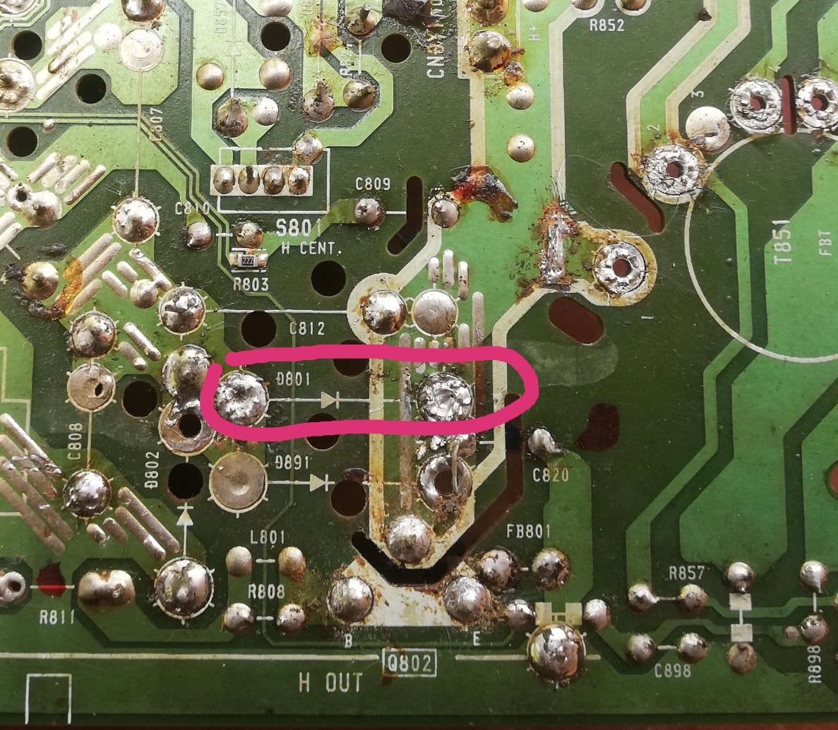

Thank you very much for the advice. Actually I am a newbie in electronic repairing. What I meant as a "damper diode"(just found that term on Internet) is a diode which is connected to the Collector of HOUT and other side connects with the ground.
(The diode and the flyback transformer are removed)
This diode (part number C06-15) was found as short and everytime I replaced a new diode (with same part number) all of them became defective (short) and the indicator led keeps turning on and off continuously with all the voltages of the board changing. (HOUT becomes hot during that but It was not defective).
Those were called 'efficiency diodes' in TV terms, but that's not what it is anyway - it's the top diode of the pair used in the pincushion modulator circuit, the other is D802. The actual modulator transistor is Q821 - I'd check components round there. If Q821 or D802 are S/C it might kill D801.

After replacing new diode, indicator led turns on and off continuously with all the voltages varying. Can this be an overload problem on power supply?
Yes, sounds like excessive current is been taken, so it's shutting down.
In the power supply section what I noticed is there are three 15 KΩ, 2W resistors which are in series directly with the positive lead of the smoothing capacitor to power up the Vcc pin of the STR S6707, are extremely hot (can't even touch) even if the Tv in standby mode for very few seconds. Then I removed the STR and powered up and I noticed that again those resistors have become extremely hot. 25V is feeded to the Vcc pin of STR. Can this be a problem for this case or what can be causing the for the overload problem? I tested these resistors with a multimeter and found that they are fine.
Those are the startup resistors - they should only be in use very briefly as the PSU starts up. If the PSU is tripping, it will repeatedly be restarting, so they will get much hotter. If you remove the chip you will almost certainly cause damage, C624 is going to die if nothing else.
As I said above, remove the LOPT, fit a 60W bulb across the 115V rail (where the LOPT transistor fits is easiest) and make sure the PSU runs without tripping, and it's output voltages are fairly correct - this eliminates the PSU as a problem.
Thank you very much. I removed the LOPT and added a 60W bulb across the 115V line and bulb lighted dimly without flickering or anything else. I searched for dry joints but nothing found. I found D802 is fine (multimeter shows about 0.537 value in one direction in diode mode) and Q821 is also fine. May I need to replace a new diode for D802 also and see what happen?
