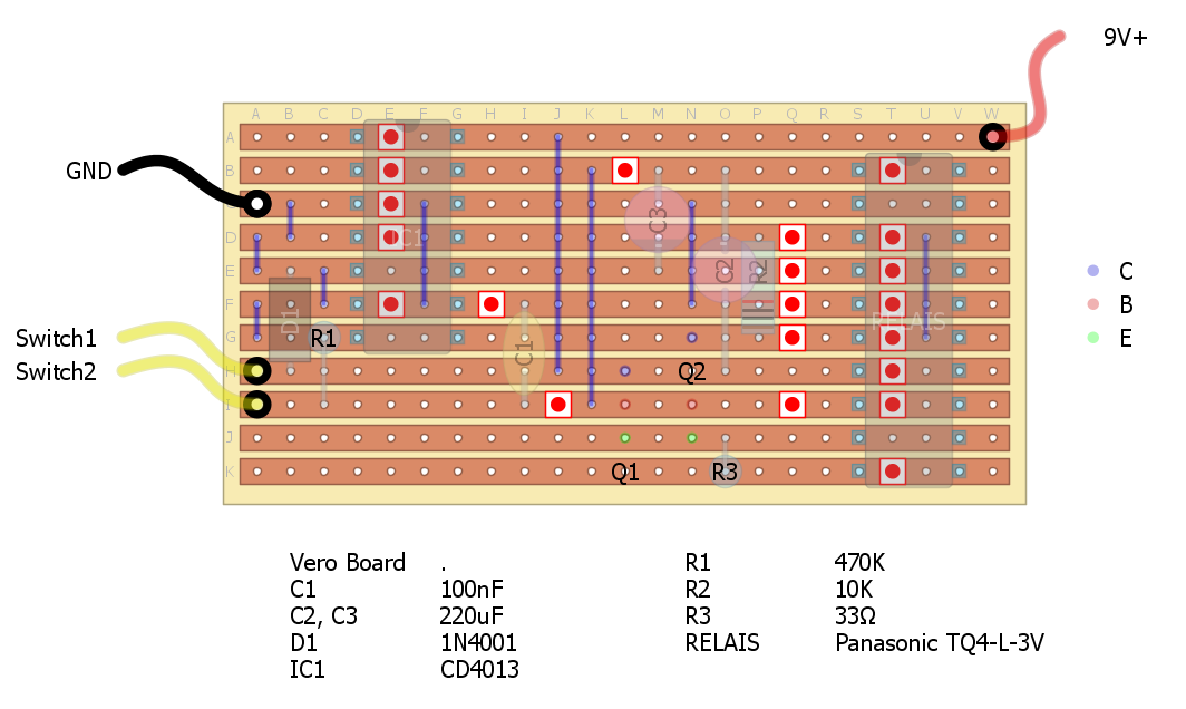

I've checked the board and the layout like 50 times for wrong connections or shorts, but I'm afraid I've looked at it so often I'm unable to see my own mistake.
My circuit is on a veroboard, with the IC's, the transistors and the relay on sockets for safe soldering and easy switching. Still haven't invested in a breadboard yet...

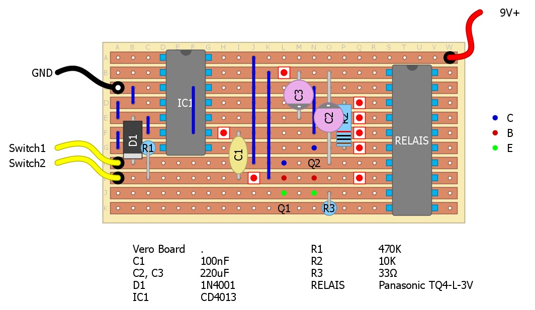

Here's the layout I made:
You have C1 connected to pin 12; it should go to pin 11.

Oops...that a mistake in the drawing, that not how it is on the board. The jumper is actually at row D, so it is correct.
I use this site (**broken link removed**) to go from a schematic to a layout. Because it keeps track of the different components that are linked together, it makes it a lot easier to come up with a compact layout. It takes some getting into, but after that it works great. Then I usually draw it again in DIY layout creator to make that fancy looking drawing. It's free to download and use of off google. I find that easier to use when actually populating the board and keep track of the different components, but it has some annoyances when working with it.
For the second layout, I didn't make the drawing at first. I used the online layout, because I was eager to get it working. I made the drawing this morning.
Assuming the jumper is actually at row D, get out your magnifier/meter and make absolutely sure that the track cut at row B column L is complete (no whisker of copper remaining). Also check for solder/copper whiskers bridging other tracks/cuts. Something else to check is that no legs of the IC have been bent under, and that the IC is fully seated.

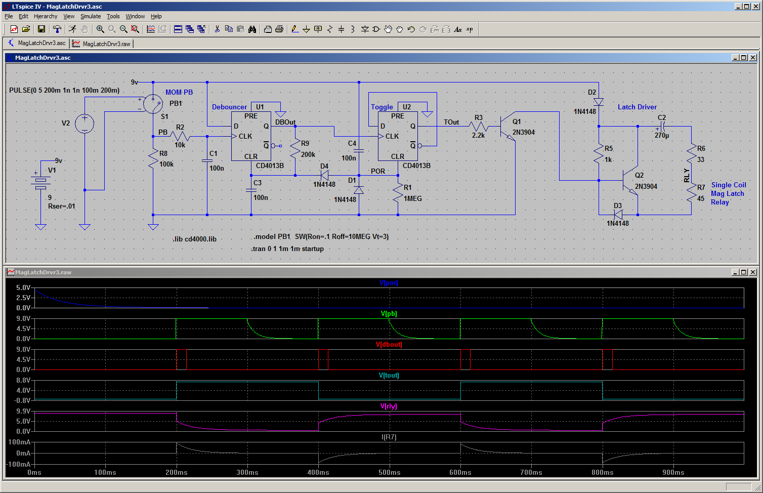

Hi
Here's a circuit you may consider...
The circuit I've shown I simulated from an 74HCT version and the results were good, so I expect it will work.
Since there are two D FF in the package, I used both.
I added a POR circuit because the Toggle FF would not always init to the same state on power up.
The circuit I bread boarded works but uses 74HCT74 FF so it was a little different ( I used two Voltages, 5v and 9v).
I'd breadboard the CD4013 version but I don't have a CD4013B (maybe tomorrow).
Anyway...it should work.

R1/C1 in that configuration will result in a slow clock ramp. Won't that exceed the clock spec rise time for the D-latch?
Sorry, R2/C1 (in your .png file).
