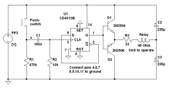

Something like this?

How hard is the circuit on the battery when it remains in standby?

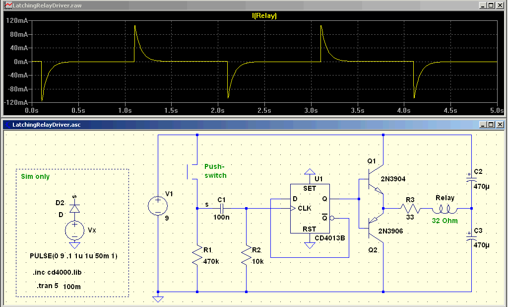

Standby current is ~ 20-30 μA (chiefly leakage current in C2/C3). R3 may need adjustment, depending on the current and pulse duration needed to flip the relay.
Edit: My simulation assumed a coil resistance of 32 Ohms, but from the datasheet for the single-coil latching type isn't the coil resistance 45 Ohms? If so, you might be able to reduce the C2/C3 values.
Edit: For a 45 Ohm coil (current = 66mA nominal), reducing C2 and C3 to 100uF each should give a pulse ~ 70mA lasting ~ 6mS (twice the max flip time specified).

With a fresh 9V battery R3 is theoretically needed to limit the current into the 3V 66mA rated coil. However, the coil will withstand a brief pulse exceeding 66mA, since coil heating depends on both the current and the pulse duration.
The values shown for R3 and C2/C3 give a pulse which exceeds 66mA for only a few mS (so is not harmful), but is ~66mA for sufficient time (hopefully!) to allow the relay to flip.
Reducing R3 would increase the peak current. Reducing C2/C3 would reduce the pulse width to compensate. A balance has to be struck between a pulse with enough current and duration to operate the relay reliably even when the battery voltage drops, and excessive current or duration which could cause overheating (unlikely) and waste battery power. As a compromise I think I'd leave R3 at 33Ω and make C2/C3 perhaps 220μF each. You may need to experiment to get the ideal values for your particular relay and various battery states.
Even if the relay were operated 100 times a day the battery should last > 1 year.

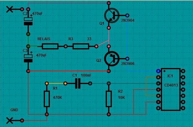

I've never worked with this kind of IC before, and by the looks of things it seems like I only have to wire up one side...
I'm assuming that this is correct, but I might as well double check it.
I've attached my scematic (with the old values and missing switch) and the data for the IC. So is my scematic correct?

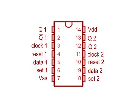

In that case be aware that CMOS ICs can easily be damaged by static electrical discharge, e.g. from the human body, so take due precautions when handling it. This is a dual latch IC (as you've noted). Unused CMOS inputs should be grounded. Here's the schematic with pin numbers added.
So, picking up on my old thread...
Finally received my much needed relay (took like 4 months). I had already designed the board and put everything on it. So it was already ready to be tested, all it needed was the relay.
So I put it on, hooked it up and it works, sort of... I could use some help debugging...
So here's what it does: let's say the relay has two positions where it latches,the ON position and the OFF position. When I hook up the power supply, nothing happens and the relay remains in the OFF position. When I press the button, the relay latches in the ON position, but when I press it again nothing happens.
When I then remove the power, nothing happens, even if I press the button. When I reconnect the power supply, the relay latches to the OFF position. Now the cycle can be repeated. There's only one other thing: after the relay gets "stuck" in the ON position and I reconnect the power for a brief moment, the relay latches back to the OFF position and the switch then works once without a power source connected. After using the switch without the power connected, the relay switches to the ON position and remains there, even when the button is pressed again or when the power supply is reconnected. It only latches back off when I dis- and reconnect the power once again.
That's about as detailed as I can be...
Where could the problem lie?
Which circuit are you using to drive the relay? Post a link, or the actual schematic
Alec_t helpt me out a bunch, by designing the circuit for me and he posted the final schematic in his last post. It's the one from the 1st of July
Assuming it is wired right...
I notice that the only timing info on those data sheets shows the relays being driven with a 20Hz square wave. That would make the pulse period ~50ms. Alec's circuit applies a pulse width which is ~15ms. It is wide enough?
Another likely problem is that the push button is not debounced. If the button causes the flip-flop to change multiple times at each push, there could be either an odd or even number of flip-flop transitions. If you put a scope or meter on the Q of the flip-flop, does it change state from 0 to 1 and 1 to 0 per each button push?
The spec gives the switching time as 3ms, so 15ms should be enough.
It is debounced, by R1C1 (time constant 47ms).

Check that R1 is properly connected.
What is the voltage at the C2/C3 junction?
Can you confirm you have pins 4,6,8,9,10,11 grounded?
Try connecting a 220uF capacitor (if you have a spare) directly between pins 7 and 14.
