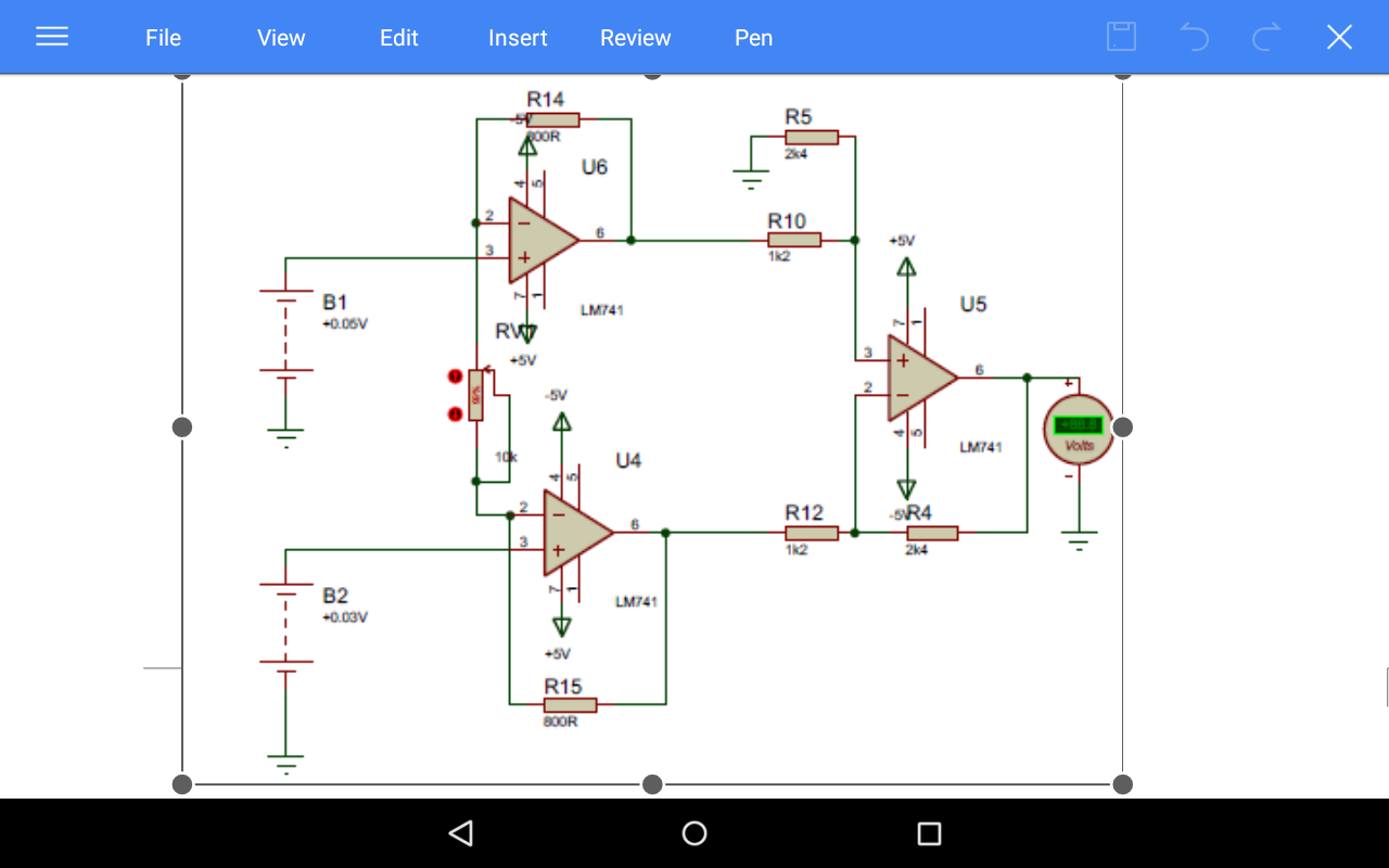

Below is the proposed instrumentation amplifier to be used.
But the problem I'm having with the instrumentation amplifier is that I need just 2 wires from the instrumentation amplifier to M and N. But I'm having 3, i.e two for floating voltages (V1 and V2) and the third one as the ground (GND). I need just two (the ground and another outlet for input) that will go to the M and N on the block diagram
That's a Wenner earth resistance array:
https://en.wikipedia.org/wiki/Electrical_resistance_survey
You are effectively using the area of ground under the electrodes as a double-tapped potentiometer.
Any general instrumentation amp should work fine, just make sure the supply voltages are rather more than the outer electrode voltage - or divide the probe voltages first (with high value resistors) to keep them well within the amp common-mode range.
An INA128 is readily available and a good low-noise device.
https://www.ti.com/lit/ds/symlink/ina129.pdf
I'd add some form of protection diodes on the inputs, eg. diodes from each to the positive and negative supplies, so the input voltage cannot exceed a safe range.

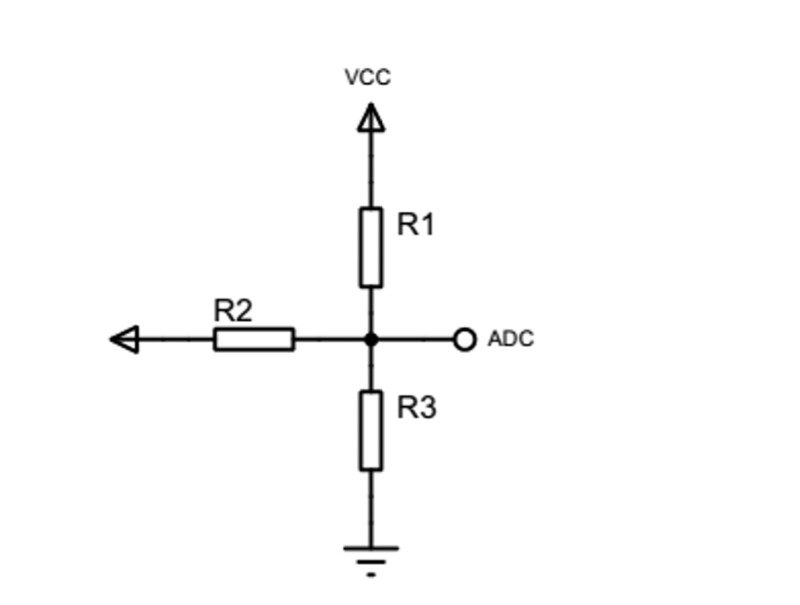

This is the voltage divider that measures negative and positive voltages. It works well in the lab but when connected to the ground, it is not that sensitive enough

Re. your last post. (#22)
The system 0V or common "ground" should be the "centre" potential - eg. if the outer electrodes are at + and - 15V, system ground is the central 0V point.
That allows the greatest input range either side of zero.
The ground is also the zero reverence for the PIC ADC if you are using an analog input to capture the reading.
Re. again (#24)
That will work when connected to the instrumentation amp output, as long as the resistor values are appropriate. R2 and R3 in parallel should equal R1, with the ratio between R2 and R3 setting the input sensitivity.

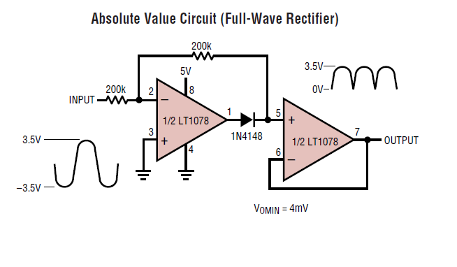

A simple diode-capacitor is not a good way to see AC voltages that are small. It takes 0.6 volts to turn on a diode.
Here is a circuit from the data sheet of the LT1078. It will work with very small AC voltages.
If you build this circuit use a "R-R input & R-R output, low voltage op-amp". Or at least use a op-amp that will work when the input is at ground. See "input common mode voltage range".

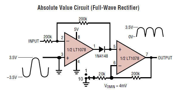

Here is my modification. I added a switch for a gain of 1 or 10.

Here is my modification. I added a switch for a gain of 1 or 10. View attachment 114392
