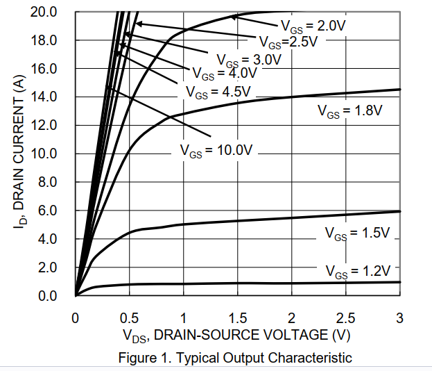

Datasheet for MOSFET attached. The circuit is a commercially prepared circuit board measuring 20x20mm. Motor traces (leads) are 0.75mm, all others are 0.25mm. Photo of board layout attached. Capacitor connection to the right, motor connections to the left and MOSFET between M- pad and switch.

V+ varies with the capacitor's voltage; normal range 2.1 to 5 volts.
I will change out the 1k for a 100 ohm.
You need a proper driver - and probably a SM circuit to increase and regulate the drive voltage, as losses will increase massively as the capacitor rapidly drops in voltage, and at only 5V to start with it's pretty poor to begin with.

A driver provides sufficient current to the FET to rapidly turn it ON and OFF, otherwise it get's hot and runs inefficiently, wasting power as heat, and potentially burning out. SM means 'switch-mode', a device for taking the rapidly falling low voltage from the battery, and increasing it to a higher regulated voltage.
