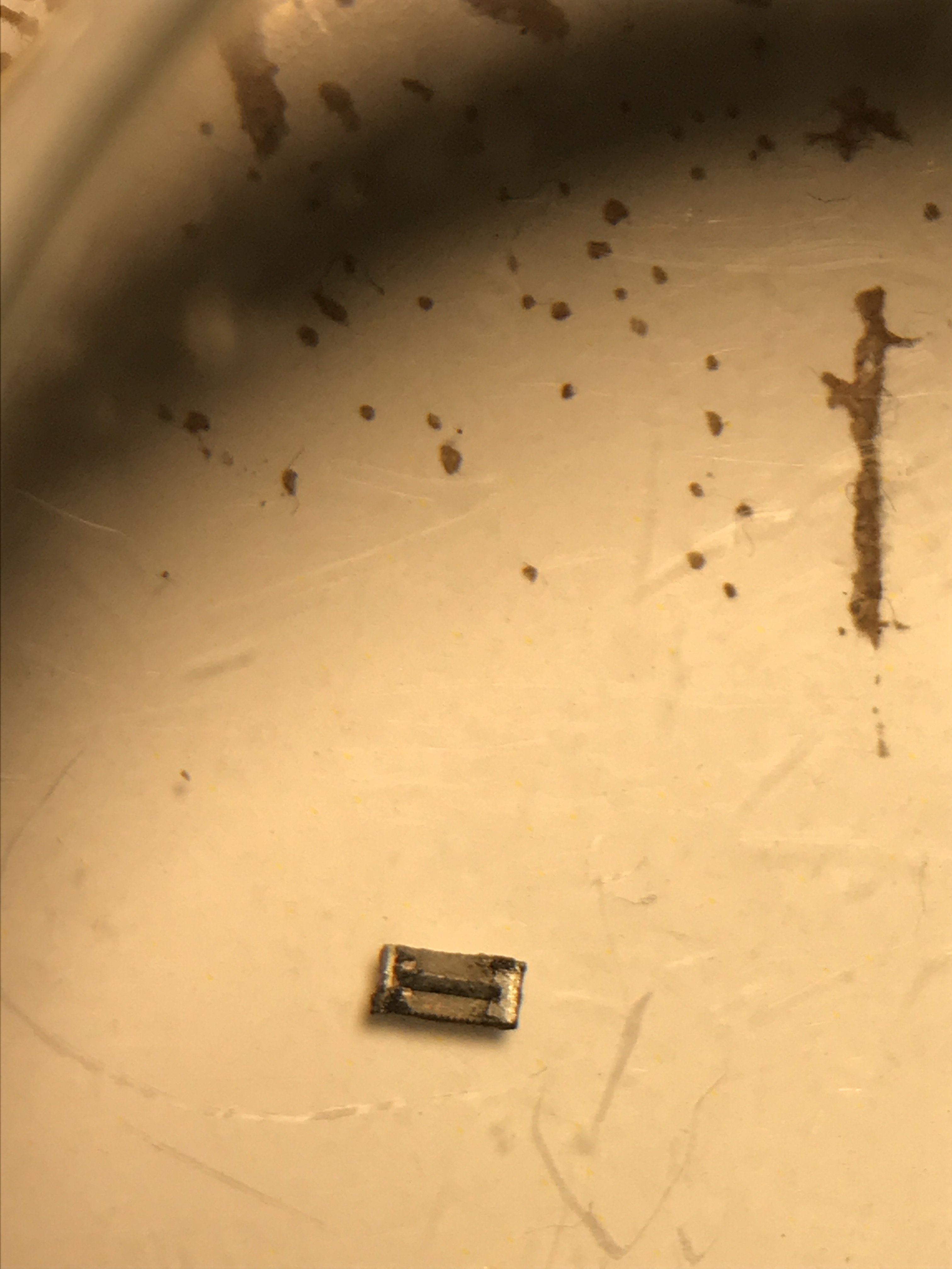

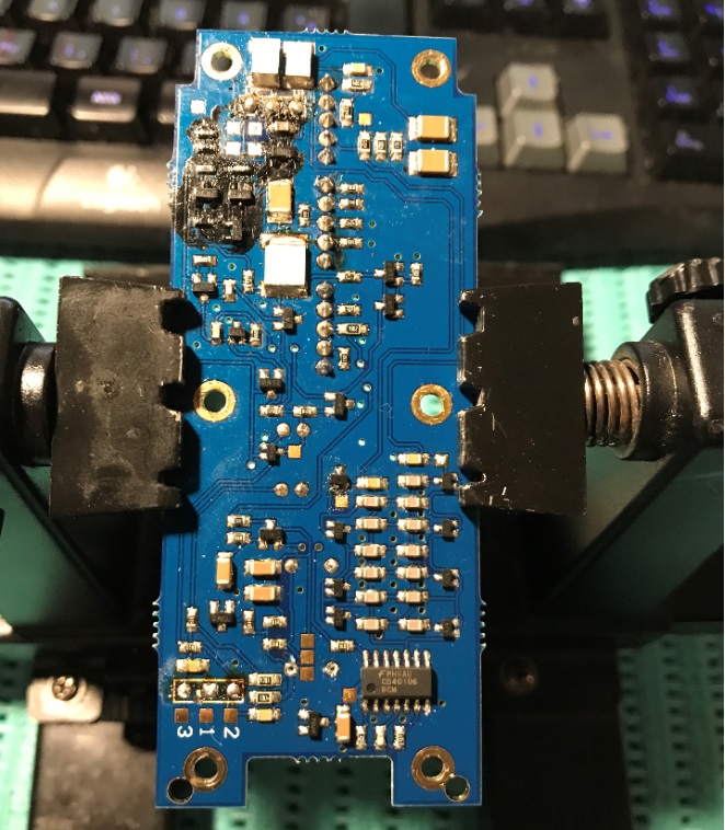

help in identifying component

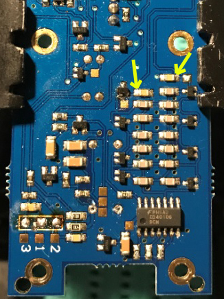

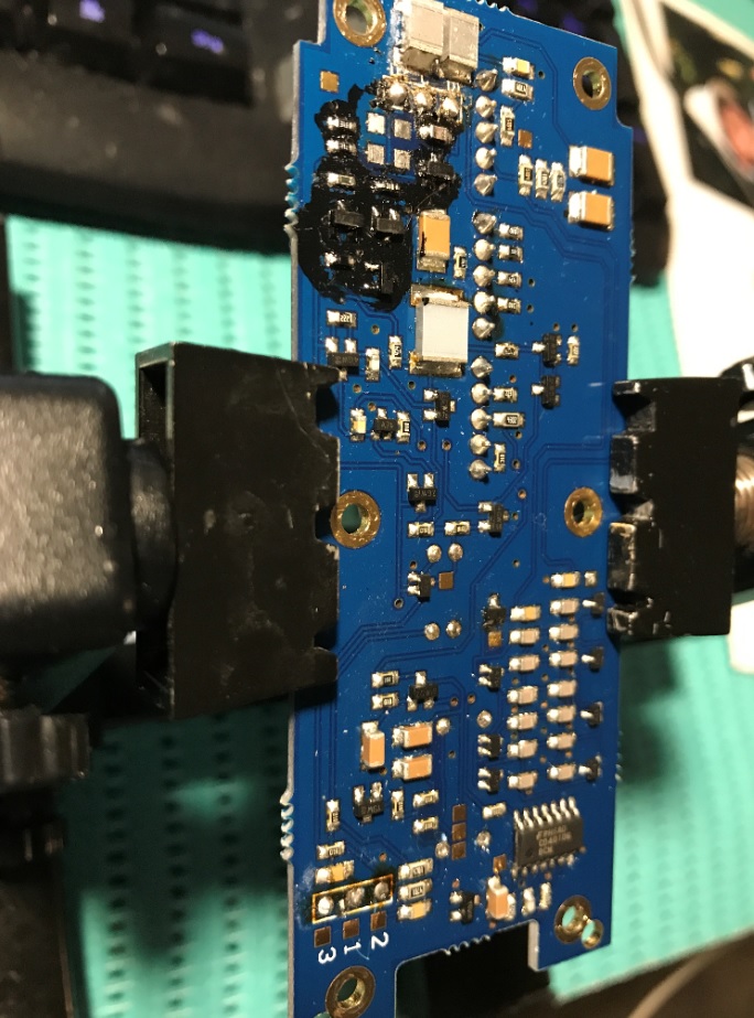

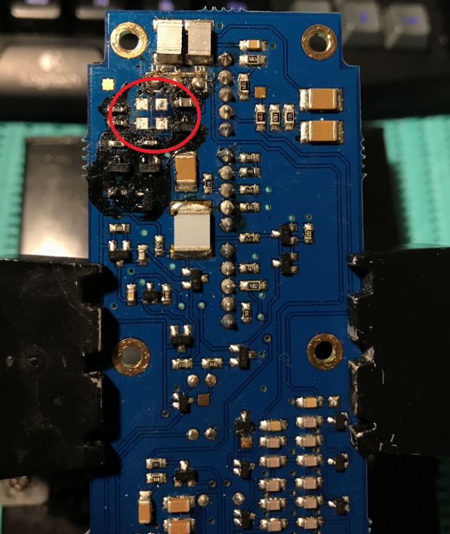

This component that belongs to a RODE NTA2 condenser microphone, unfortunately it does not work anymore, and I sent it to be repaired in the RODE technical service, and its answer was that the Mainboard has to be changed, the problem is that the mainboard costs € 38 but with the The total workforce is € 201, that is an exaggeration of price, so I would like to repair it, ahh forget to mention that they do not sell the parts to repair the microphone by oneself.

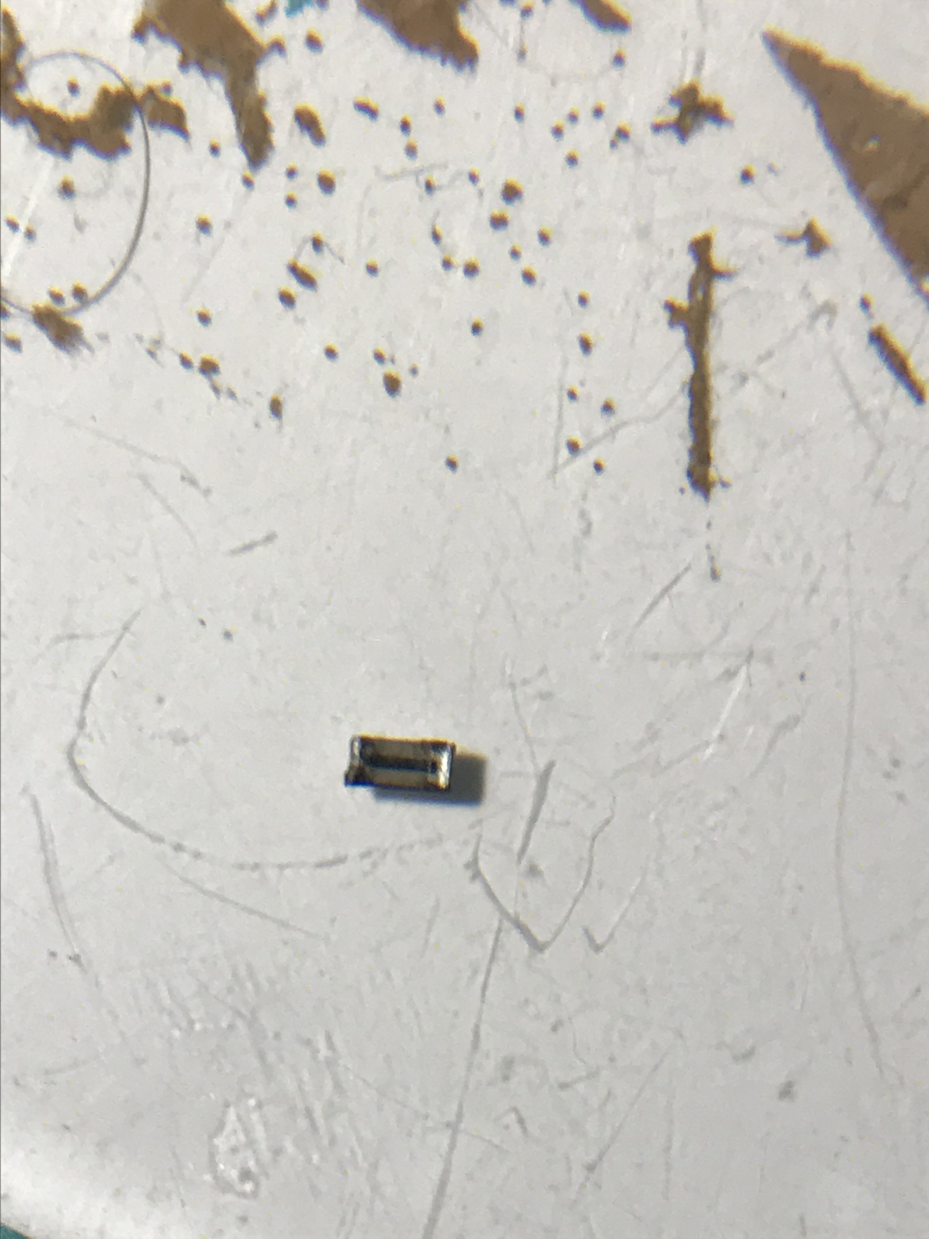

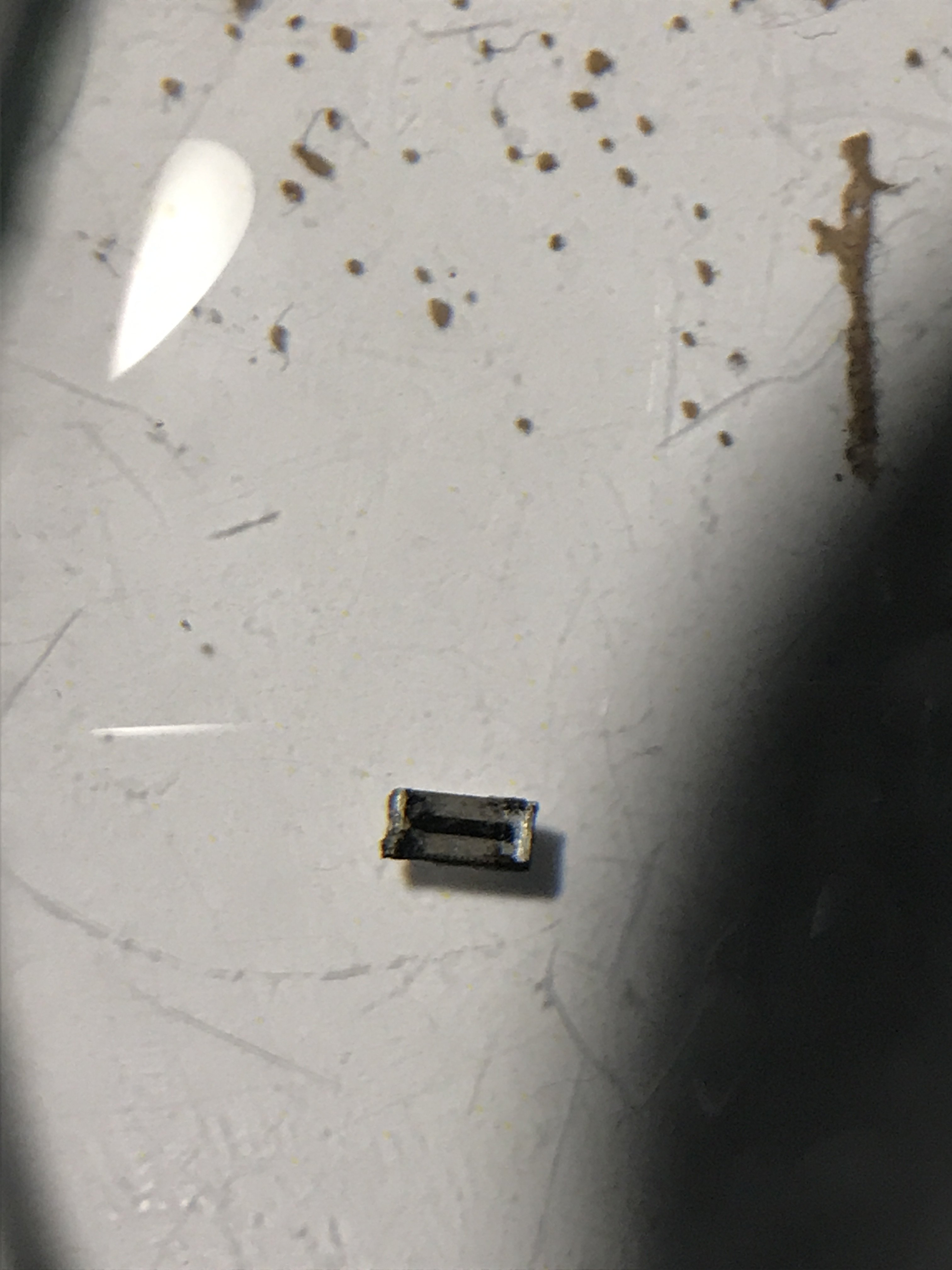

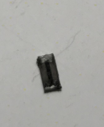

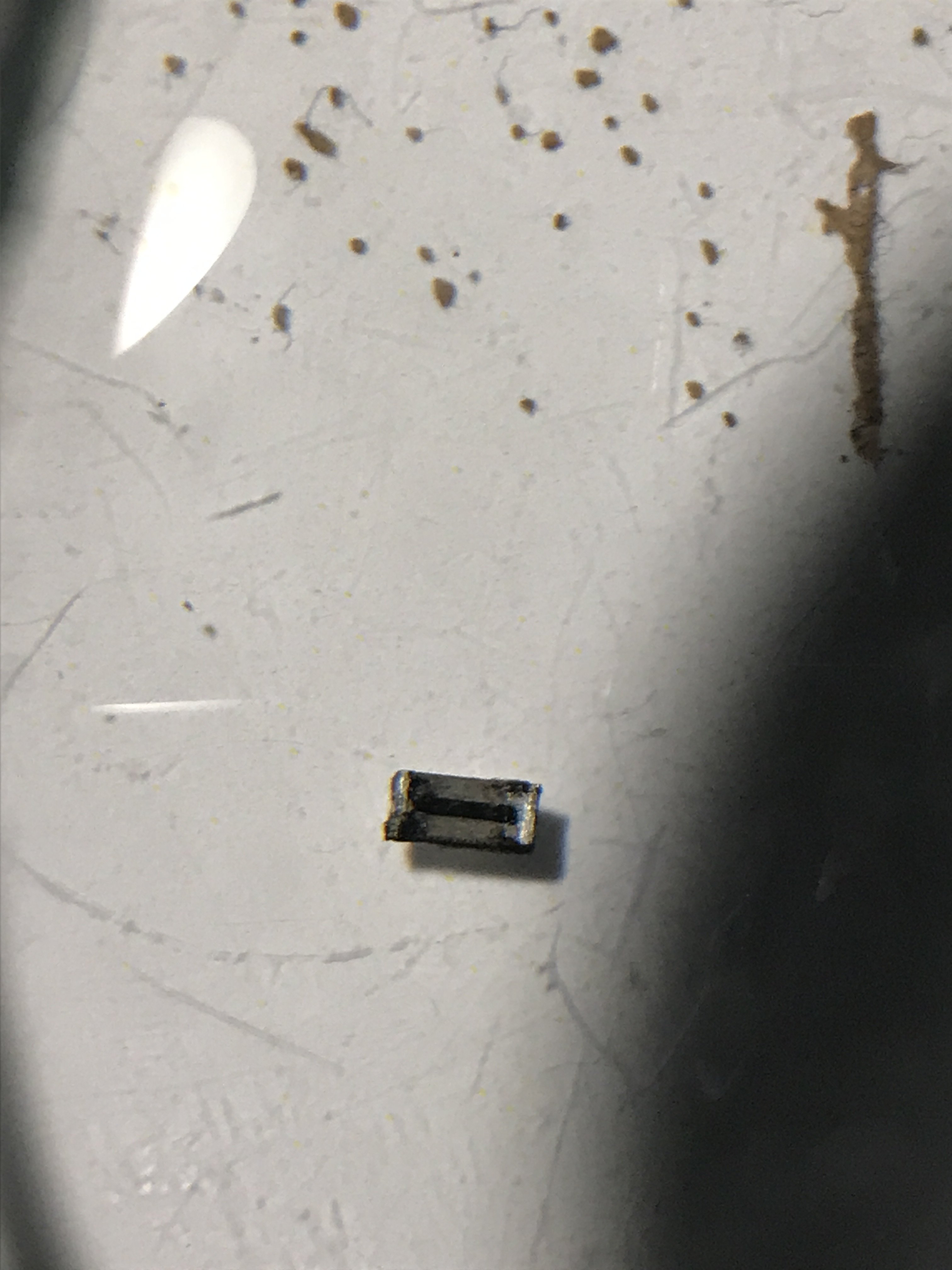

they are two equal components, they look like a capacitor but it has a black line in the middle, with the multimeter I measured it in capacitance, resistance, diode, continuity and I don't get any measurement. and I really have no idea what component it is and also what value it has

They are probably the capsule bias resistors - one gigohm or thereabouts, in a typical condenser mic.
You won't get sensible readings with most multimeters, they will read open circuit.
I cannot find a schematic for the NT2A, but here is one for the NT2:
R31 & R32 are the two 1G Ohm resistors, in that one.
I'd suspect the audio part is likely fairly similar, but yours has a CMOS IC as well - I'm guessing that is the oscillator and driver for the high voltage generator, with the IC and parts at the lower right quadrant of the PCB being the power section, replacing the lower left part of the schematic.

Some posts relating to that exact fault say it's often cured just be re-flowing all the soldered joints on the circuit board.
(ie. heat each joint and apply a very small extra amount of flux cored solder).

One question, I saw a video of a man who checks the ic with the multimeter in diode mode, basically the red clamp of the multimeter on the negative leg of the ic and the negative on each of the legs of the ic, and today I made that test on the CD40106 ic, and on all legs except number 9, could the ic be damaged?
this ist the datasheet
What are the voltages on the two points I've marked, relative to the XLR ground pin? There should be tens of volts on one or both.
If there is, the IC is OK.
It does not have to have the capsule connected for this, if it is presently detached - just the XLR side with phantom power.
