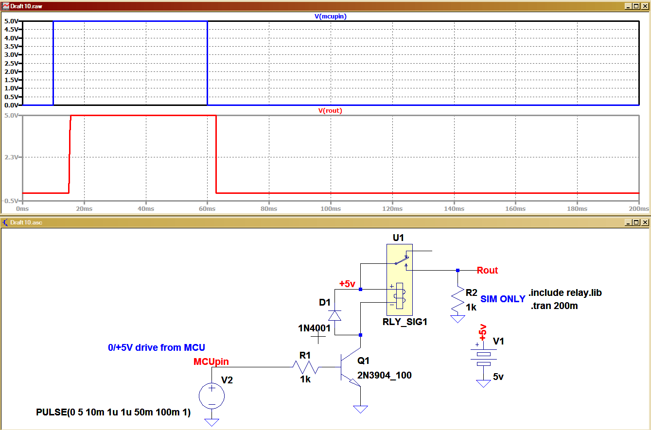

Hi everyone. I'm using a Takamisawa RY5W-K 5V DC relay. what do i need ? and i'm using a pic18f4520 microcontroller.

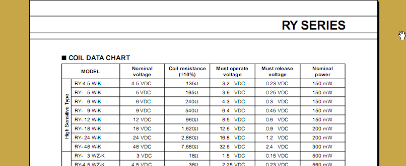

The relay coil resistance is 165R at 5V , ie 30mA.
The max current I would draw from a PIC is 20mA, so you will require a transistor driver.
Do you need help with a simple circuit.?

Optional circuit.
You can easily do your own spice sim. If you haven't got a sim model for a relay just use a 165Ω resistor in series with ~100mH

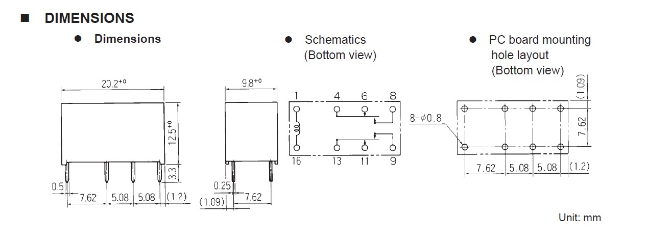

so Rout connect to Microcontroller chip or the MCU pin?20111227212510439.jpg i dunno how to differentiate which pins of the relay is the switch
Use pins 8 & 6 as a normally open switch.

I don't understand the difference between microcontroller chip and Mcu pin here. The Mcu pin IS the microcontroller chip interface.
V2 is the 5 volt DC voltage used in place of the mcu to test the spice model.
so what pins of the relay is connected to Rout and positive of the coil?
