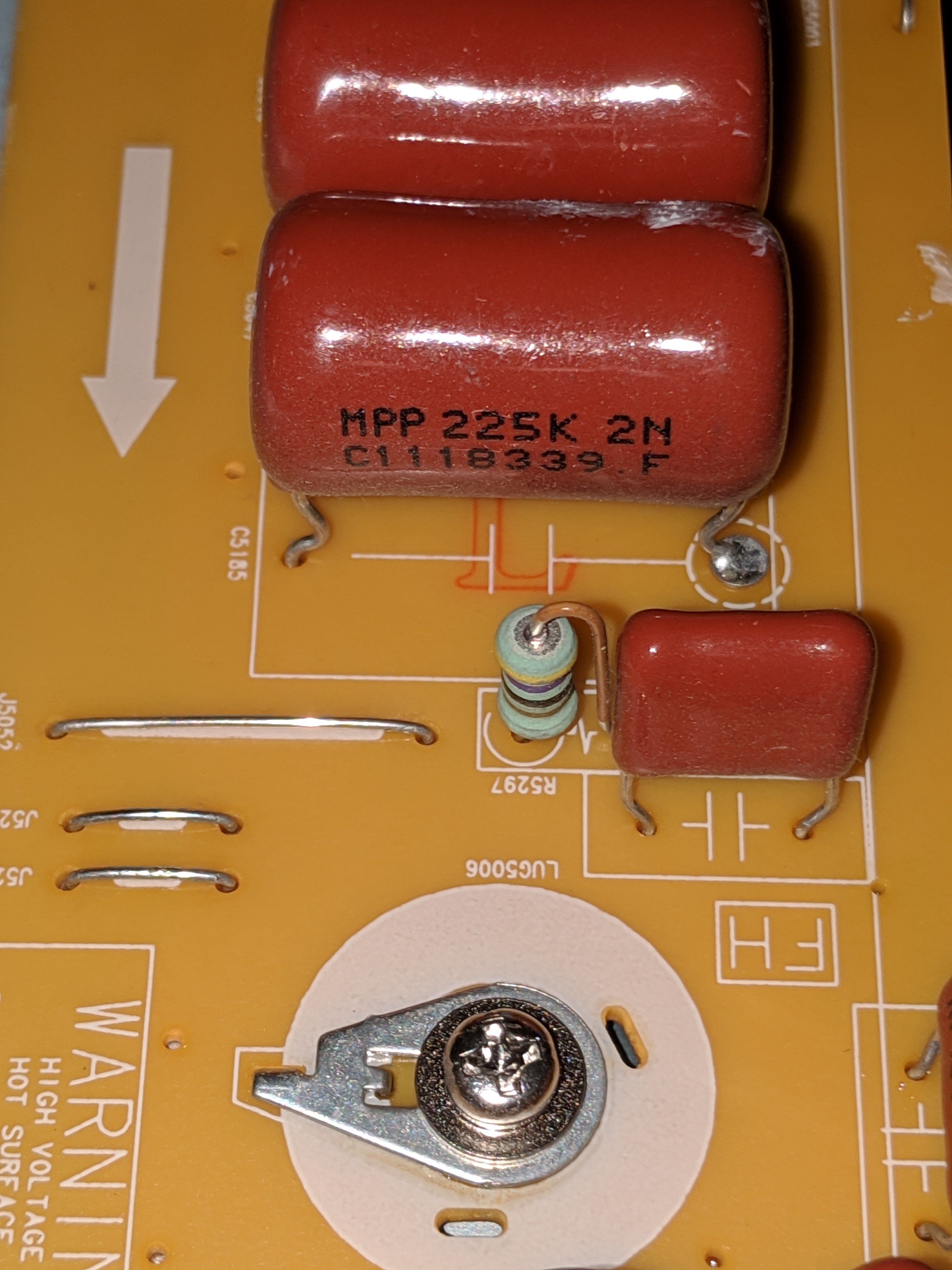

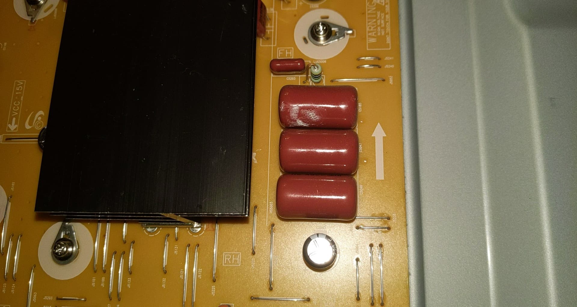

A capacitor in the family samsung plasma tv blew out last night (turned on for the first time in a long while) and I'm having trouble deciphering the code on the failed capacitor. Here's what I have so far:
Printed on the Capacitor: MPP225K 2N C1118339.F
MPP: Metallized Polypropylene Capacitor
225: 22*10^5pF = 2.2uF
K: +/- 10% Tolerance
2N: related to voltage? The "N" doesn't seem to match any charts that I've been able to find.
Beyond that, I'm completely lost. The tv model is PN51F5300AFXZA. All I need is the voltage and then I can order a similar replacement, if not the exact piece. Any help would be much appreciated!
I've attached pictures of the capacitor failure as well as the labeling on the side:
