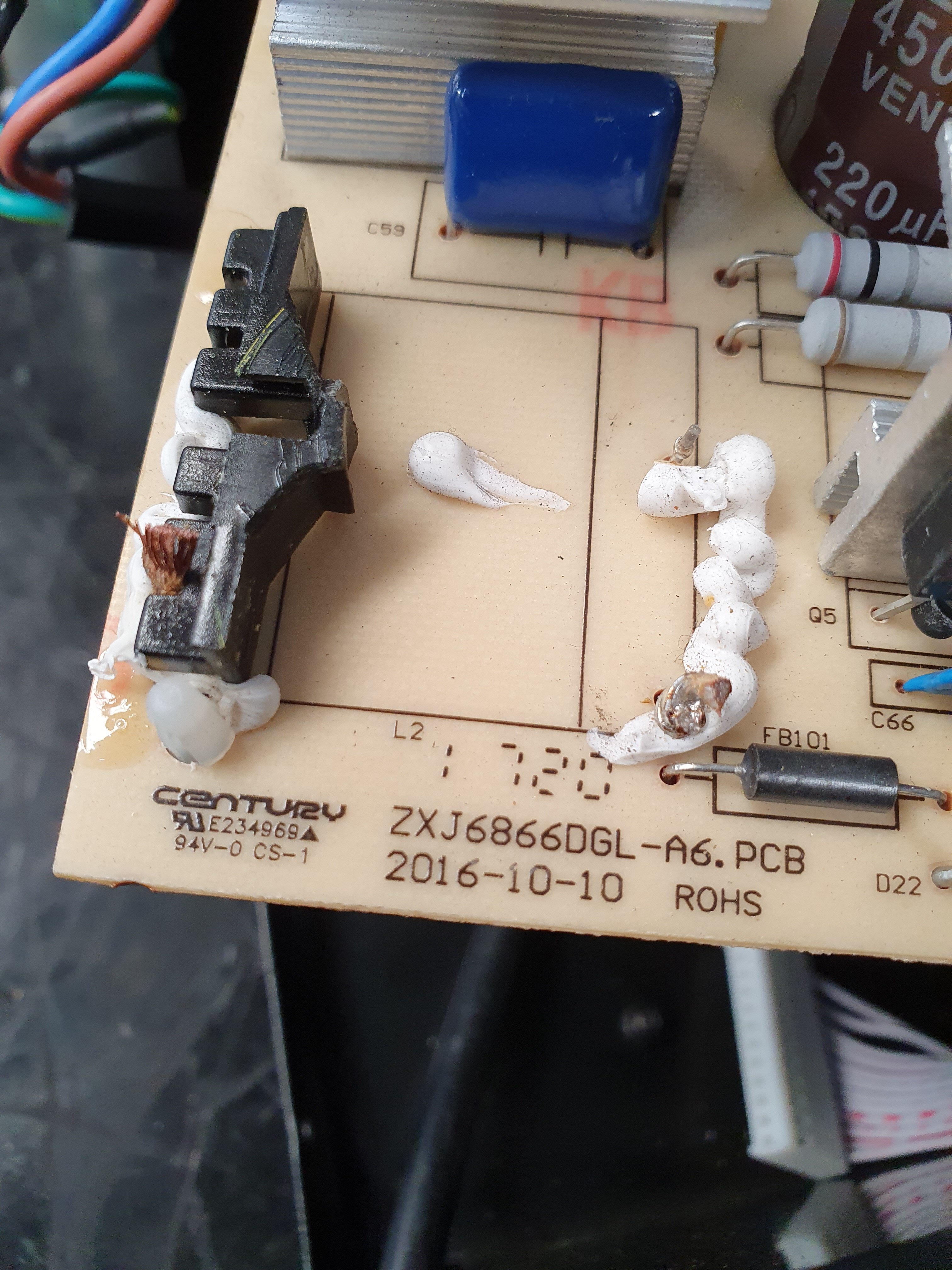

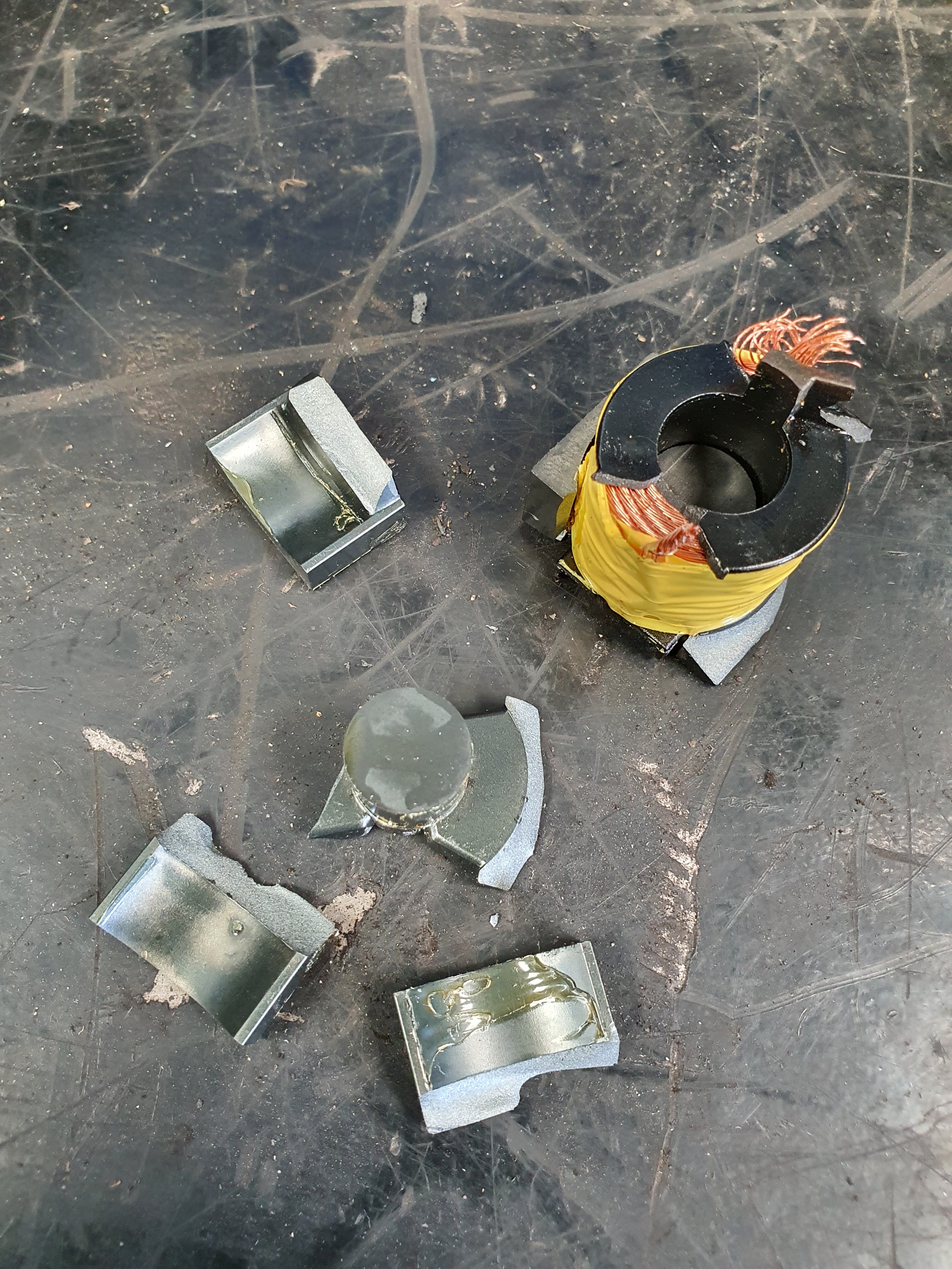

I am repairing a battery charger that was dropped. I found this transformer component broken off the PCB when disassembled. I am having trouble identifying it and sourcing a replacement and wondered if anyone could help.
I removed the yellow tape In hopes to find a part number ant it fell to bits and no luck.
It also only appears to have 4 pins soldered to the board.

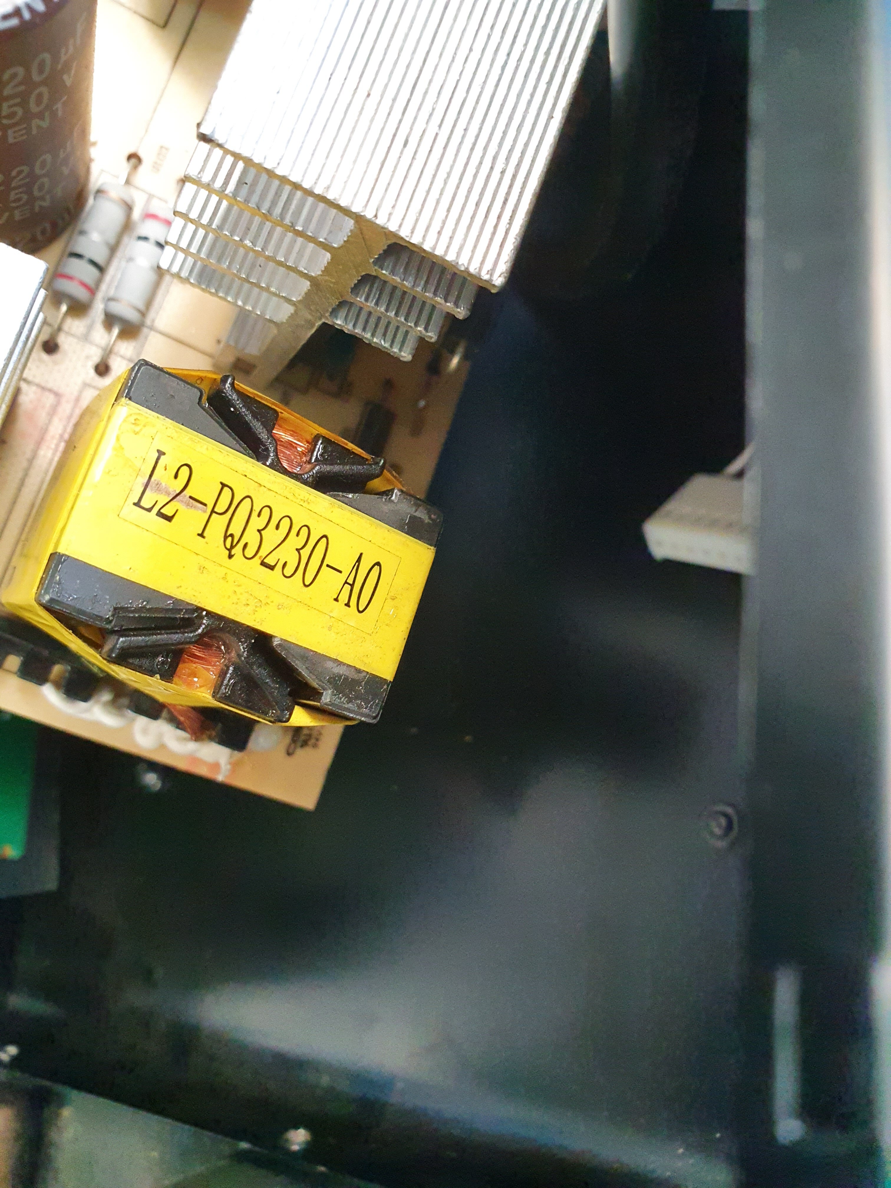

PQ3230 is a core used in tranformers and inductors. The braided wire on the bobbin in the second photo makes me think it's a high current choke. Can you post a photo for the back side so we can see how the pins were connected?
The top right pin of the component appears to have a thin wire soldered to it, and presumably the top left (out of sight) also does, this led me to presume it's a transformer.
But as you say, a picture of the rear would help to clear it up.
On the last image, the silkscreen designation shows "L2" next to the damaged component.
But you are correct, there are three visible terminals......... but perhaps one of them is for mechanical stability only? Difficult to know.
As mentioned previously an image of the board's rear would significantly clear the confusion.
Not just a pin, but a pon that appears to have a thin wire soldered to it.
Yes it would, but it really makes no difference anyway (other than for our personal inquisitiveness), as regardless it's a custom device and won't be available as a spare, as pretty well all switch-mode transformers/chokes aren't.
