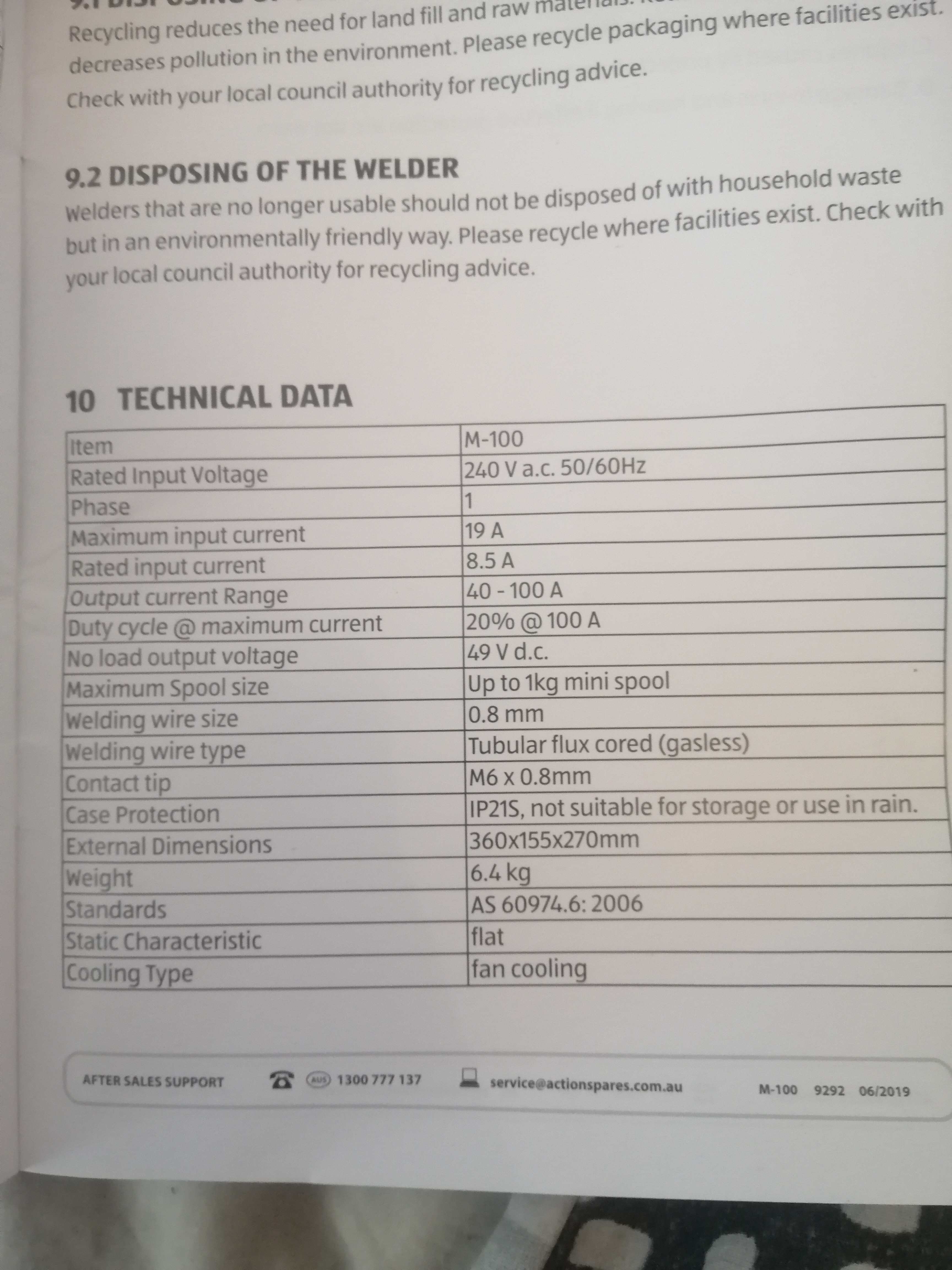

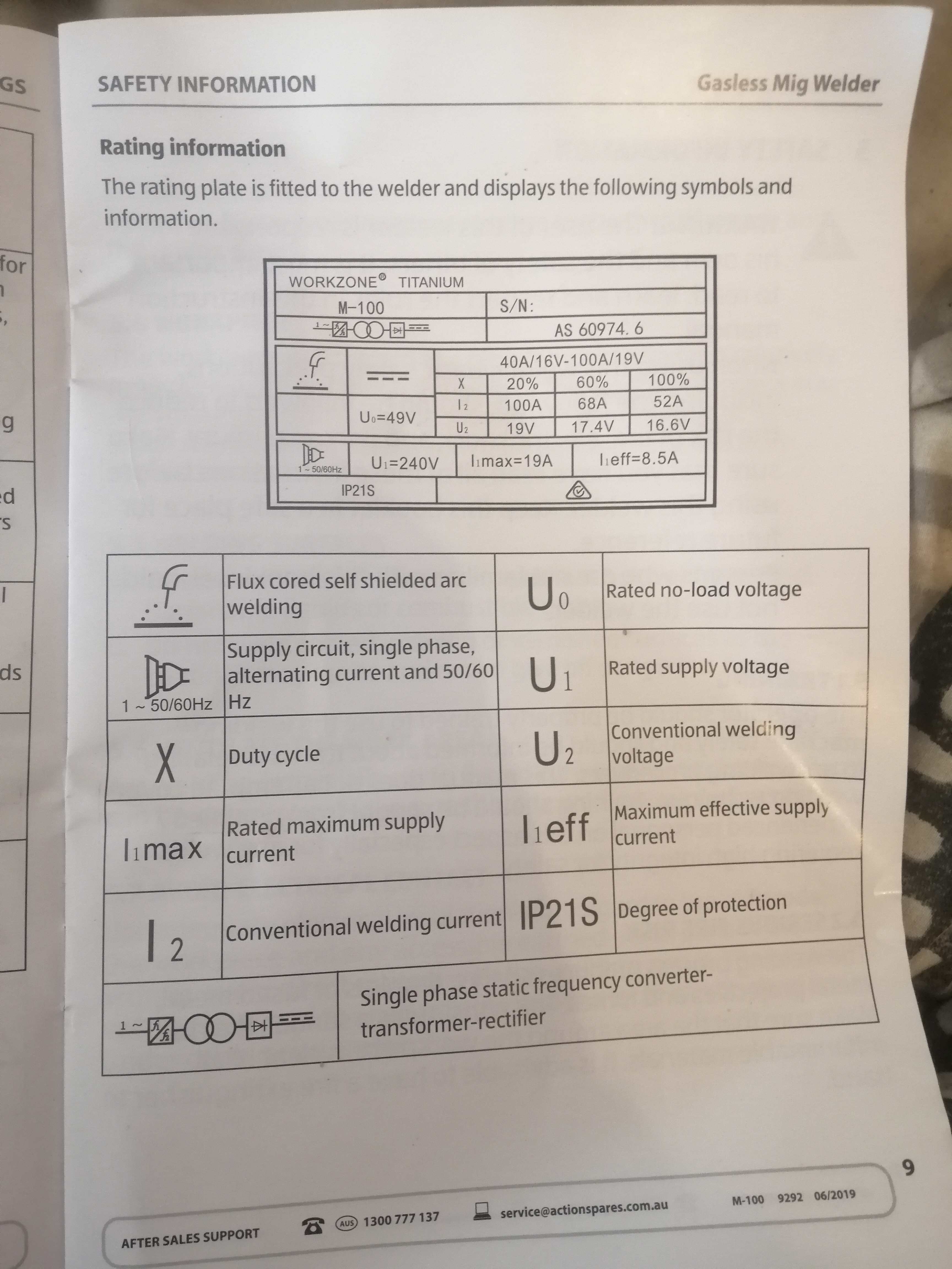

Hi, just wondering if anyone could help me identify whether my welder welds in ac or dc. Please refer to picture below.
Welder is a workforce m100 gasless mig. Thanks in advance!

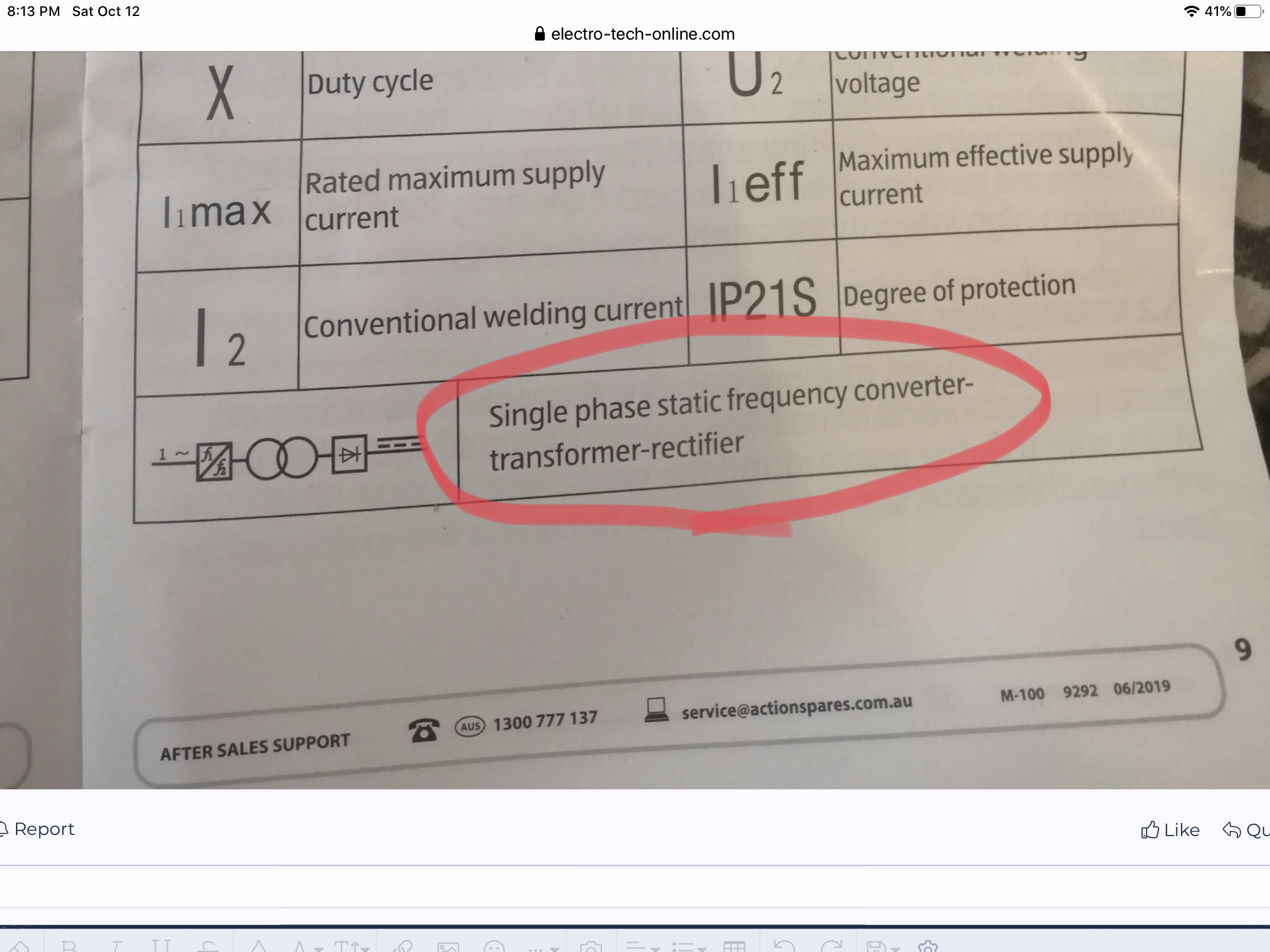

It looks to me as if a transformer brings AC line voltage down to operating voltage with a transformer and the lower voltage AC signal is rectified with a single diode to make a "pulsating DC" current (I.e half-wave rectified).
They mention a No Load (Open Circuit) voltage of 49 VDC and while welding was not my area all of the large MIG and TIG welding systems I worked with were DC machines. So in this case DC has my vote.

The straight line with dotted line underneath means Dc, also to the left of the red circle gophert drew there is a diode symbol, depicting a rectifryer, so your weld set certainly is Dc.
Other things you can do, an Ac weld set would show very little voltage with a multiometer set to Dc, but full 50v or more ac voltage set to Ac.

Thanks guys, there just seems to be soooo much spatter that I thought something might be wrong in regards to polarity.. obviously its just not the most efficient process haha.

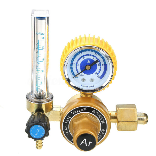

My reg was only £12 from ebay and the 10L gas bottle, from a local supplier, is £50... £30 of that is deposit... Its a no brainer as 0.9kg of flux wire is the same price as 5kg of copper coated steel wire..
