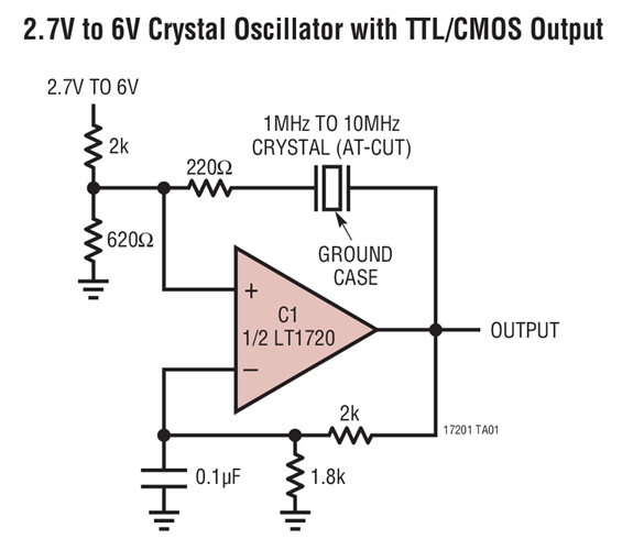

At this point I'd say that the best solution would be reusing the existing crystals for the reasons you mentioned. I found some schematics online, but obviously the supply voltage is always at least 5V, while the battery that they had is a 1/2AA NiCd, so 1.2V. I was exploring the possibility to use a different battery, but I'd like to keep the same ones so I can reuse also the charger.

That should run the 5MHz crystals OK.
If you are going to refurb this, I would take the opportunity to update it and use 3.7V LiPo packs.
You can get small flat ones with enough capacity to run for a day in this application that would easily fit in the space.
It would then only be a case of adjusting the resistor values slightly to make your circuit above work reliably at the lower voltage or there are op-amp circuits that will do the job.
Here is one example from Analog
Oh, thanks a lot!
I'll try to simulate in LtSpice the transistor solution since it would be the cheapest way.
One last question, do you think these solutions require an additional amp stage or I can connect an antenna directly on the output?
Thanks.

That should give you an idea of what power output might have been - at a 1.2V battery supply, it wouldn't have been much and you also don't want too much signal otherwise it will trip the detector before it reaches the timing/finish line.
I would start by connecting the antenna direct and see if it works as it should and proceed from there.
