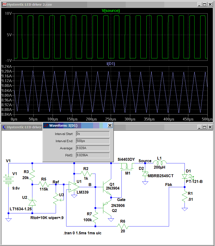

The simplest high efficiency circuit would be one with an IC controller similar to what Ron showed in Post #7.
Below is the simulation of a Hysteretic constant-current design using a commonly available LM339 comparator. The circuit should have an efficiency of around 85% or better with proper components. The inductor needs to carry 10A or greater with low resistance, the P-MOSFET should have an ON resistance of no more than about .02 ohms, and the diode should be a Schottky type rated for at least 10A.
The circuit is shown delivering 9A average to the LED. This can be adjusted by pot U3.
Edit: Not shown are the necessary decoupling capacitors of 0.1uF ceramic and 10uF electrolytic from the MOSFET source directly to the ground plane. With 9A current you need a board with a ground plane for reliable operation (done't even think about doing it on a solder-less plug board).
Edit 2: The hysteretic circuit below shows no current overshoot on startup (although voltage output versions of such circuits do).
