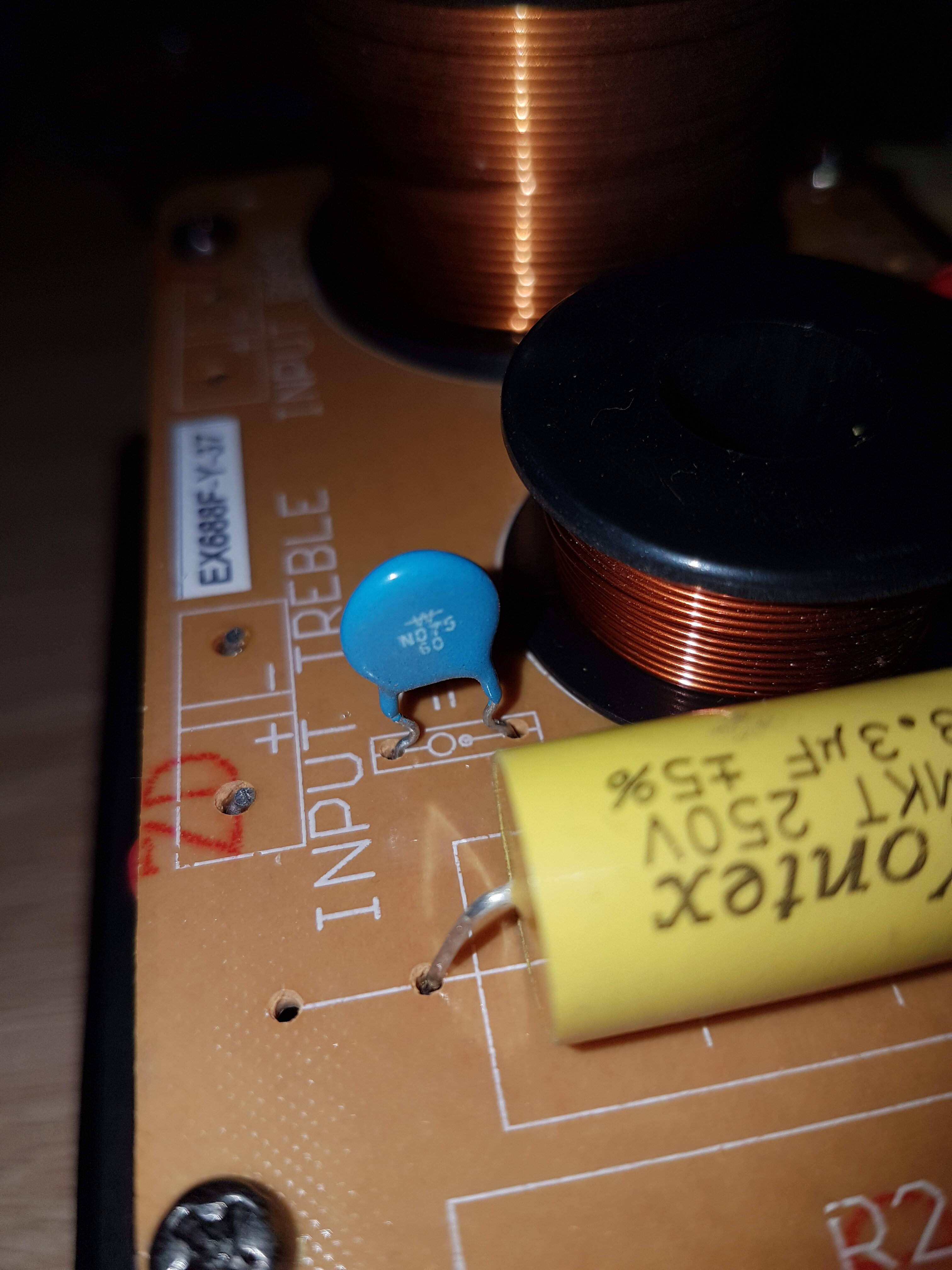

Trying to identify the blue component in the picture to find a replacement.
Something like this?
However, I take it you are aware that they aren't absolutely needed (and most speakers don't have them), if they have blown you could simply short them out, temporarily if you like, to prove everything works OK.
But it might be an idea to find out why you blew them first?.
Hey, thanks for the reply and yeah that looks like the part. I get some intermittent crackling or pops but not very often. It happens with multiple sources, tried different cables such as toslink and rca. Happens with 2 different receivers and now an amplifier 2 of which are brand new. So I'm sure it's the speakers themselves. I have already replaced the capacitors with new Audio grade dayton mkp 250v 3.3uf capacitors and still same issue is occurring. I have replacement 7W1RJ resistors for the crossovers but have not replaced them yet so once I get these thermistors and some new interna speaker wire I will have replaced the cheaper parts and hopefully have resolved the issue.
The speakers are about 20 years old I know that is not that old for speakers but just trying to save money if I can. I don't have the equipment to test these components and they are cheap either way, I know you said they are not necessary but can they be replaced with higher quality ones? The link you posted seems to have similar values so I'm guessing they would work? Please keep in mind I have only looked into this stuff for a couple of weeks lol I'm a newbie.

I doubt this component would be causing your issue but If you want to test it then try removing it and see if the problem(s) your experiencing gets better, worse or the same.
Also the truncated drivers I found are 8ohms so I'm guessing I would have to replace the tweeters and crossovers also and by that stage I may as well buy a new pair of speakers.
If I remove the component without replacing it would I have to bridge that connection with some wire or something?
Also with the speakers doing this could it potentially damage the amp? I'm new to all of this, only started looking into all of this two weeks ago, I work in IT with no electronics experience.
Yes, bridge with a wire. You'll have to solder it for best results.
