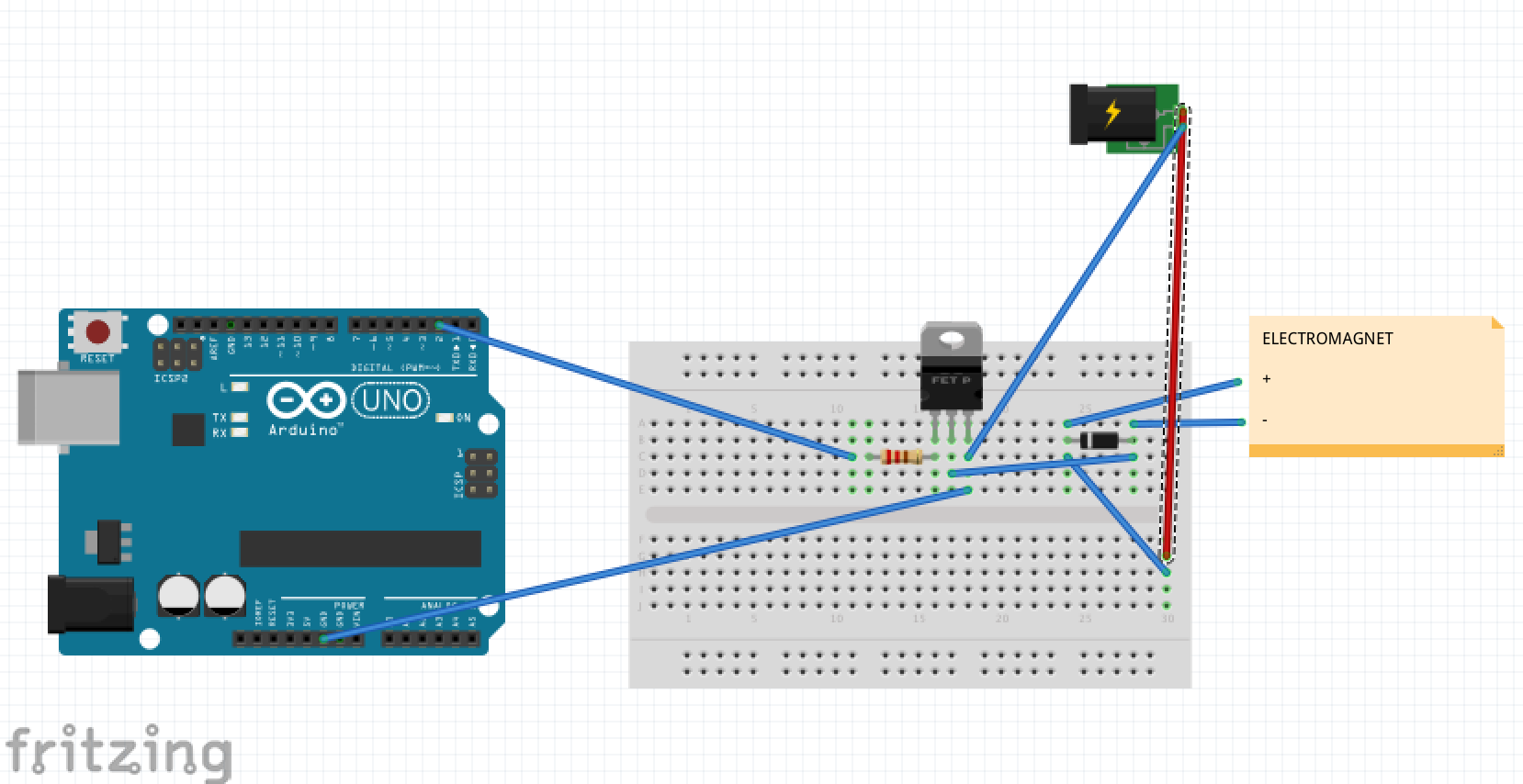

Hello everybody,
I am trying to power a solenoid magnetic coil with a 12 v battery supply that is regulated by Arduino digital pin. I am using a N-MOSFET TO247AC however my current circuit overheats the composition. New to electronics I am not sure wether I have it wrongly wired or possibly using the wrong type of MOSFET.
A look at the diagram and any suggestions would be very welcome!

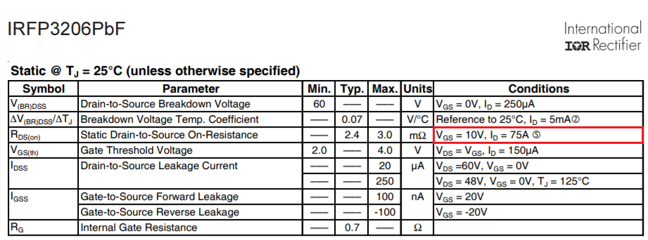

TO247AC is the transistor package type, not the MOSFET type. Importantly, which MOSFET are you using?
Aha, it makes sense now. So I'm not using a MOSFET at all. Would TIP22 be a more applicable component?

It was my understanding that TO247AC is a N channel MOSFET. If that's not the case then I'm not using a MOSFET at all.
TO247AC is a package style, just like TO220 and SOIC-8 are.
You need to provide the information which is marked on the package....
Those are specs, not the device part number.
That MOSFET looks good for the job. If it happens to have a Vgs threshold at the 4V end of its specified range and the current through it is more than a few Amps (which we don't know, since you can't state the coil resistance) then expect it to get hot. Breadboards are not designed to handle several Amps, though, so perhaps heat is being generated in the breadboard's conductive strips too.
It is worse than overheating, it exploded. I'm not sure if breadboard's strips can generate so much heat...

Are you running the arduino at 5V?
You need a logic level mosfet, the IRL540 may be suitable but it depends on the solenoid.
You could also use a mosfet driver but that requires another chip.
Do you have a flyback diode across the solenoid?
Was thinking the same thing, because there is no Vgs=5V in the Rds parameter:
If the MOSFET is not fully turned on, i.e. the gate voltage is between Vgs(th) and 10V, it's generating heat, correct?

Right, thanks a lot. I assume that I would have to test the logic level MOSFET. Yes, I used a flyback diode.
For description it's a 20cm electromagnet with an insulated copper wire that I'm trying to power.

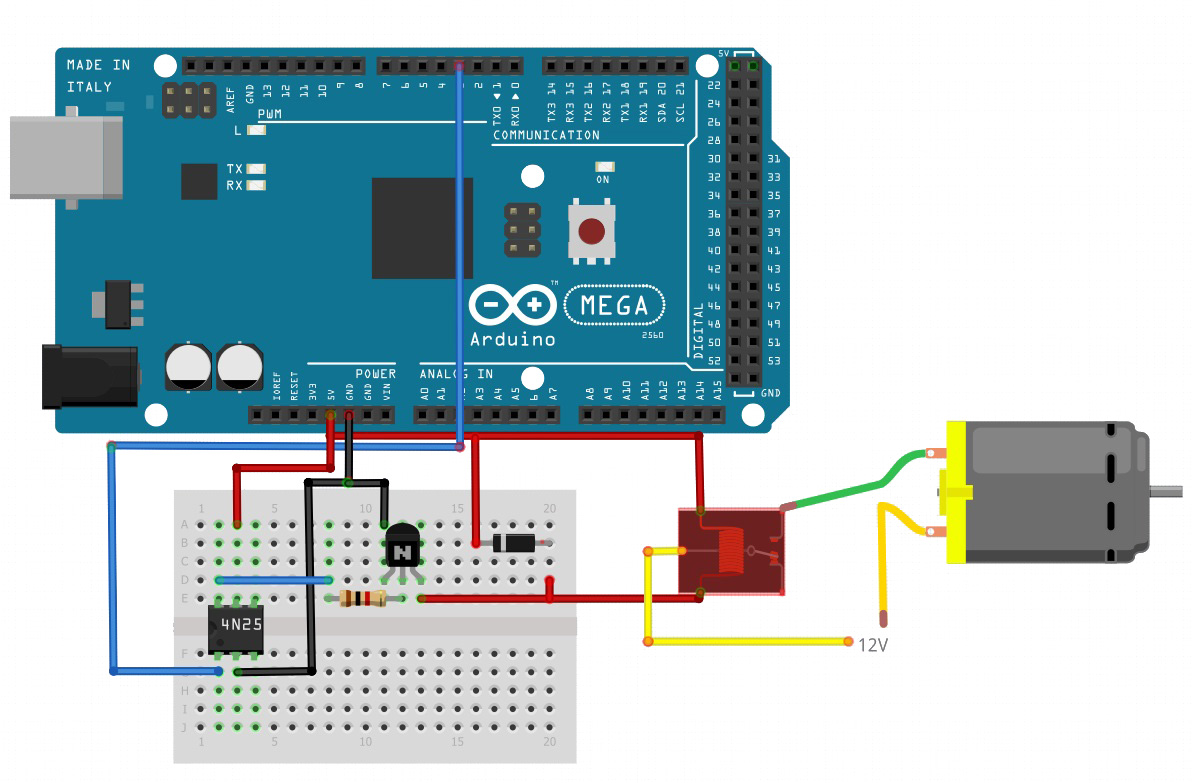

However, what I wonder is if using a relay + Optocoupler could be a solution.
Here is a scheme, not my own, but it looks like it could be an answer.

If this is a DC electromagnet for attraction to ferrous metals, you generally need a reverse polarity shot to demagnetize and release.
