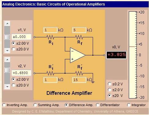

Enclosed the schematic I think I'm working to, based on information provided by Eric. Does the 2 resistors between + and gnd effectively provide the virtual ground you are referring to?
Yes. BTW, that op-amp needs to be one that allows input signals very close to ground like an LM358. Your bias point will only be 0.68V above ground, and many op-amps won't allow it.

OK. I've set that up. Across the input I'm now only getting 0.5 to 0.6, yet when I split the input from this circuit it returns to giving me 0-0.68. Across the output I get 0.1 to 0.6, so inverting but practically no gain.
Am I being dim now? I've checked that my resistors are as per the schematic, the input voltage is 9v. The sonar returns 0-.68v when on its own.
Are there any voltages at different points in the circuit I can test to find the error in my ways?

Sounds like you are loading down the source. maybe you need to use higher value resistors looking into the inverting input of the op amp, adjust feedback resistors up to keep same gain. The inverting input is a virtual ground so the source is loaded with the input resistor to ground.
Try making R4 a 10k resistor and adding a 30k (?) resistor in series with the gain trimmer P4. Tweak that 30k resistor's value up or down to get the gain you need centered on P4's range of adjustment. I can't tell from the schematic what gain you are trying to get.
I think you may not realize the op amps output signal will be referenced to the virtual ground point which is NOT GROUND, it is pin 3 of the op amp. The virtual is about 0.68V. So, when the input signal is 0.68V, the op amp sees "no input signal" and outputs zero volts with respect to the virtual ground, which is 0.68V with respect to ground. As the input signal goes below 0.68V, the op amp is receiving a negative going signal and inverts it giving a positive signal but the gain is with respect to virtual ground.
Your meter must be referenced (have it's negative side connected) to the virtual ground point to read correctly.
If I increase the resistance between inverting ground and output to about 30k I can get an output range of 0-3.5v! Which is nice.

I think I may be nearly there. I've now got the MaxSensor to output 0-.68v when on its own, and an op-amp circuit ased on Eric's information to take 0-.68v from a POT and output 3.4v to 0v.
However, when I swap the POT over for the output from the Maxsensor, although according to my multimeter they are giving the same outputs, the OpAmp will then only output 0v to 0.7v, and both the input and output seem to be doing a lot of oscillating on the meter before settling on a voltage.

To see whether the circuit works, I used a pot to divide a 5v supply so that I could simulate a Vin range of 0-0.68v. Doing this, the OpAmp circuit works perfectly, and is set up as per the attached.
However, when I remove the Op Amp and replace it with my actual meter, which I separately check is also showing the above voltage range on a multi-meter, I get a completely different response from the Op-Amp. It's as though the Op-amp is clipping my input at anything below about 0.5v, even though I know it works when providing that low voltage via the POT mock-up.

Thats not the same circuit as the circuit I posted.???
I will look it over, but have you changed the inputs and component values.:)

I'm powering the OpAmp at 9v single supply, so went back to your original values before you updated them to 5v for me.

And is the opa a 741.?
I am going thru your cct on the LTspice sim.
