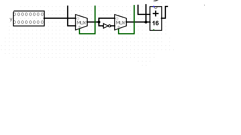

Hello, please can somebody help me this circuits cpu to connect with display and keyboard
The ALU module has three, 16 bit bus connections and about eight individual control signals.
If you think it has 200+ connections you still have very serious misunderstandings of how such things work.
there 4 MUX 18 pins so 4 * 16 = 72 wires so 16 inputs to ground, 16 input to input, 16 ouput to to inverter ..
after 4 INVERTER 14 pins 4 * 14 = 56 wires ( so i use all six inverters i mean i need it four inverter in chip and there are six inverter)
so 16 output to MUX
after 4 MUX again the same 4 * 16 = 72 wires so 16 Iinputs to output of inverter, 16 inputs to output of 16 output of first MUX, 16 output to 16 input
of 16 input of full adder
and FINAL fulladder chip 16 pins 4 * 16 = 72 wires so 16 input to 16 ouput of SECOND MUX, 16 input must connect in future and 16 OUTPUT FOR FUTURE but i think there is no future
where are the VCC GND SELECT STROBE wires
so in total 72 + 56 + 72 + 72 + 272 wires
right?

Wrong...
Two 16 bit input busses - then the rest of the connections are directly between components on that board, no external wiring until you get to the 16 bit output.
Plus half a dozen individual control signals and ground / power.
As I said, you seem to misunderstand the basic concepts.

to beter understand me, I did this piece, whats wrong i did?

Show a picture of the electronics on that board with all the wires ......

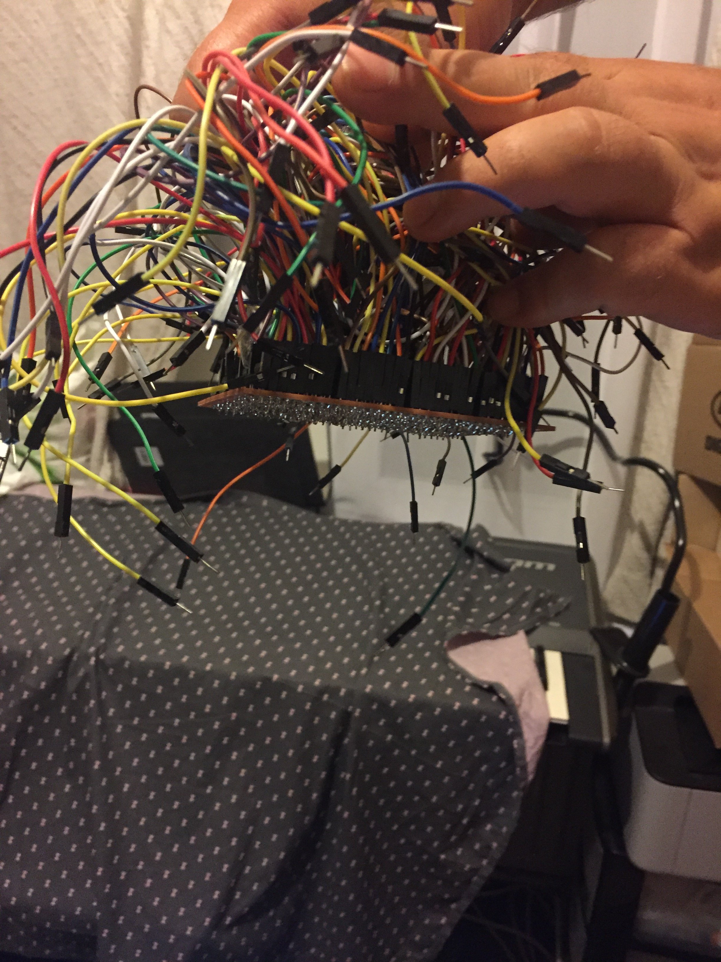

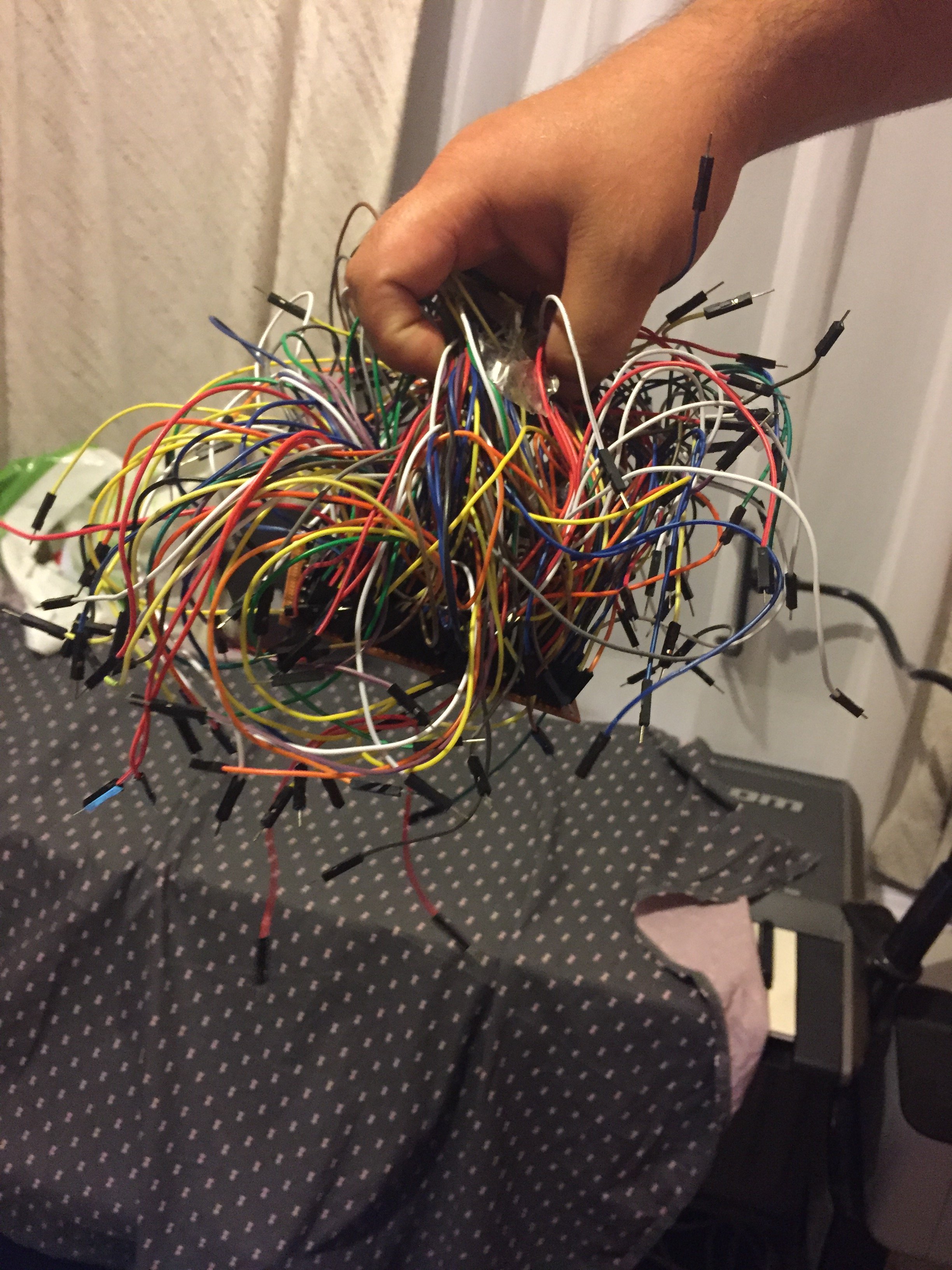

Building the whole ALU module on one circuit board would have taken less space than splitting it and adding all the wire links.
It's not normal to use jumper links with pin terminal ends for soldered interconnections, just normal wire stripped and cut to length as required.

I asked for a photo in post #2 for a reason.
