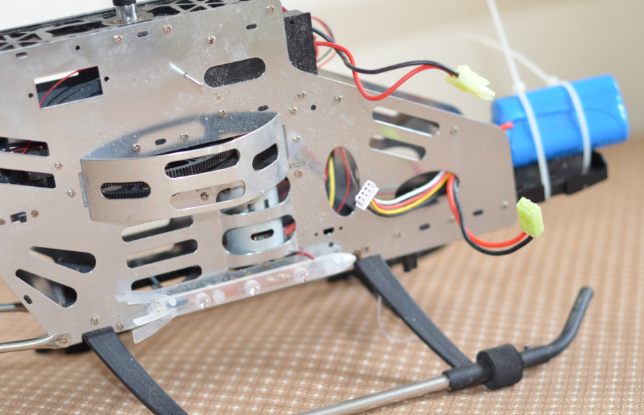

Part 1 (this) is a little back ground information on what I know, and some details on what I intend to do with it. First a picture (rubbish one) of what is left, I have yet to find the radio control unit, this was lost while moving but is here 'somewhere'.

After flying both I know the motors have plenty of power, the main rotors are driven separately in opposite directions from one motor each, I am fairly sure the motors are brush less, there is also a tail motor that I am sure just gets the nose to drop so the helicopter goes forward, the battery pack is also as far forward as the body work allows.

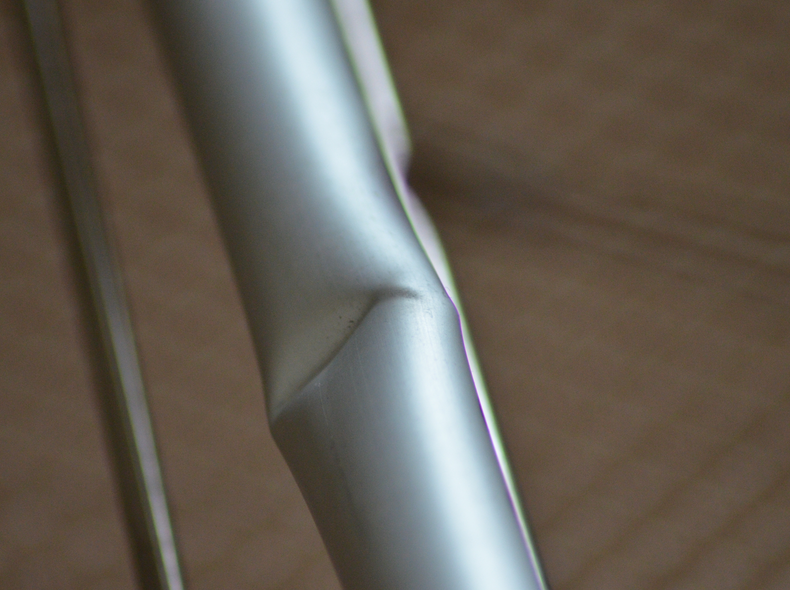

There is also a few repairs I need to make including a bad bend in the rear shaft, I have straightened it as much as I can but really it needs a new one.

The motors, which drive the counter-rotating rotor blades, appear to be brushed DC motors. See 1st image in post#2, you can see the pressings which hold the magnets to the motor casing. Just a little heads-up.
Incidentally, from that image it looks like the motor is a face looking out from some sort of imprisonment.

FYI, you are correct about the motor on the tail. It's purpose in this application, is to pitch the airframe for forward and backward flight. The yaw is controlled by adjusting the counter-rotating blade speed, with respect to each other.

I thought about the motors being brushed however there is a pcb on the bottom of each?? I am sure your correct, however untill I can take it apart to get a proper look I cant tell. If your correct (I have no reason to doubt you are) then I have learnt a great way to tell the difference .

The main drive motors look like regular brushed permanent magnet motors with a board mounted to the power leads to hold noise suppression caps.
