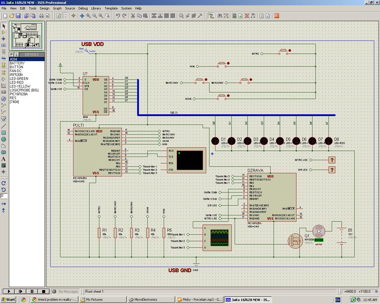

Hello.
I have made a small project in Mplab IDE on 16f628a and tryed everything in Proteus ISIS. Everything works fine but when I build everything in reality, when I press 'n' on PC, i.e. RA0 is set and motor starts working for maybe 0.2 sec, then is suddenly stops, but pic isn't reseted, becouse CCPR1L is kept on same level. P.S. I have used Breadboard for my project, hope this doesn't make any problems. I attached .asm files, and ISIS file, and here's schematic:

I have selected _MCLRE_OFF which means that I use MCLR like a ordinary pin

In your post it's floating. Your not using it. as any thing? That can cause reset......... when the chip starts. And what your saying looks like it is resetting.
no, no, I have set MCLR pin to be used as a normal pin, I have disabled MCLR reset. from datasheet: MCLR: When configured as MCLR, this
pin is an active low Reset to the device. MCLRE configuration bit sets RA5 functionality. btw, If I remove the 9v battery from circuit, everything works fine. so it's not MCLR's fault
Now we no. How are hooking up the 9 volts? Is it being regulated to 5 volts for the PIC? Or are you trying to run the motor with it.?
pin voltage is supported directly from PC usb cable and 9v battery is connected as in a schematic, it only tries to run motor. I have connected the battery's - (minus) part to ground.

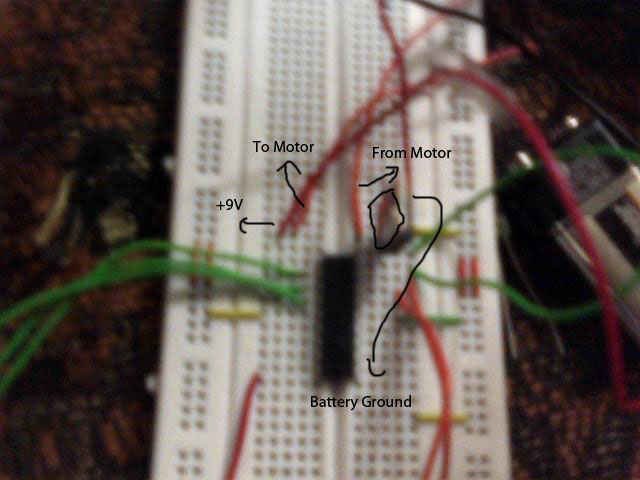

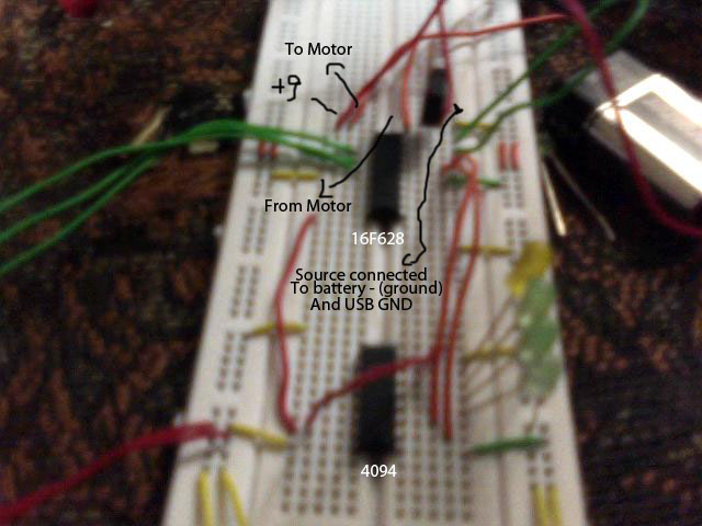

I haven't mentioned but I uploaded asm files, I have disabled WDT (_WDT_OFF), and anyway, when I remove battery from circuit, everything works fine! everything is OK until I press 'n', I think that when current goes through transistor, something happens, maybe ground potential is increaced or something like that becouse when I connect transistor GATE to ccp pin, when duty cycle isn't enough to run motor, nothing happens but when motor starts rotating, then ccpr1l suddenly inrceaces very much, maybe up to 100-150, then it suddenly stops or goes up to about 200
yes they are, it's hexfet irf530n, not motor, I mean, +9v---MOTOR---Transistor Source -- Ground which ground is tied to +9v battery ground
OK...is the negative side of the +5V supply tied to the same ground as the negative side of the +9V motor supply?

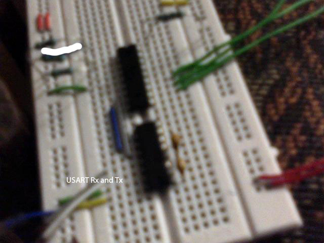

This didn't work ether :(

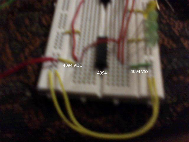

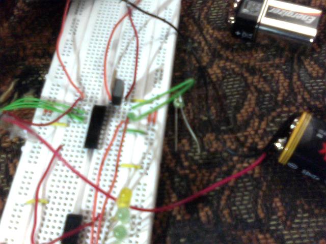

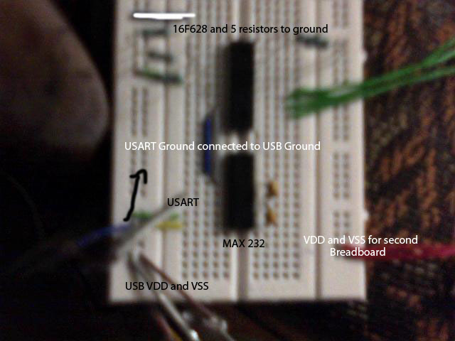

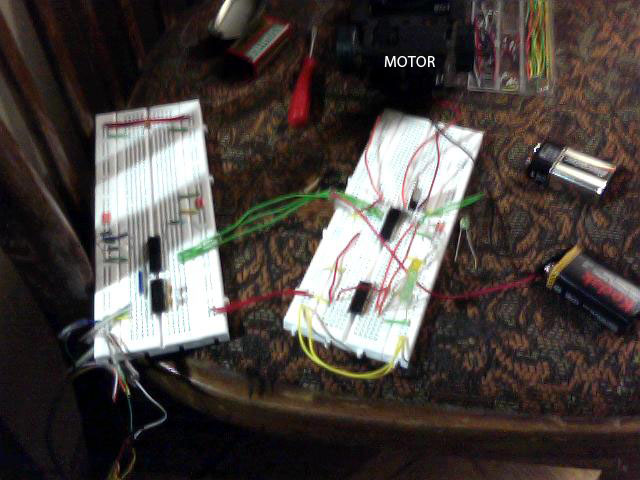

Take a look at pics

and I think that no reset is done, because on any reset CCPR1L is left unchanged and in my case, it goes to 0 or up to 150 and when I click w again, it jumps to 250..... or to 0
