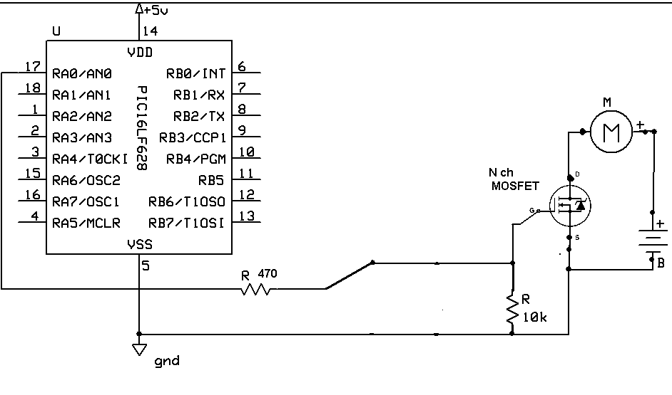

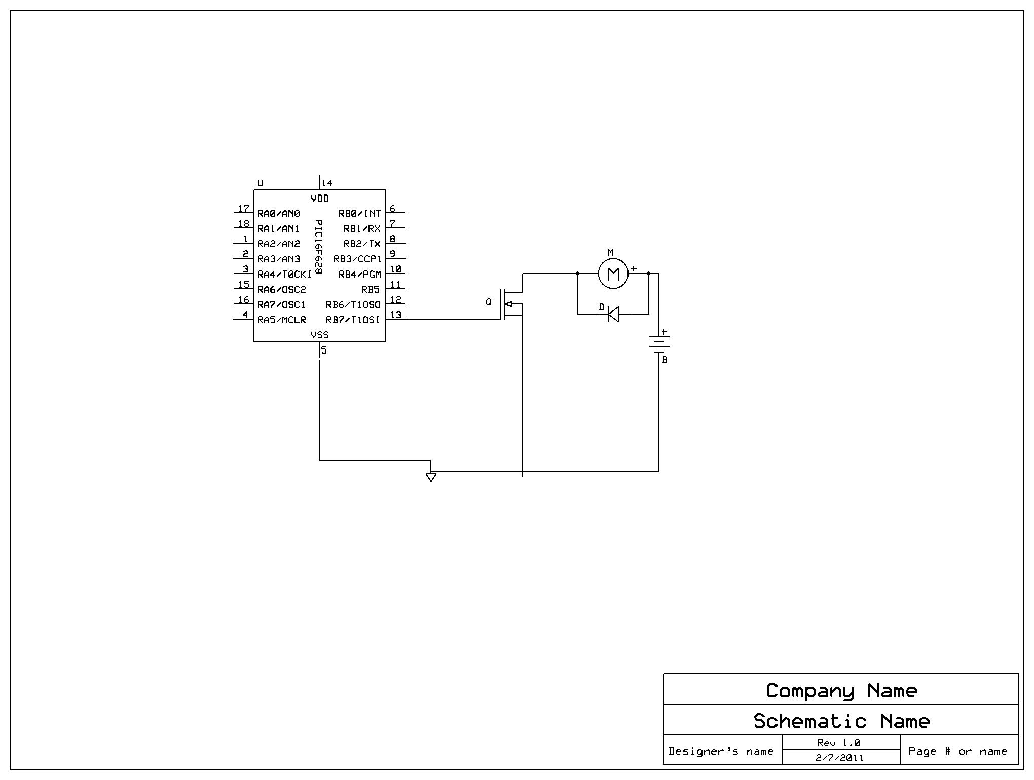

Here a simple one

Burt,
On your circuit
Check the bias current path from the +B thru the PNP forward biased diode and the clamp diodes in the PIC.???
eric I posted a short didn't I I did that totally backwards It wasn't even no ware near right.
See if this is not better

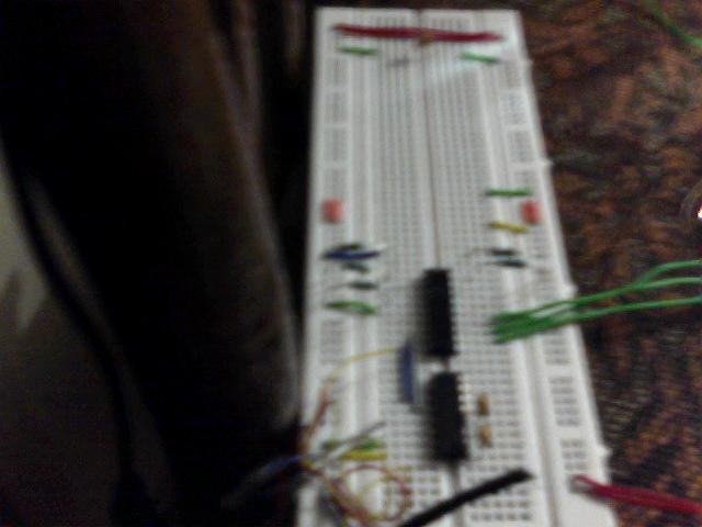

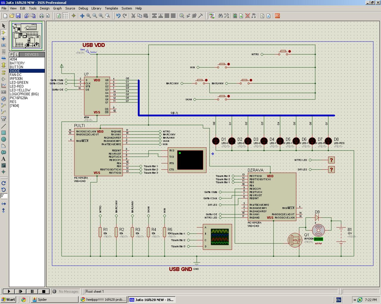

Hey I inserted resistance instead motor and everything worked fine! I think it's really EMF but flyback diode didn't help :( I inserted it as shown on figure..... why didn't it work? unfortunatelly I don't have oscilloscope to explore it

hi z93,
The diode is drawn the wrong way around.

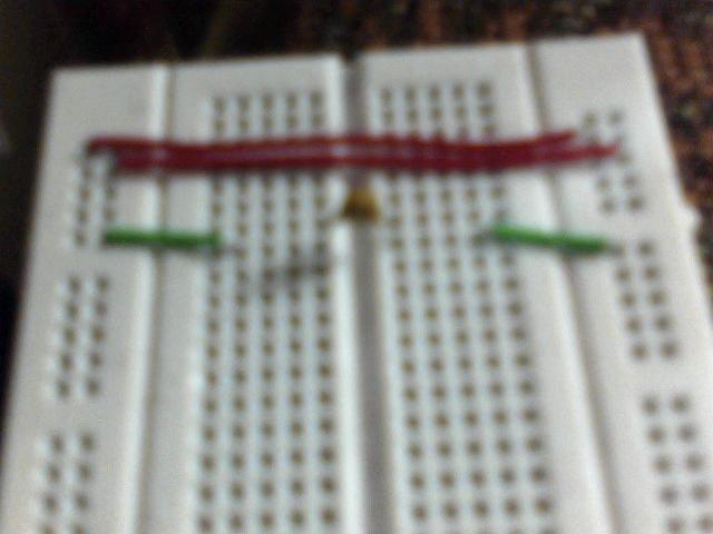

Oh yes I drew incorrecly, but in my project I inserted correctly, I'm lazy to upload it again so imagine that it's rotated by 180
here I uploaded them

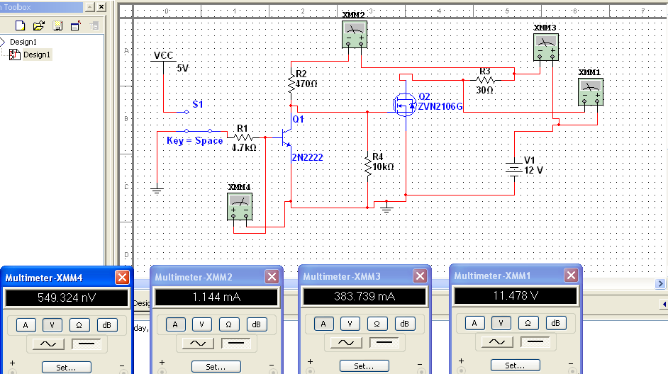

Metal–oxide–semiconductor field-effect transistor are voltage controlled. zhaniko93 is using one that's not able to turn on at 5 volts right. His 9 volts motor supply make's it a if'e it may work some time and may not. In Mulisims 11 it will not turn on with 5 volts at the gate.

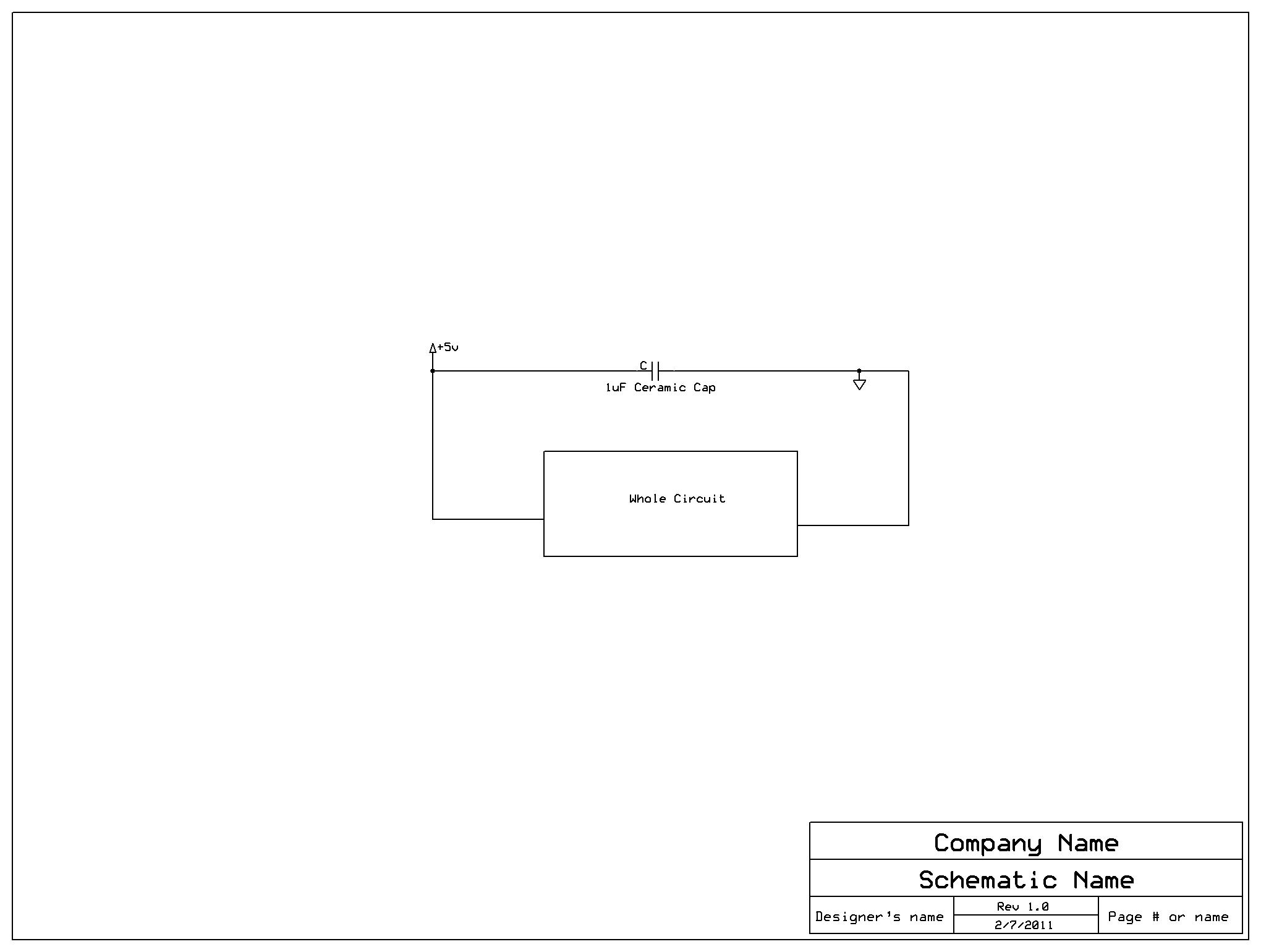

The decoupling you show on that diagram is far too little for reliable operation when driving loads.
Use at least a 47uF or 100uF and two or three 100nF, one located near the PIC
be80be
Gate Threshold Voltage MAX is 4V and why isn't 5v enough?
ericgibbs
I'll buy them. will electrolyte capacitors be appripriate?
