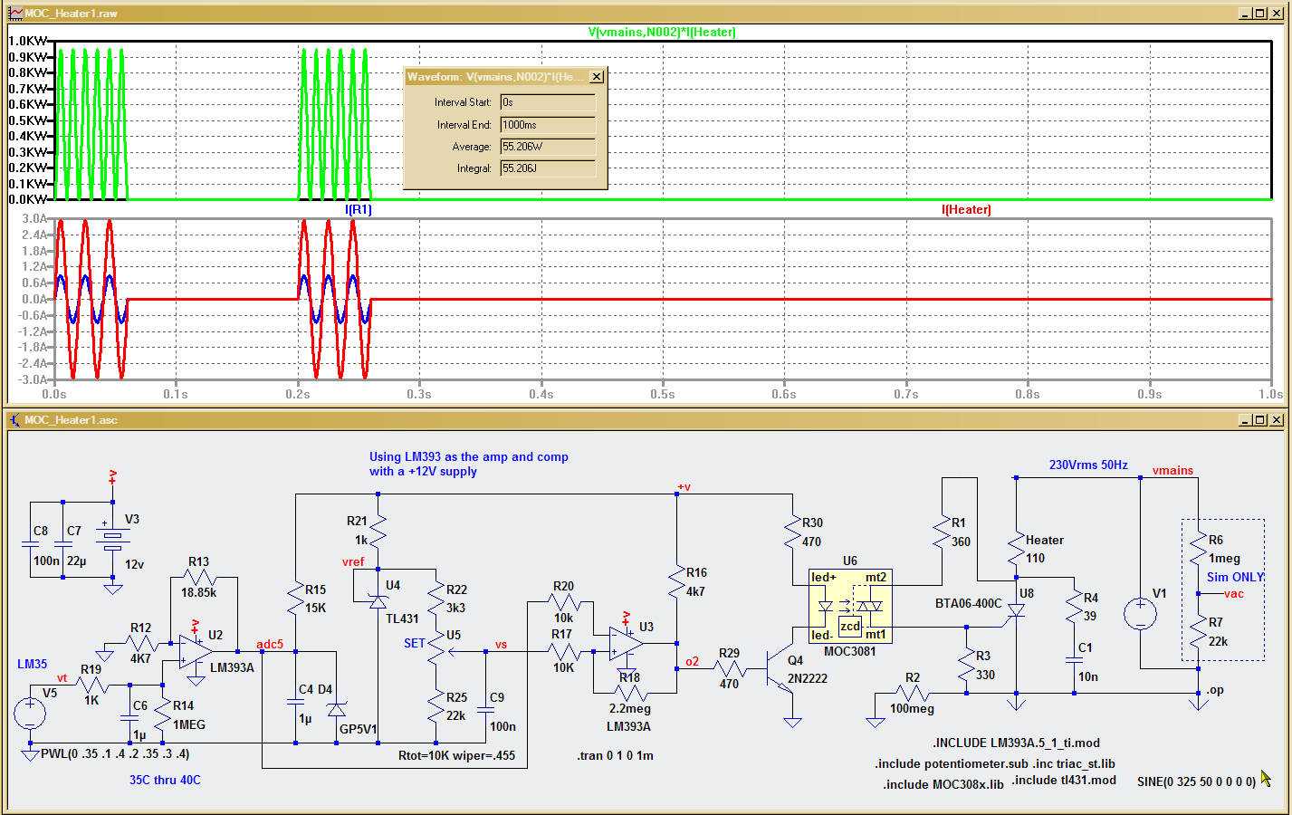

Its important to note that heat dissipation for most passive devices is quoted for a particular voltage and current flowing thru the device and is the Maximum wattage rating,
If you decide to use a 1kWatt electric fire spiral coil element and only power it on for say 10% of the time, then the heat generated/dissipated will be in the order of 100Watts.
I would consider using 'burst' control for the on time of the heater, it still should be switched on at the zero crossing point of the mains cycle.
So that would be when heating is required the element is switched on at the ZCD point and kept on until the required temperature is reached.
When the required temperature is reached, the element will be powered on for a few cycles as required to maintain the required temperature.
This 'burst' method will be easier to build than a PWM system.
If you use a temperature sensing device like the LM35 note the 'long-ish' response curves printed in the datasheet.
If tight temperature control is required chose a more response sensor.

As the heating coil has so little thermal mass the internal temperature of the incubator could easily be changed by changes in the external temperature. I would suggest the heating element heats a aluminium block with a sufficient thermal mass that would reduce the effect of external temperature changes.
thanks for that eric, the sensors are DS18s20's (4 per incubator) and a sensiron sht71. the control unit i am using at the mo is based around a pic 18f4685.

Look at this option using a LM35, MOC3081 ZCD, and a TRIAC.
Note the average Power/Wattage over the plot..

A better plot

my main concerns are accuracy using a lm35 and more so the fact that its far easier to use digital here where a temp can be set and left without having to adjust manualy with a pot.
in our situation its normaly a member of staff that would set up the incubator. we have used comercial setups where you adjust by pot and overal we had problems where distractions etc would mean an incubator wasnt checked often enough dureing the setting up period and incorrect temps were maintained for several hours. the way we do it now is with a menu system where all the operator has to do is select a species from the menu and press a button.
is there anyway i can incorporate the zero crossing detection into the digital system and have that control the on off period of the heater?

It should easy enough to use the MOC3081/TRIAC as a ZCD.
Do you have a circuit diagram of the digital system you are proposing.?
See the EDIT on that previous image, it shows the control on the improved plot.

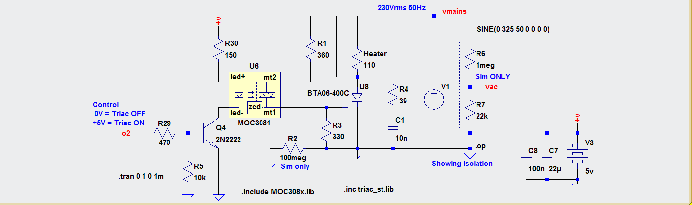

This image shows only the MOC and Triac.
Connect a PIC output pin to the Control pin on the transistor.
Your PIC software would only have to set the PIC pin high to turn on the heater, the MOC3081 would do the ZCD.
[Note: not suitable for PWM usage]

Have been following this thread and would appreciate some futher advice on you burst mode plans.
I'm heating a small section of the greenhouse with a 500w heater from a Pic and relay, but this cold snap resulted in the temp dropping too low so I had to up the heater to 1000w, but under more normal times this can over heat a bit more than needed, so can really see the advantage of using the Burst / Triac method.
However wondered what the life of the triac and heater are like when used in the burst mode - is there any big reduction ?
On the practical side, for a 1000w heater, probably 60% use max. what size heatsink would you suggest.
Also could you say what Wattage and Voltage resistors R1, 3 and 4 need to be.

The life of the element should not be effected, many appliances use this method, including some microwave ovens.
The Triac should last as long as the manufacturers data claims.
Regarding the R1, R3 & R4.
The only voltage that appears across the R1 , R3 series resistors is the forward voltage drop across the triac when its conducting, so I would suggest 0.25W
The same for R4.
I will check the datasheet for the heat sink, to suit a 1kW load.
EDIT:
The Triac dissipates approx 6.5W when running at 100% of the time with a 1kW load.
This Farnell component would be OK for the triac heat sink [ NOTE, the shipping cost compared to the heatsink price!!]
So I would suggest you search for a cheaper option.
The triac comes in two types, insulated and non insulated, so get the heat sink compound/washers etc to suit.
I have assumed that the greenhouse ambient temperature will be around 25C to 30C..??

is there by any chance an alternative replacement for the opto isolator with ZCD as the one in the diagram while listed as stocked in farnel is infact USA held stock and farnell want £15 for delivery!!!! seems steep for a £1 part!

hi Jason,
Look at this from Farnell.
SHARP|PC3SF21YVZBF|OPTOCOUPLER, TRIAC O/P, ZERO CROSS | Farnell United Kingdom

ive had the same problem with the TRIAC being USA stock so ive ordered STMICROELECTRONICS
BTA06-600BRG hopefully thats ok as a replacement :D
