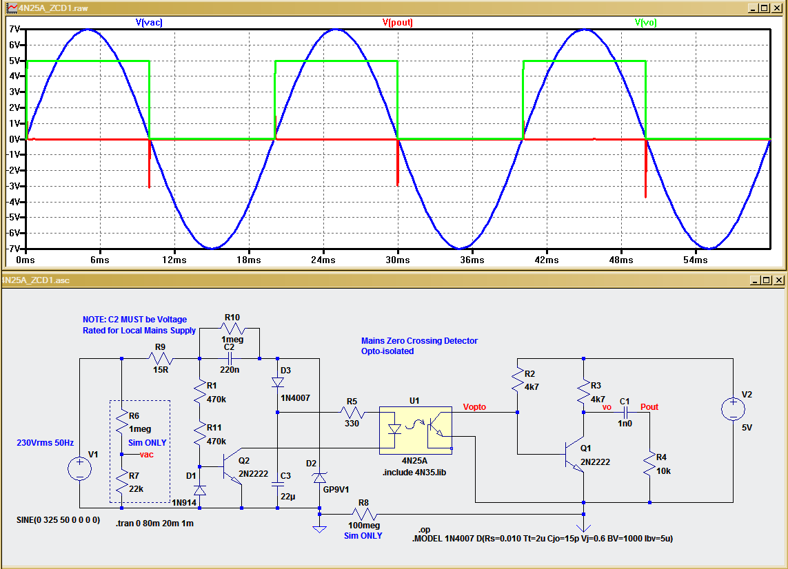

hi G11,
Hope you are feeling better..
A technique that can solve some problems is the use of say a 2A mains rated diode in series with any heating element you may construct from off the shelf elements.
eg: if you get a 500W wound heating element, hair dryer or some of the older style of 500W bowl reflector heaters, by adding a diode you have a 250W heater, use an SCR to control the half voltage to the heater.

This circuit would give you a mains isolated zero crossing detector.
