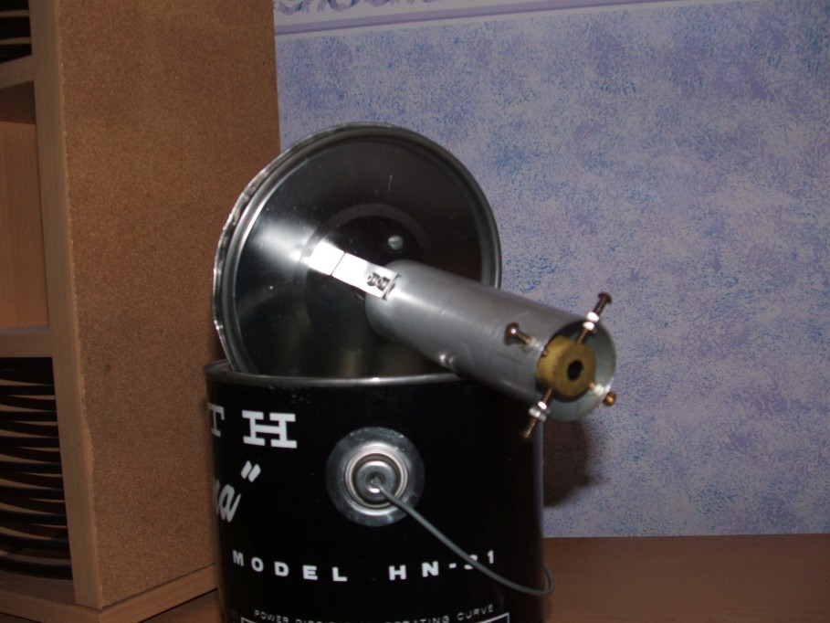

I received this as a Christmas gift from my dad. I have been wanting to get into ham radio for a while, and am working on getting a rig set up.The last thing I need is another iron in the fire, but oh well;)
I am confused on what the 50:eek:hm: resistor should read with an ohm meter. I know, that sounds stupid, but it reads 77.1:eek:hm: on mine. I checked some new resistors with the meter, and it seems okay, so I suspect the 50:eek:hm: resistor could be bad.:confused: I googled this problem and came up with mixed information. Someone said the resistor could have been overheated and be ruined, some say these can't be hurt. Some say that running them in the wrong type of oil can make them read high. Can anyone tell me what is correct?
I am struggling to understand impedance. The can reads 50:eek:hm: impedance. That dosn't simply come from the 50:eek:hm: resistor, does it?
Are there any ham radio gurus out there that can lend some advice on this. Will it be any good to tune my radio the way it is?

Yes it should read 50:eek:hm:

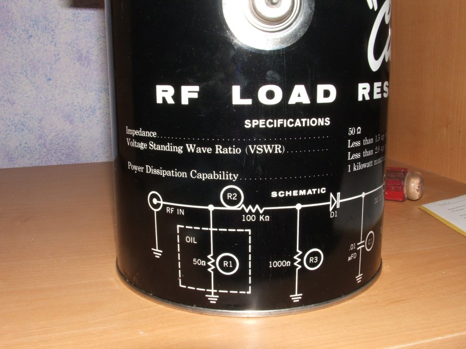

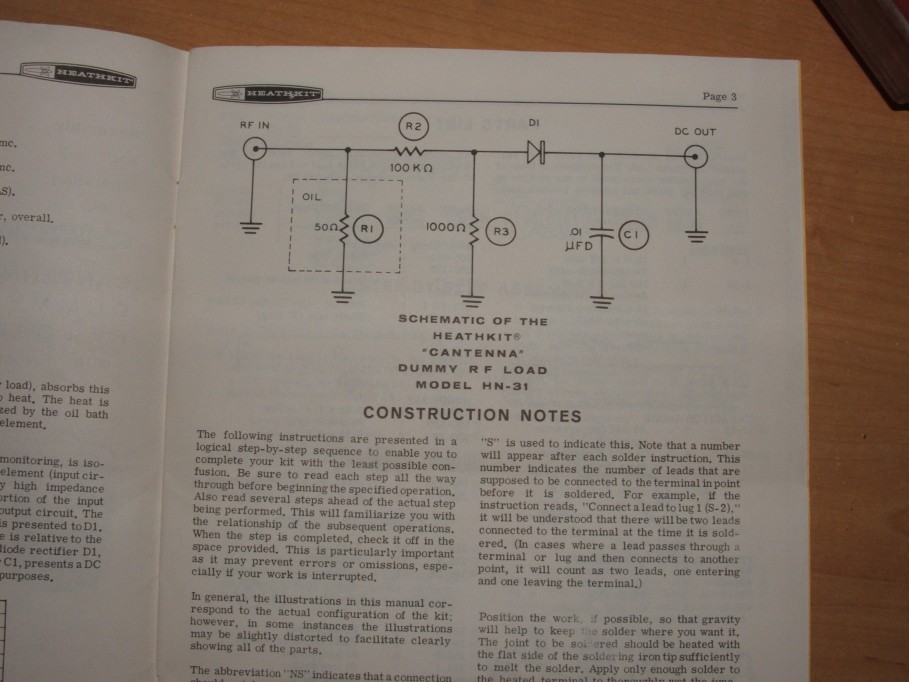

At first I thought it could be a simple attenuator but then after looking at the schematic it's an attenuator and rectifier used to monitor feild strength.
The load should read 50 ohms or very close to it - within 5% would be my thought. I have one and it reads 49 ohms.
A dummy load is quite useful in transmitter work. It allows one to operate the transmitter without radiating much and also it allows the transmitter to work into a known load. I have one and before puttting any transmitter on the air I first run it into the dummy load to see if it behaves as I'd expect.
A bit of info - the Cantenna and other similar "dummy loads" are essentially a 50 ohm resistor that is non-reactive or non-inductive - and that can handle the power delivered to it. The resistor in the Cantenna is immersed in one gallon of oil. This allows it to handle 1 kw of power for quite some time.
There are other dummy loads available that won't handle quite so much power - and those are actually quite useful as many modern transmitters run at 100 watts or less. Yes, you can purchase non-inductive resistors and make your own. Be careful in that the advertized dissapation is at 25 C - and drops a great deal as it warms up. Still, those can be low cost ways to build your own. Keep in mind that the resistor and the assembly must be designed to be non-inductive at the freuqency of use. The cantenna works up to 150 mHz if my memory is correct. There are a number of home-brew designs that work well into UHF regions.

Yes the resistor could be bad,
or..
There is a bad connection somewhere in the can. Maybe the clamps on the ends of the resistor.
or..
Someone has changed the resistor to a 75 ohm type.
In days gone by, 75 ohm was commonly used as the load for a transmitter. Don't forget that a dipole has an impedance of 75 ohm.

Well, I pulled the resistor out. It has 50ohms printed right on the side. (What is that thing made out of anyway? Is it ceramic?) Anyway, its not cracked that I can see, and still reads 77 ohms all by its lonsome self. So I take it its bad.
Can anyone take a guess at how it went bad? Age? Heat?
How about a replacement? Any ideas?
Have you tried to test it under any substantial load? The can says this thing is rated at 1kw, testing the resistance on a meter is completly pointless as the load is so low. Who knows, maybe the 70ohms means the resistor leads are actually dead shorted in the oil bath and the resistance is coming from the burned off resistor material? Testing it under load will show you pretty well what's gonig on with it.

There is no oil in it at the moment, it has had oil in it though. I checked the resistor alone, so the oil bath and connections are pretty much ruled out.
Are you sure your meter is accurate? It ought to read about 50 ohms - power level won't change it.

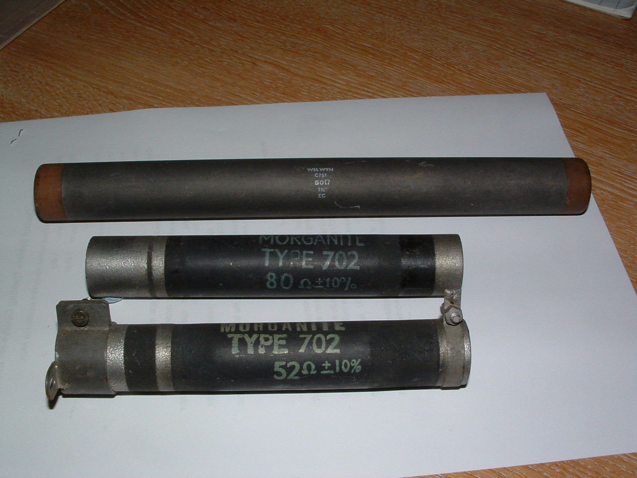

OK have a look at the picture below.
Three resistors removed from RF Power meters many years ago.
The long one is just under 10" in length, it should be 50ohm, and I measure it at 49.3 ohm.
It is constructed from a ceramic cylinder which has a thin coating of carbon to give the resistance. At each end there are copper contacts deposited onto the carbon. The copper is well tarnished after the thing has been languishing an my loft for 30 years or so!
The two smaller ones should be 80 and 52 ohm, but they measure at 60.7 and 37.7 ohm.
How or why they went low in value I do not know, maybe they have absorbed moisture, or they are just cheap junk!.
I am not sure how they are construced, I think they are just carbon cylinders, the inside surface is conductive.
