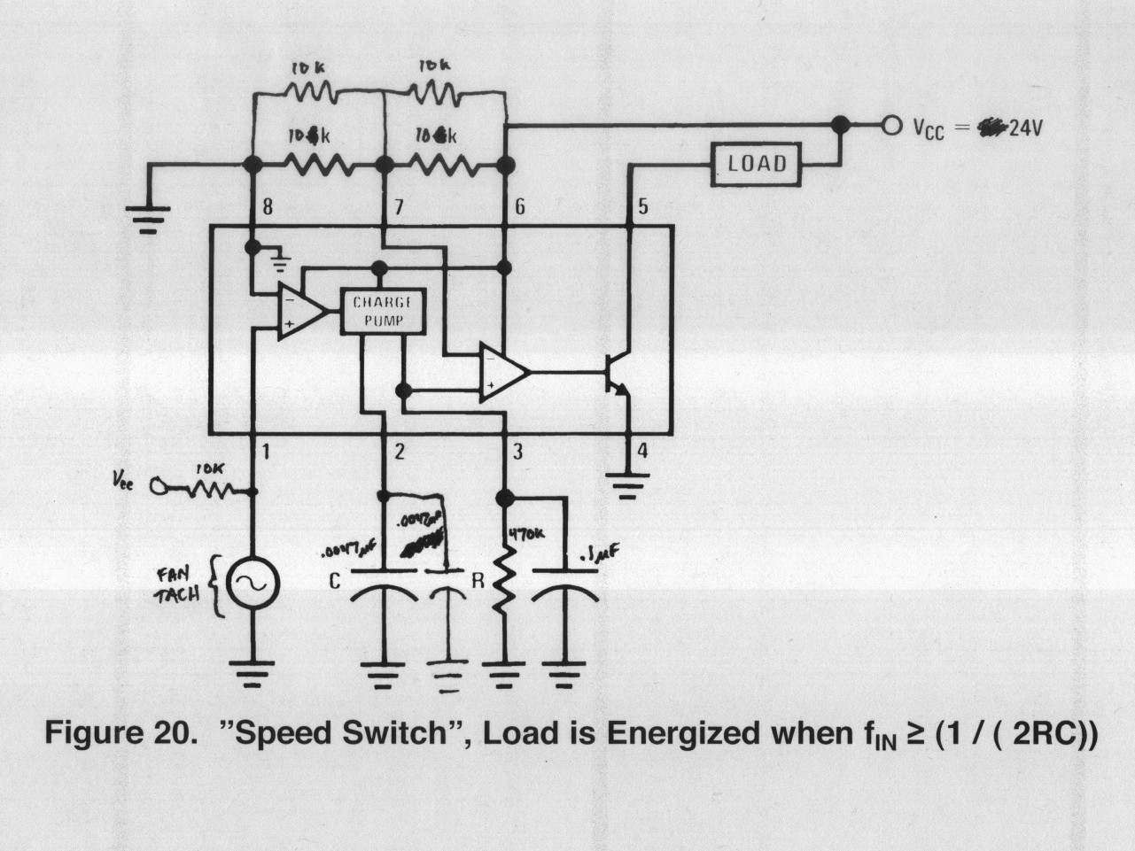

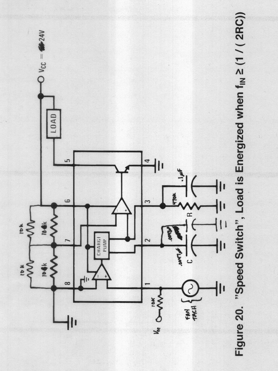

Since I still don't know where to start (e.g. what IC to buy) on Eric's Option B, I went ahead and tried to work out the 'Figure 20' Option A approach on the breadboard this morning. As simple as it seemed, it's not working, i.e. the load isn't energized when the fan is running. (R and C were selected to specify a frequency of 119 Hz, corresponding to a 3570 rpm cutoff speed; normal operation of the fan is 3750 rpm.)
Anyone see any obvious errors? The one thing I did notice is that the internal resistance of the LM2097's input is low enough that it cut my 24 V square wave down to ~12 V. And I'm not sure how much current can be safely dumped into the tach wire on this fan, so rather than going to a smaller pull-up resistor on the fan, I just ran the breadboard at 12 V instead of 24 V. (It still didn't energize the load.)
Can you post the schematic of what you've breadboarded?
From the datasheet:
Two options (LM2907-8, LM2917-8) have one input internally grounded so that an input signal must swing above and below ground and exceed the input thresholds to produce an output.
Does your 24V square wave (and the fan tacho) go negative?
From the datasheet:

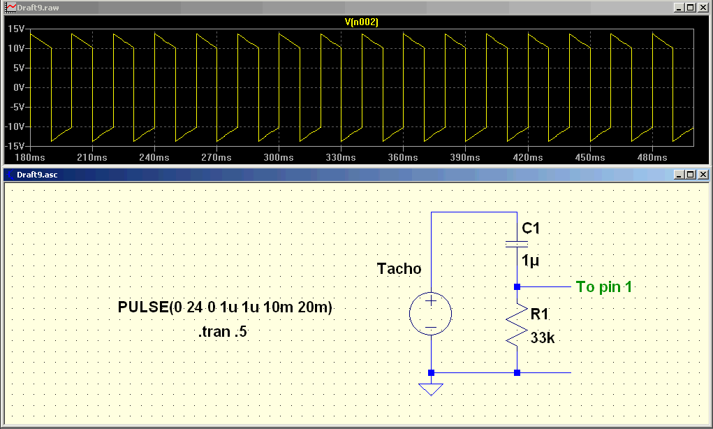

It does not. And sure enough, the IC I bought is an LM2907N-8. Is there a different part number that I should buy to make it work?
(Or I could just shelve this concept entirely and work on the aforementioned "Option B" if you have any suggestions to point me in the right direction on that approach.)
You could try capacitively coupling the tacho/square-wave to the IC like this:-
