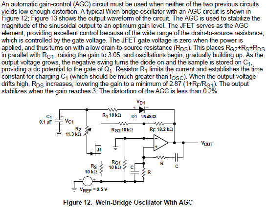

Look in Google for audio compressor-limiter circuit or sine-wave generator level stabilizer circuit. They use a Jfet to control the level.

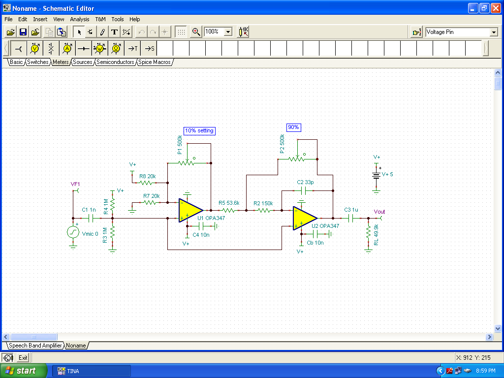

speech band filter w/ digital pots
Found by adding pots I can increase the bandwidth. Plan is to use a digital pot to control bandwidth according to hearing abilities.
use a PIC to control the pots and a MAX4410 80mw stereo headphone driver with shutdown

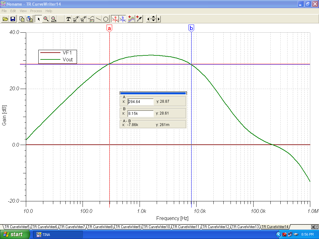

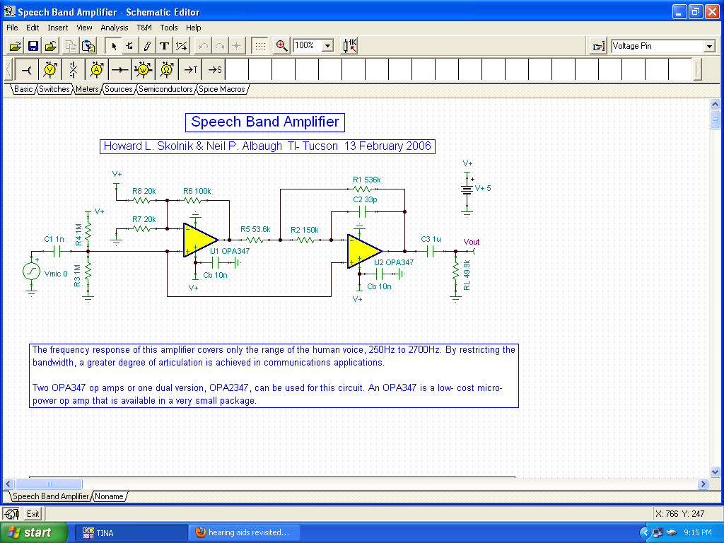

don't really know what I am doing but simulating with TINA for opium results. Audioguru suggested a wider bandwidth the orginal speech filter was 250hz - 2700hz
Using pots set at pictured settings I am able to widen the bandwidth to 294hz-8100hz
tweaking I could maybe get the low end lower?
hopefully going in the right direction?
Maybe someone with more knowledge about this subject like Audioguru can offer suggestions.

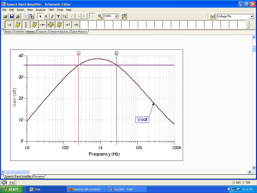

here are screen shots of orginal

We discussed audio filters before but I can't remember.
Most people can hear from 20Hz to 20kHz.
Many male voices and a lot of music are below 100Hz so why remove these frequencies?
Consonants of speech very important for understanding what is being said and are from 8kHz to 15kHz so why remove everything above 2.7kHz?
Most people think that an AM radio with a bandwidth of 100Hz to 3kHz sounds awful and a telephone sounds worse. Do you want your hearing aid to sound like that?
the digital pots R1 and R6 (see post #26 for original) expanded the upper end.(post #25)
Need a lower end filter but got the upper end up to 8khz. Will see about getting a second filter for the lower.
Am starting with the "speech filter" that TINA has as an example.

This phrase is completely wrong: "This circuit passes frequencies in the 300Hz – 3.1kHz range, as present in human speech".
It is only the VOWELS of speech but the very important consonant sounds of S, T, P, Sh, Th and hundreds of other consonants sounds of speech are missing (what did you say?).
Nobody listens to only AEIOU vowels which are not speech. My dogs make those sounds.

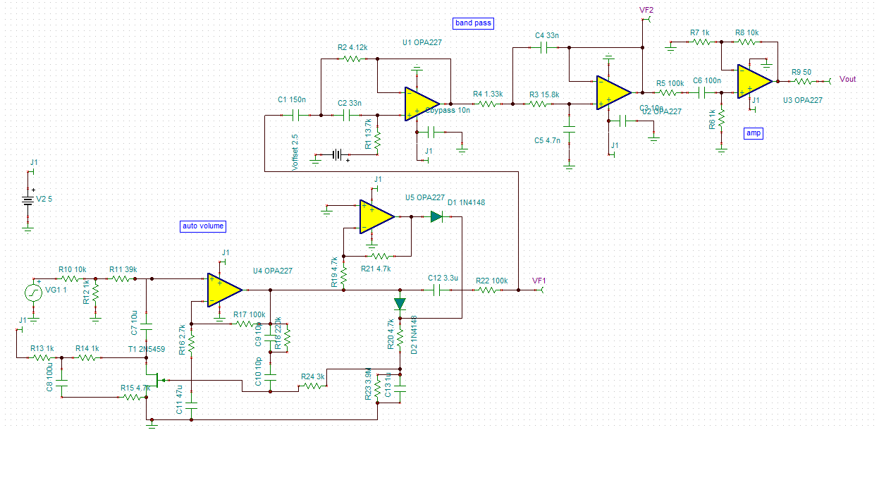

well here is ALL three cascaded
I have no real idea what I am looking at
The noise analysis looks good if thats anything.
subed an OPA227 op am as it has lower noise.
Many of your opamps have their input DC voltages at ground so they are rectifiers if they do anything (most inputs don't do anything when they are at ground when there is no negative supply).
R10 and R12 are an attenuator that throws away 91% of the important input signal (from a microphone that has no power?).
Your Jfet circuit has errors. Its source should not be connected to ground. it should have the 4.7k resistor R15 in series with its source to ground and bypassed by the 100uF capacitor C8 as shown in the Fast Peak Limiter project on Rod Elliot's site.
I made corrections on the peak cutoff section.
changing the RC componets on the bandpass filter to increase width.
Will get back with schematics and results.
The new version of TINA has somewhere a method to playback WAV files to hear actual changes but havn't figured it out yet.
