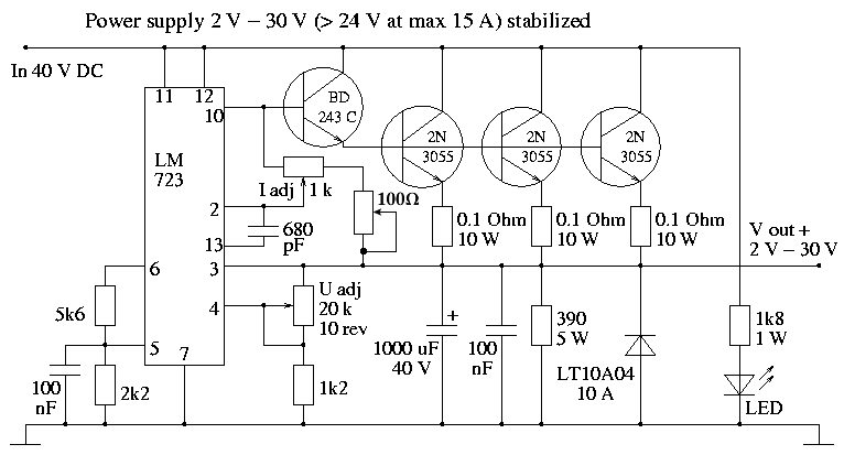

Hi all, in 2009 I got some invaluable help from this forum into building a power supply for anodising aluminium.
It has served me well but last week I had a flat battery on my car and used the power supply to start the car lots of smells of burning voltage regulators! I am going to change the design so I can anodise some larger parts.
Could you please have a look at a schematic I have found as a replacement.Do you think this would work? I need a max of 10A. Is the Led in the circuit just to show power is on?
I would like to add an led to show current limiting is on, how do I do that?
Also do the 2N3055's need to be insulated from the heat sink and does the BD243C need to go on the heat sink?
And lastly the LT10A04, can this be replaced for anything else as I can't seem to find them.
Thanks for your time again
