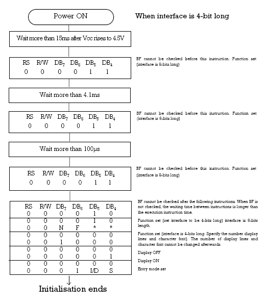

You can't use the busy flag during initialization. See the attached for the process.
Ah that explains that one then.
However even if I check it before sending a command (as below), it still won't work once I take my delays out.

Edit, Wow, I just found a bug in my code. The lines marked in red were WriteNibble(0x30). Shows how flexible the newer displays are.
Edit2, added the print hello world bit.
Hi Angry Badger,
Yep in 4-bit mode. I'm checking for the busy flag before I send the first nibble, but not before the second.
Is it supposed to be checked after the last nibble or it doesn't matter?

Thanks Pommie was wondering how to write a whole string instead of letter by letter.
I'm glad I helped you find a bug in your code ;)
I don't suppose it really matters if you check before or after a write so long as you don't check in between nybbles. I only asked about the display brand because as well as my own experiences I have seen on other threads elsewhere that Powertip timings can be a bit flaky compared to some other types. So long as you stick to the data sheet timings you'll be fine.
Ah ok no worries.
Yeh I don't have the data sheet for my exact display, I'm just using a generic HD44780 datasheet.
I might just stick to timed delays I think, the busy flag seems too much trouble, for this display anyway.
