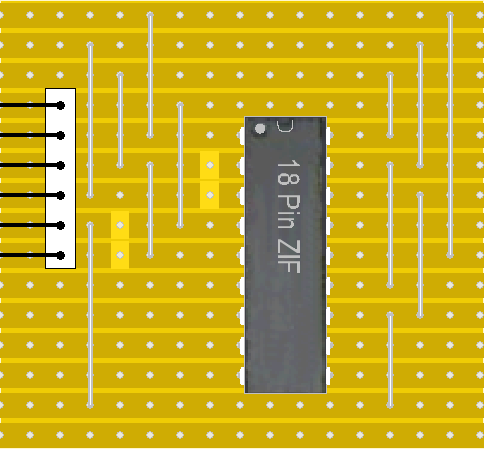

I've attached veroboard layouts for a simple programmer adaptor for the PICKit2/3 - build it, and try reprogramming the 628a's using that rather than ICSP.
Hi Nigel,
I should have said, I'm using a board I got from ebay that has 3 ZIF sockets on it, designed for the Pickit.
Though I have had some success with it already, there are six jumpers on it that it says to close all for PICs and remove all for other devices. Other than that information there are no instructions for the board, but as I said I have had success once I can only assume that the jumpers are ok.
I will still build your board if you think it neccessary. Is there any advice on how NOT to make unusable 628s?
