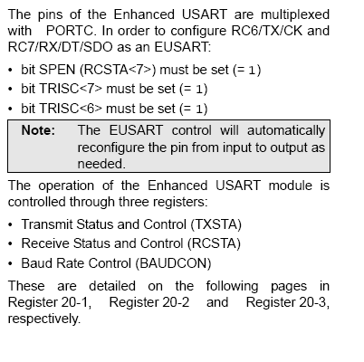

Nope, both must be set to input. A quick check of the data sheet can often answer these questions.
rs232-png.59032
Wow, thanks for clearing that up. That would have definitely caused some major headaches. Thanks so much for the help guys! I am going to begin troubleshooting. I plan to try to directly connect the TX pin of transmitting microcontroller to the RX pin of the other microcontroller to see if I can bypass having to go through XBEE, so I can eliminate any variables that would cause even more issues.

I changed the pin configurations on both microcontrollers to the following
TRISC = 0xC0;
RCSTAbits.SPEN=1;
