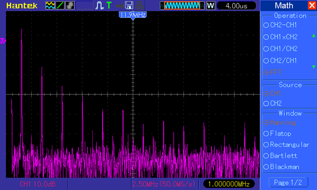

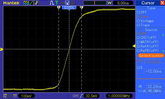

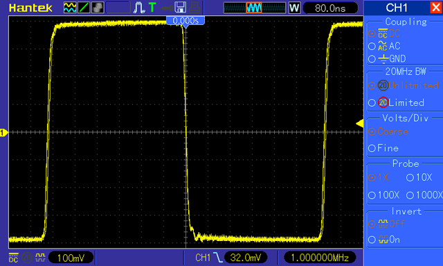

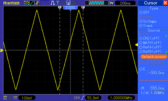

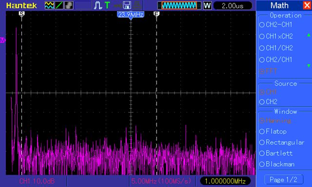

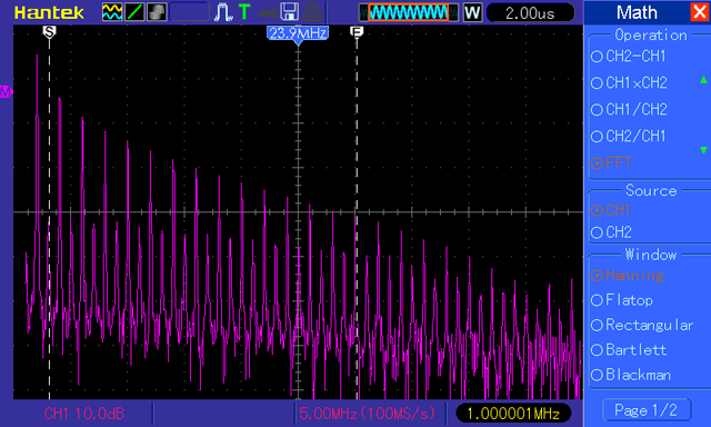

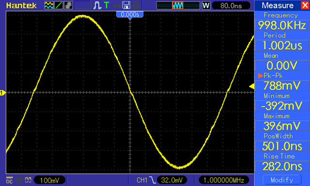

Mr. Al, as for the scope model, see my first post, The scope is only about 6 mo. old and I paid around $300, so I would probably want $225. Well, I got my new function Gen and it is pretty nice. I went ahead and captured some wave forms. I will post them below. All waveforms measured into 50 ohm.
View attachment 97085 1MHz Sine wave
View attachment 97086 FFT of sine wave
View attachment 97087 1MHz Square wave
View attachment 97089 FFT of Square wave
View attachment 97090 Risetime of Square wave
View attachment 97091 Triangle wave
View attachment 97092 FFT of Triangle

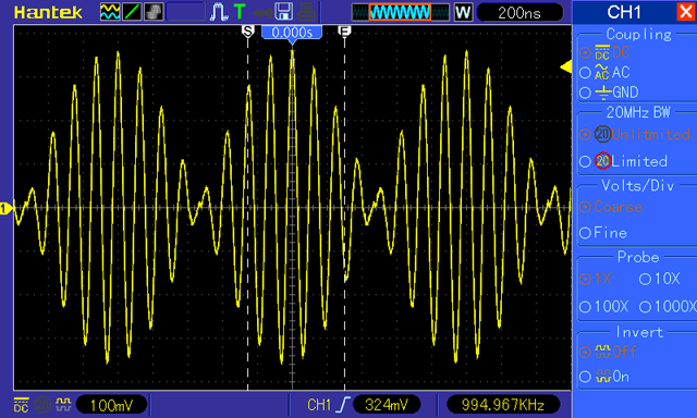

View attachment 97093 AM signal preset in function Gen
Let me know if there are any other test you would like me to perform. Have a nice day :)
P.S I did see a small amount of fuzziness which I could filter out using Averaging on the scope. There seem to also be some jitter.
Thanks Mike. At least i can see what i am dealing with from that.
I guess the smoothness is a little choppy because of the ADC they use. I guess they are all like that?
