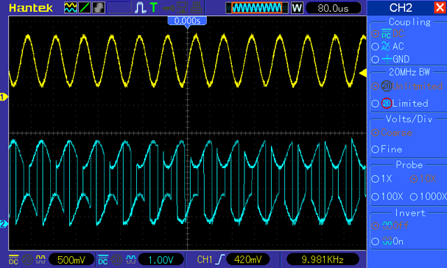

I have a Hantek MSO5102 100MHz scope. For the money it is pretty good scope. The manual is somewhat crappy so you have to figure out things by trial. The logic analyzer has been tricky for me to figure out the trigger functions, for example trigger on a pattern, but I am sure I just have not figured it out yet. Looks like they tried copying a tek scope in looks and function. For the probes they are adequate. I made a post on ETO some time ago on this scope, I will see if I can find it, and post the link.
I've heard mixed reviews. Most are good, but they've had a few bad batches with the cutouts for the front panel that weren't centered correctly and the plastic used for the housing was cheap. I bought a Rigol instead.

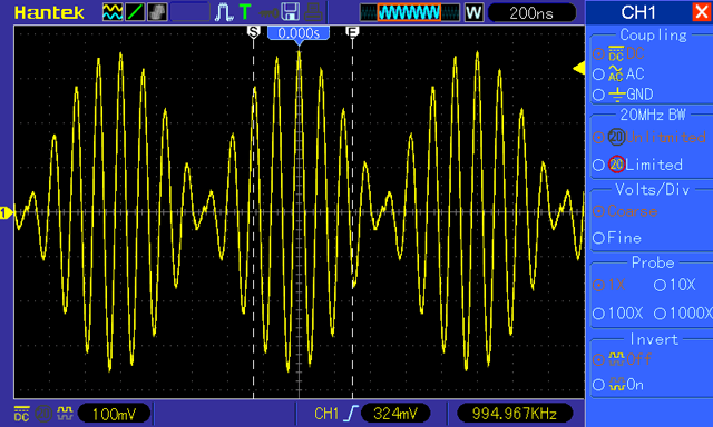

Here is a scope screen shot. I been working on a IQ modulator using a Cypress PSoC. Here is a simple AM signal. Awhile back I looked at the BW using a sig gen, and it does go past 100 MHz but cant remember where the 3 dB point is. What I discovered is that I would really prefer a 4 channel scope, I may be upgrading some time at a later date.

What kind of signal are you feeding into the top yellow channel? Was that a clean sine wave? I ask because it looks a little bit choppy and i wonder if that is because of the 8 bit vertical sampling resolution.
DerStrom:
Thanks, i'll have to check those out too next. I wonder if the prices are comparable.
The top waveform is generated by a DAC on my PSoC device. I was just using it for testing. Saved me from having to grab a function Gen :)

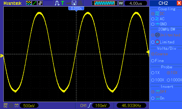

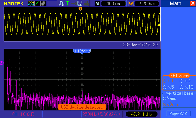

Here is a screenshot of a cheap function gen output. The function gen is homemade from a XR8038 function gen IC. I also included a split screen view showing the sinewave on top and FFT on bottom. Hope that helps. I wonder what is causing that ugly blip on the negative peak of the waveform.
View attachment 96924 View attachment 96925
Thanks much for posting that, it's interesting to see an actual screen shot of the scope output.
For the 8038 chip, offset adjustment unless there is a non symmetrical upper and lower transistor set in the chip. The lower set controls the negative half cycle wave shape, the upper set the positive half cycle.
For the scope, wow, that looks pretty hairy :)
Is that noise we are seeing with the sine wave? What frequency is the sine wave itself, is that 47kHz? What is the peak amplitude of that sine wave?

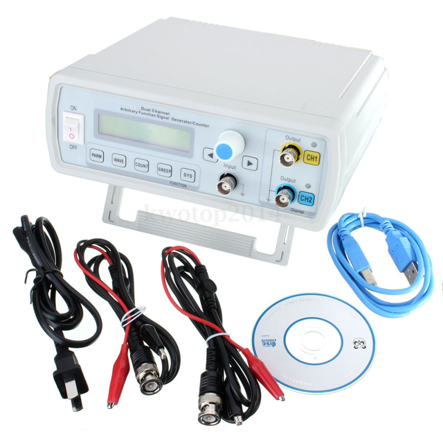

Mr.Al, It is hard for me to show an example of a good sinewave since all I have is a very old 8038 home made generator. But you have peaked my interest, and it just so happens that I had placed an order for a function gen from ebay prior to your post and it should arrive on Tuesday. I have been helping my son the starving musician with some audio projects so I ordered a dual channel function gen. It probably is using the DDS AD9851 chip.functiongen.png
So when I get the generator I will take some screenshots. I also ordered a AD9833, and the AD9851 breakout boards to play with. My son wants a few devices to use with his rack mount audio synth gear. I want to make him a audio generator, a modulator etc. So this will be useful for me to check my scope as well. Will update this post next week if your still interested.

That function gen looks like the one a friend of mine has. The software isnt very good, but the function gen itself works pretty nice. Price was about 75 dollars USD. Top end is 20MHz i think, which is good for most things, but bottom end is much less than 1Hz, like 0.01Hz or something so it has a really good range.

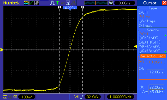

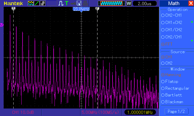

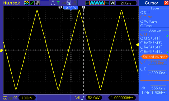

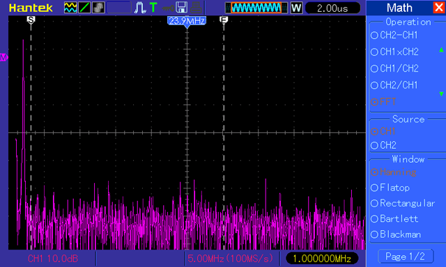

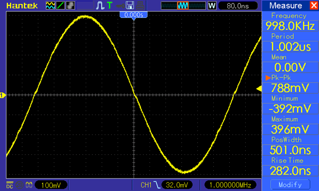

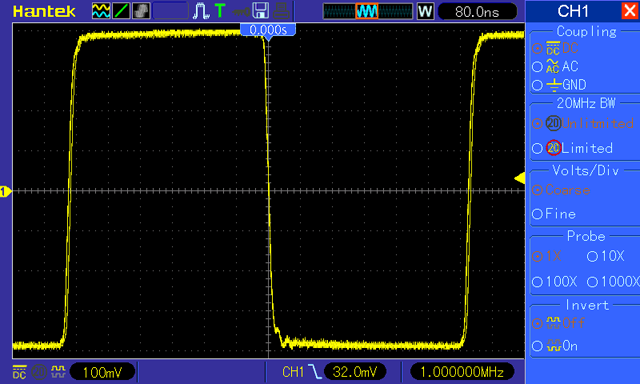

Mr. Al, as for the scope model, see my first post, The scope is only about 6 mo. old and I paid around $300, so I would probably want $225. Well, I got my new function Gen and it is pretty nice. I went ahead and captured some wave forms. I will post them below. All waveforms measured into 50 ohm.
pic_29_10.png 1MHz Sine wave
pic_29_10a.png FFT of sine wave
pic_29_12.png 1MHz Square wave
pic_29_14.png FFT of Square wave
pic_29_15.png Risetime of Square wave
pic_29_16.png Triangle wave
pic_29_17.png FFT of Triangle
pic_29_20.png AM signal preset in function Gen
Let me know if there are any other test you would like me to perform. Have a nice day :)
P.S I did see a small amount of fuzziness which I could filter out using Averaging on the scope. There seem to also be some jitter.
