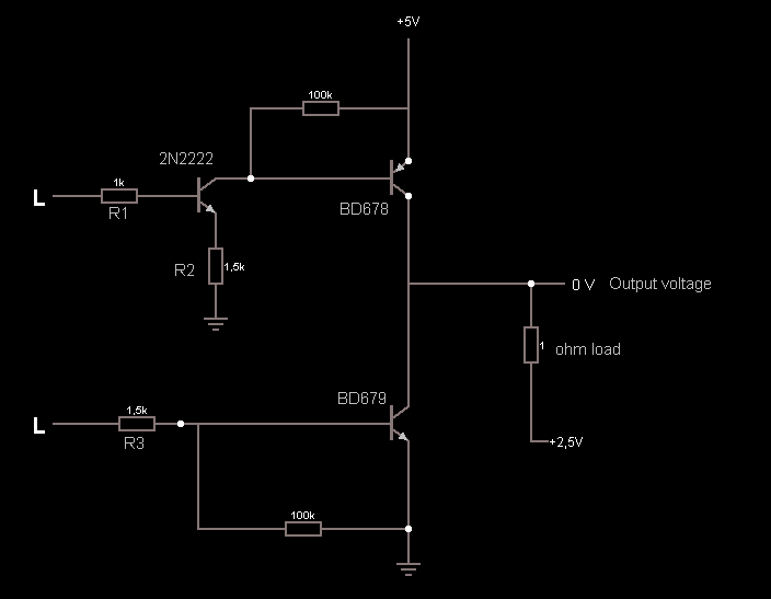

I'm designing an h-bridge using BD679 / 678 darlington transistors and 2N2222 or BC337. I know there are lots of available designs on the net, but i didn't find one that uses those parts (I'm having about 30 of'em, then those are the ones that i'll use and I would like to correct my design mistake). The schematic is attached it was drawn and simulated in falstad.com's simulator.
The circuit will be run on 5V for logic and 12 to 24 volts to power the load. According to the simulator, the circuit works fine at 5V, but when I raise the source voltage to 12V or so, I get huge voltage drop on the output, the circuit is acting as a voltage divider. I would appreciate that someone points me to the mistake. Could it be run at a range from 12 to 24 or should I add potentiometers to tune it for each voltage.

Yes, maybe it's so stupid as problem, but I'm not good enough in electronics to avoid such a mistake.
PS: The gain of the BD679 is 750 and it's intended to be used for currents up to 2 amps (4A peak).

Perhaps the NPN darlington can also be driven using another pnp device
At a gain of 600 odd, 1.5K should be able to drive the drlingtons.the load of 1 ohms appears too much.
When you attach the load to 12 volts the top transistor can only go to 5 volts.
perhaps that would be only when both BD678%679 are wired in a mode with emitters towards Centre. In fact you cant call it a H bridge as there is no bridge there. it is like an amplifier. instead of driving both by one driver transistor, you are trying to drive the NPN directly.

As the logic inputs will be connected to optocouplers, then I assumed it wasn't necessary to use an other PNP transistor. And the load of 1 ohm was set only to get an output from the simulator (same reason why I added a 2.5V source)
Why would the top transistor provide only 5V? How should it be driven to output full voltage?

we can call it half bridge. perhaps the motor can be connected in between the power transistors. collector to collector.
Thanks sarma, by returning to your first message, I understand what you meant, the drop was due to the low resistance load it was causing nearly a full short circuit, by using a higher value the voltage goes back to normal.
Then I'll assume the circuit is correct, remains only some tweaks of the resistor values and it will be fine.
