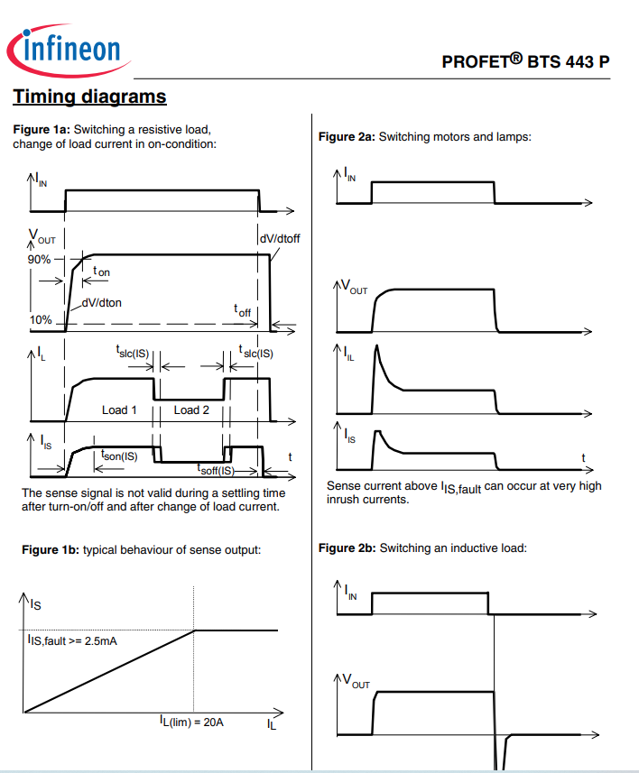

Not sure if this will be helpful.
On the first page under "applications" It states "no PWM with inductive loads" As a DC motor is both resistive and inductive, that may be part of the problem.
On page 9 it shows/illustrates the problem internally when driving an inductive load.
I wasn't trying to use the BTS 443 P to switch the motor with PWM. That was done by the MOSFETs. The voltage would have been clamped to near the supply rails.
I was getting shoot-through when the motor was replaced with a 1 kOhm resistor. It seemed to be the rapid drop in output voltage which turned on the BTS 443 P

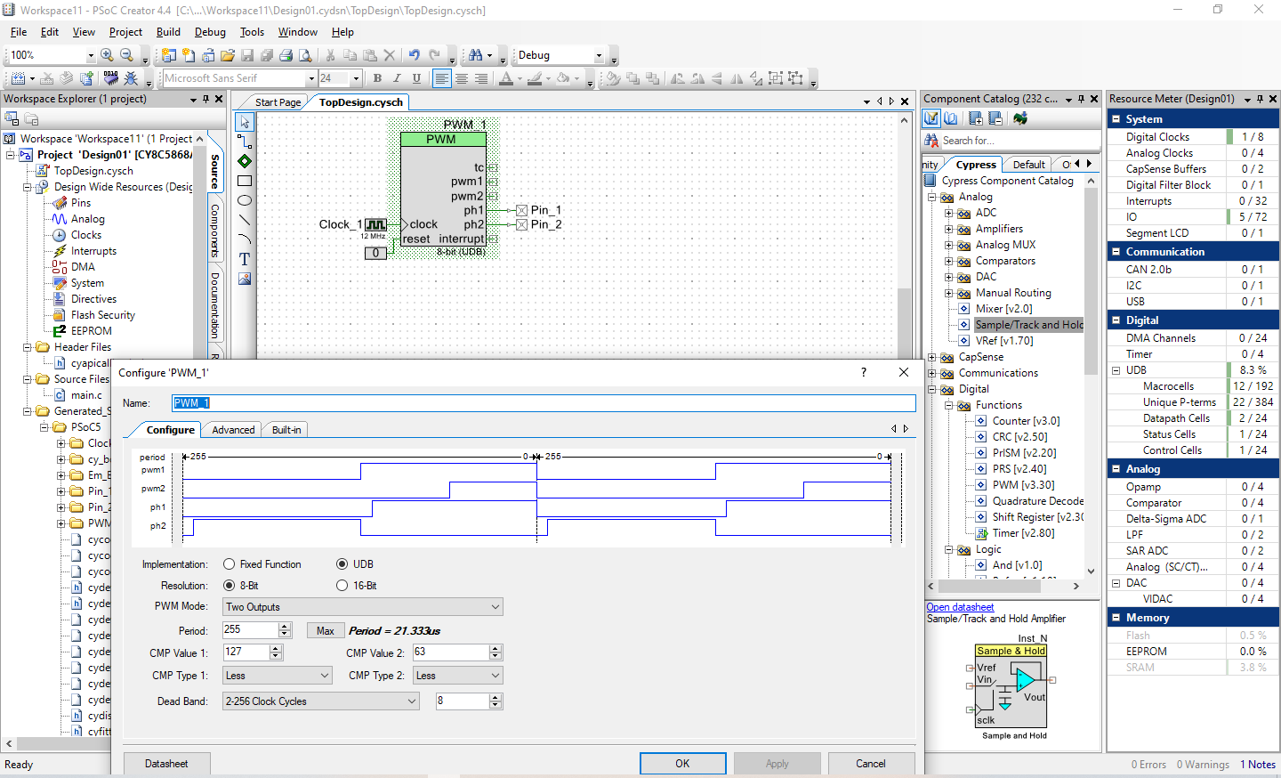

Dead time/band in PWM implementation, where MOSFET drive does not overlap
for a small time, see PH1 and PH2 in PWM setup window below. This chip is a SOC,
many more resources available onchip for V and I measurement, general logic thru
high level functions. See right hand window for resources used/left.....
Regards, Dana.

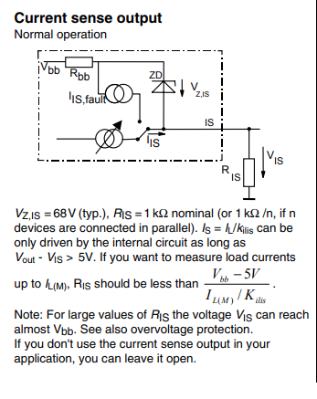

Do you have a 1K to ground / negative on the IS pin? No idea if that will have any effect, but it gives another part of the circuit a ground reference.
I've got a 1.3 k resistor to ground. I don't think that the BTS443 can use that connection as a ground reference because it would lead to a false current reading.
