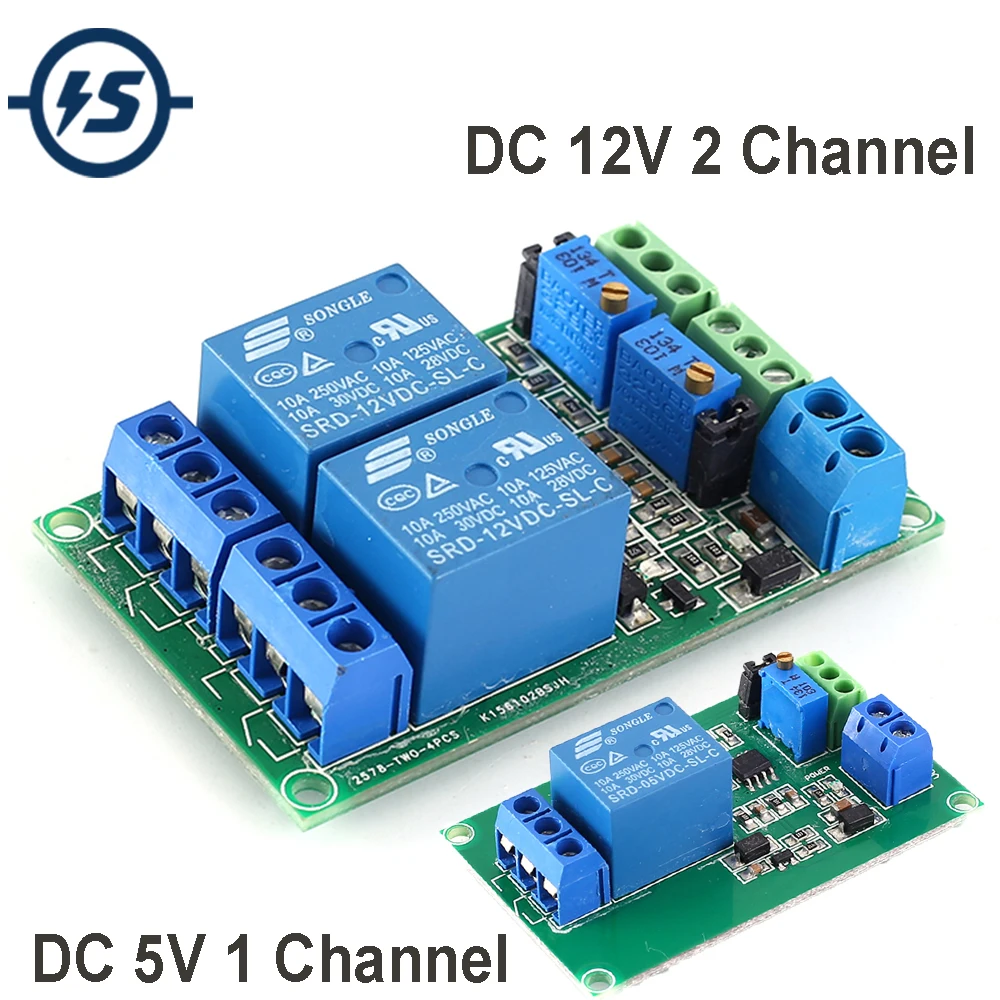

searching I found an other device which might be perfect, from the same place selling the comparator with hysteresis.
2 of those with one for high and one for low should do the trick.
Thanks mbarazeen, you got me going in the right direction.

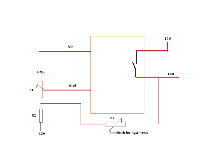

You are welcome, mean time you can still add hysteresis by using the feedback and adjust it as required, i have attached a quick sketch on how you can achieve it.
