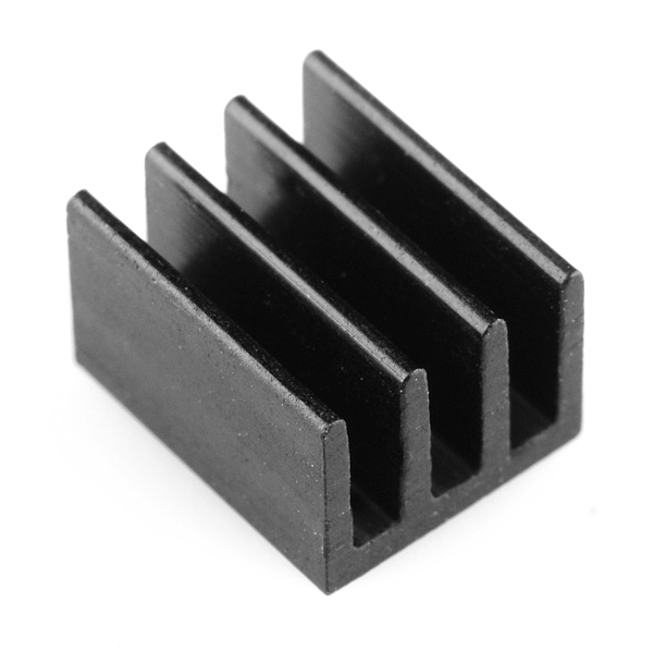

What sort of heatsinks are you using?, and are the chips getting very hot before they die?.
I'm using this heatsinks with thermal paste, it covers the whole component. I don't think the over heating is the problem...
Not sure how hot it gets, it is bigger. Runned for over 20 minutes...
Lick your finger, and touch the heatsink - BRIEFLY! - if it's too hot you'll hear a sizzling sound as the saliva boils away. Don't do it without licking (or wetting) your finger, as the thermal inertia of your skin/flesh means it will burn you before you have time to feel it.

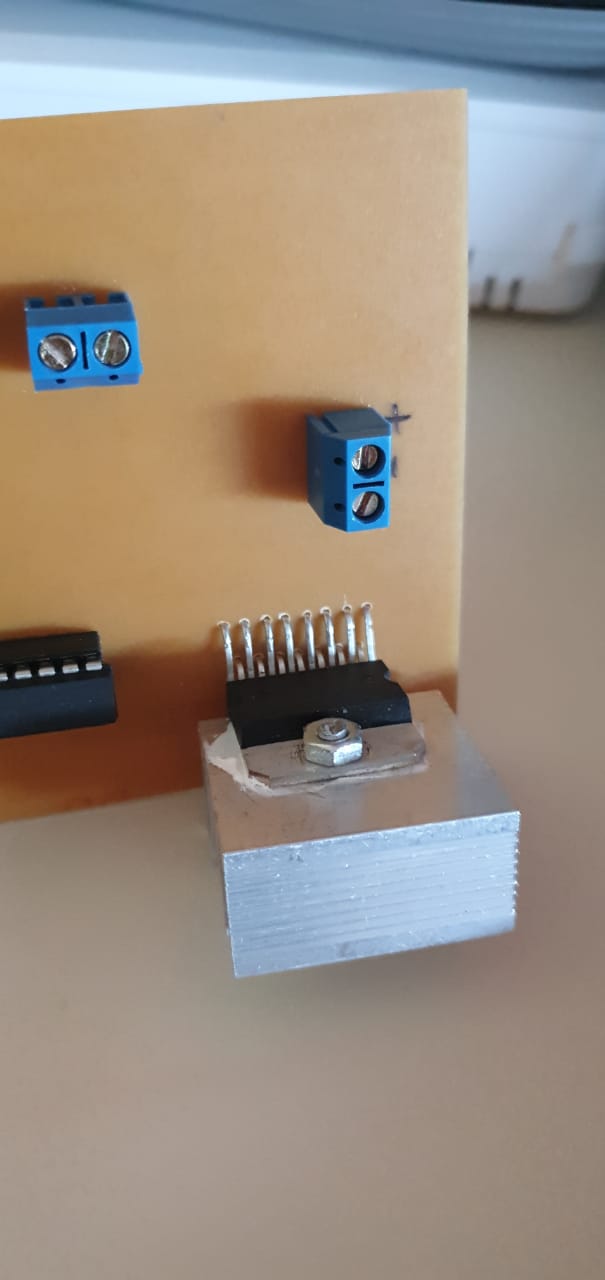

- I Changed the heat sink that I had to a large one.
The Rs resistors is very importante step, because they will help divide the current more equally to the both bridge that are in parallel, just to make sure that one bridge is not receiving more current that can really handle. I think all the changes above made the project work.
